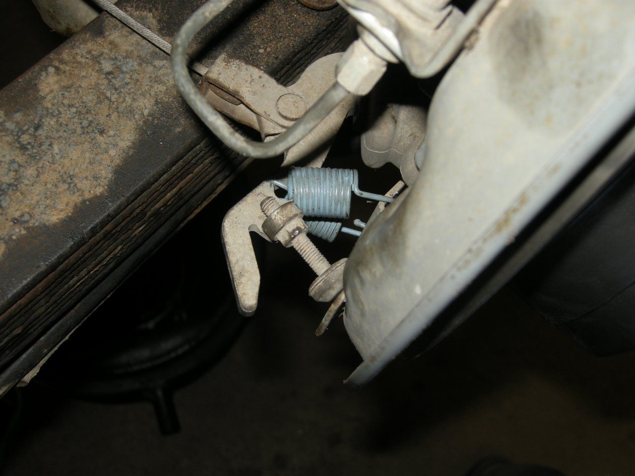

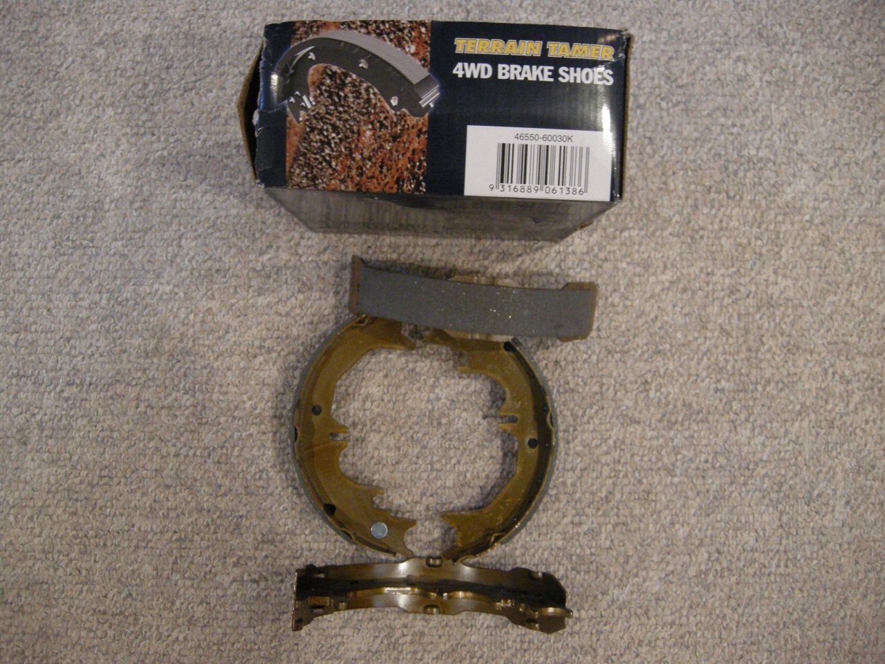

I had my rear brakes changed out. When removing the right side rear brake, a couple of small bits fell out; not something to inspire confidence. One must have reliable brakes, and i didn't want what went in there, so i got all new bits. I got them from 4Wheel Auto in Edmonton. With the non-original brakes (because i wanted discs in the rear), i had to find out what brakes i should get. On some other thread on Mud, somebody said that the rear discs are the same as the ones on 4Runners; this was confirmed by my mechanic pal in Ontario, who had just done the brakes on a 4Runner, so good info there. The pictures i've posted are there for parts numbers; most of the replacement components i got are from Terrain Tamer (Australia). Two significant differences are the quality: the tapped holes into which one twists in two bolts to remove the disc/drum combo stripped in two of the holes (of the four in both sets), so this was a cheaper quality unit that was initially installed in my car; as well (although i cannot assume the origin of the problem) two small items fell out of the drum on the left side when removed. On top of that, the right side drum was not round on the inside, and that says the drums had been machined, but not enough to make the inside round. Stupid. I didn't want anything to do with that (one must have brakes) so, even though i cannot really afford it at the moment, i got new parts. That includes callipers; the ones i got were Toyota items, rebuilt by Cardone.
Another indication of the quality of the items initially installed is that the drum/disc combo did not have the hole in them that allows one to adjust the drum brakes, that little access that allows one to twist the star wheel. Stupid. Again. I was surprised: i just went through the entire build thread, and it looked like the rear brakes were all new parts, although the pictures were not taken such that the parts numbers on the packaging could be discerned; as well, i did not see the disc/drum bits in the build thread, so it is easy to assume that leftovers were installed.

More replacement rear brake parts numbers; that covers all the brake parts numbers i have for this installation.

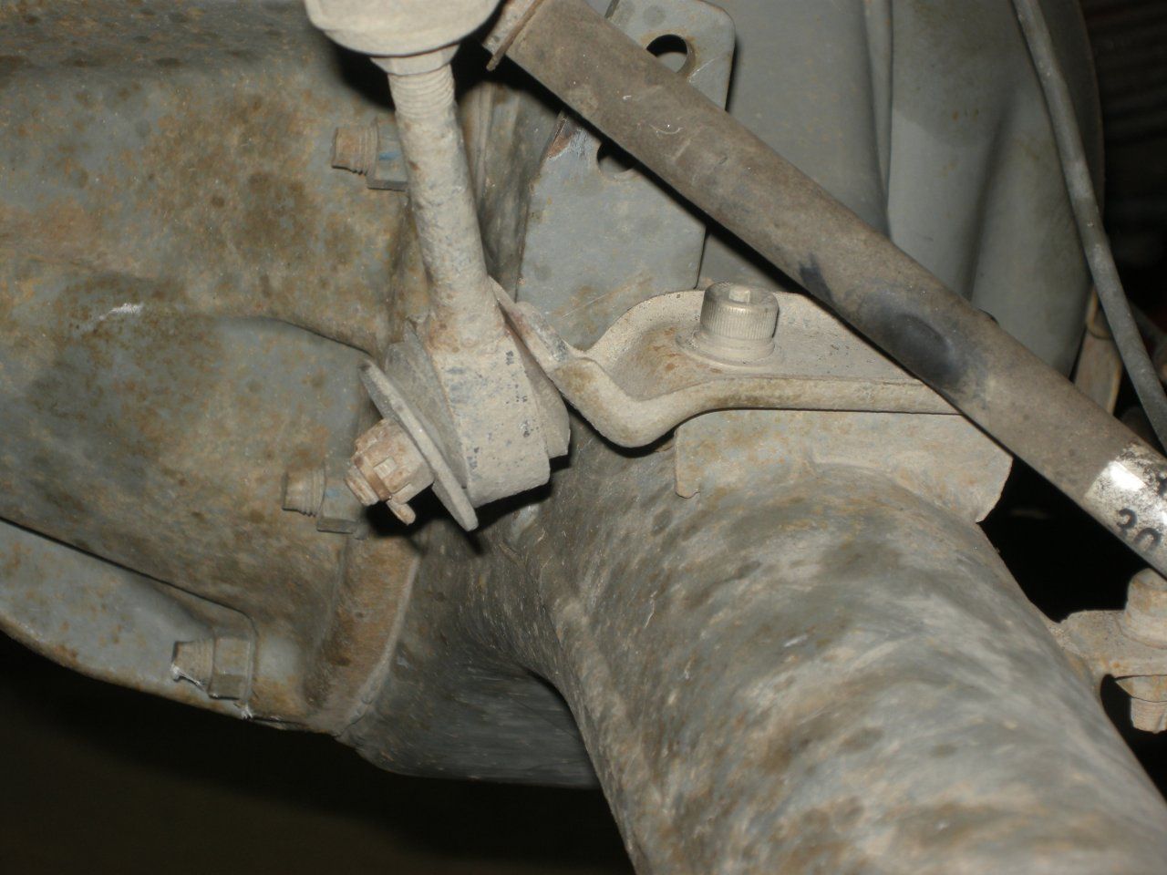

More pictures: the first one shows the bracket that holds the brake proportioning valve to the rear axle, and its deformity. I believe it hits the winch driveshaft (the factory mechanical winch that i had modified to be led out the rear, and the valve's top bolt hits that shaft when the axle articulates). It got hammered back straight, but currently it is back to its bent-down position; a detail i will have to sort out.

The following shot is there to show one pair of the new springs next to the existing springs (blue is new). And the last shot is there to show the access hole for the star wheel which, as previously mentioned, was not there on the old drums. Stupid: how in hell does one adjust the parking brakes then? I assumed all-new brakes were installed during the initial build (stupid me), so nice to get that fixed. Harrrumphhh...
In the first picture are the new return springs; on the old set-up, their equivalents were not there. Rather bothersome. The last picture shows two of the old springs. I can only guess why my rear brakes were in such poor condition.
If you are at 3.2 ton constantly, dissconnect that silly valve and leave it in the 100% position, your braking should improve.
Nasty tap into the axle! How hard would it have been to weld a few nuts in place?
