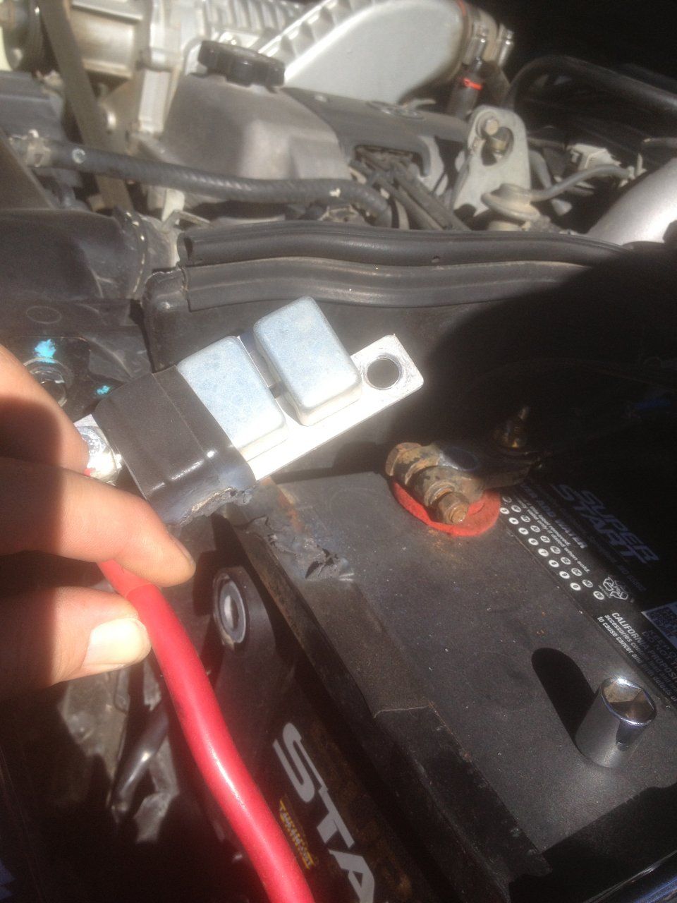

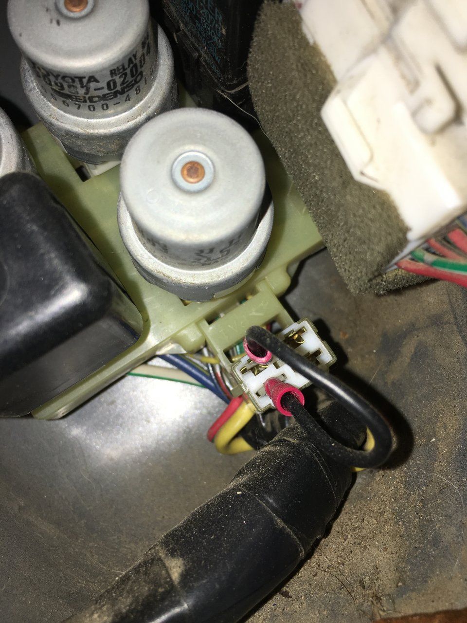

My battle with the cutoffs at high temps is not over but at least on hold now with a temp "solution" of a jumper in the Circuit Opening Relay found in the drivers side kick panel. Think ill be looking into the dizzy and the MAF signals soon to identify the culprit. For now its been great to be able to reliably drive again without concern of when and how long id be sitting on the road today. Somewhere in there I nearly burnt the rig down so frustrated on side of road I ran 12v straight to pump under carpet just to get home. Worked great till it grounded out and smoked the wire and everything it was touching for 12' :/ oops
But my battle with the evil spirtit that is electricity in general continues :D

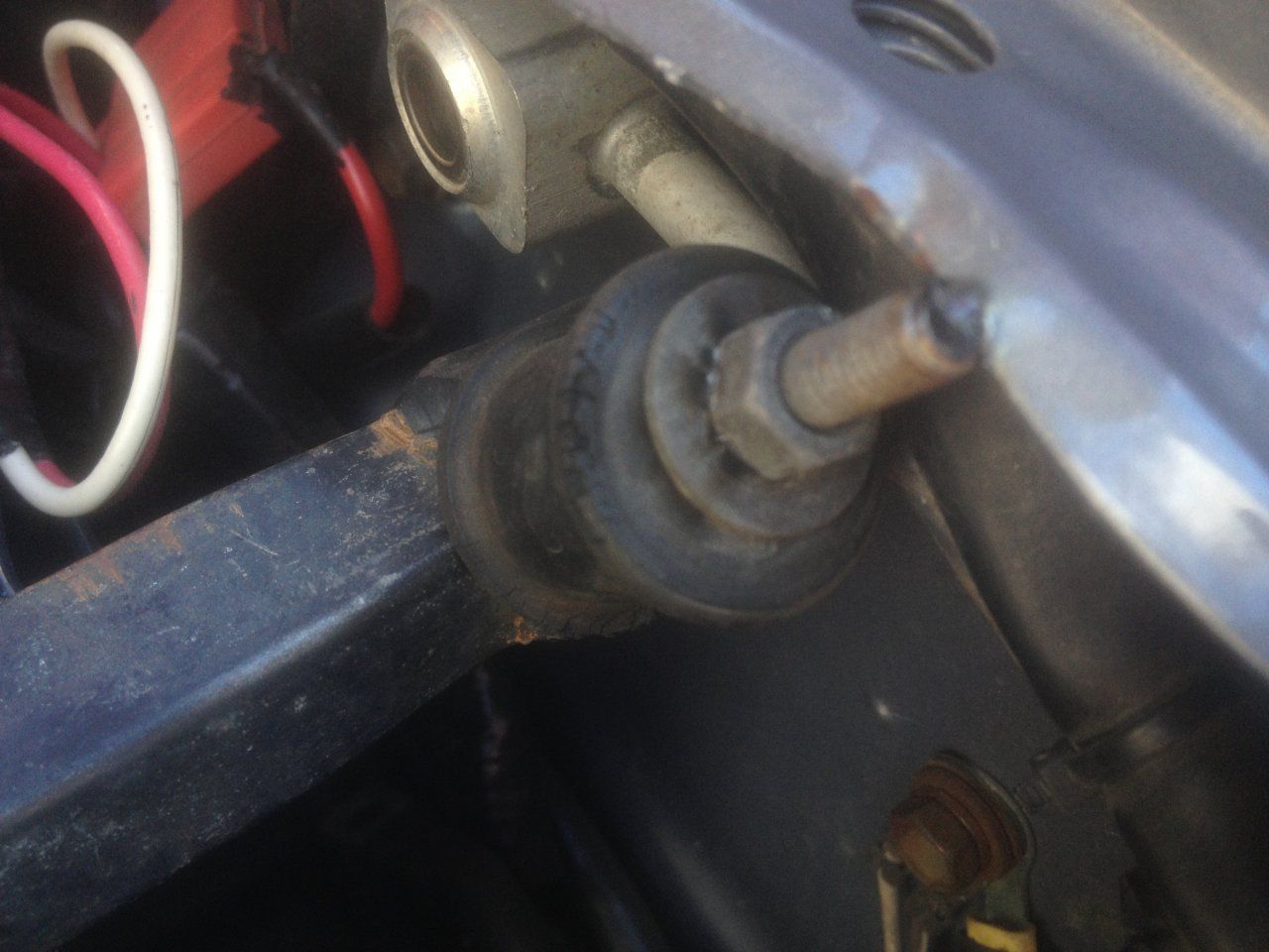

Was exploring backroads of NC with LOTS of gravel road time and at some point I lost the inboard battery tie down J hook. When the battery shifted toward fenderit raised the hold down bar and perfectly connected the negative side to the inner fender and arc'd to the winch power line. Oops I guess I let the smoke outta this one; Dead winch now but just glad it wasnt any worse as it welded the tie down to the inner fender.

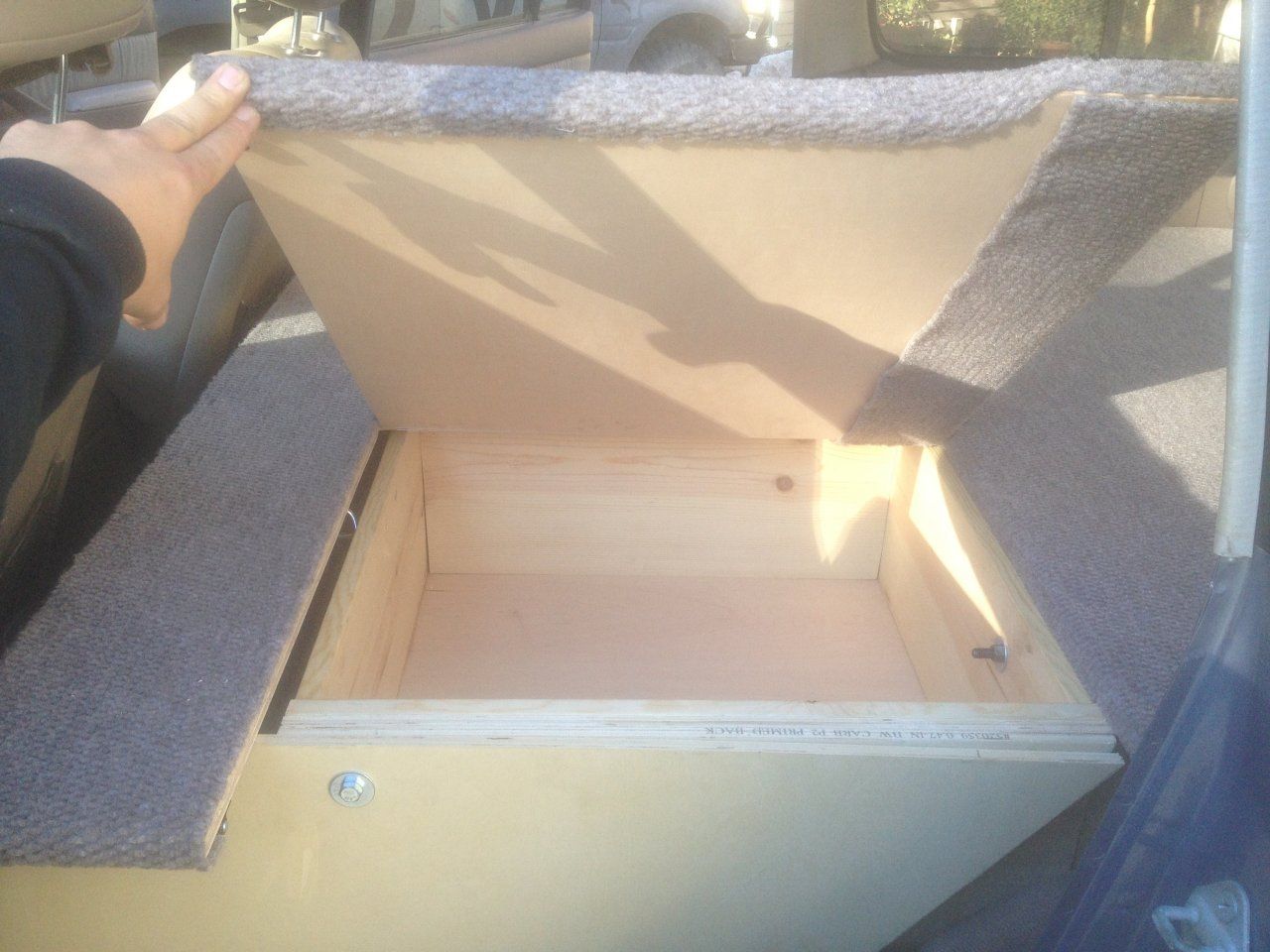

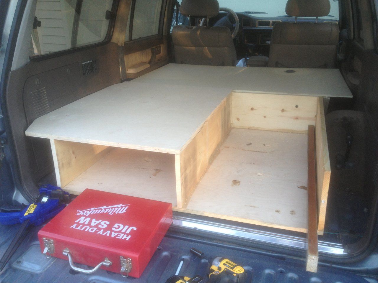

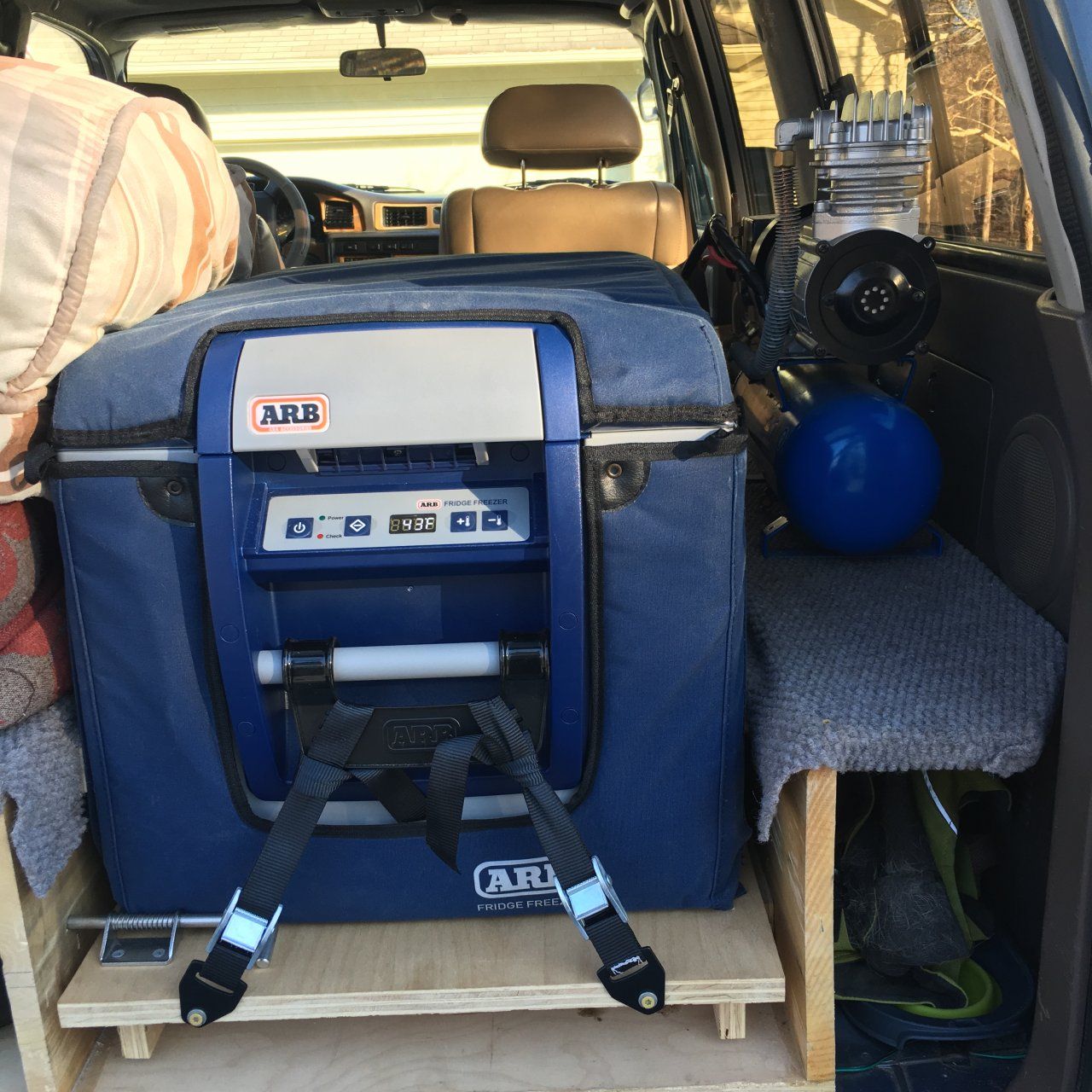

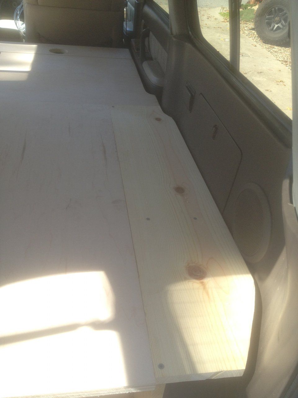

Built a set of drawers on a whim one weekend; could definitely be more thought out and better executed but for a design/build as you go i was pleased with the outcome. Not only do i have organized storage it also made the 80 ride waaaaaay better. win/win. Two rear cubbies; one for fridge and one for 2 front runner wolf Pack boxes. Two front cubbies at second row for clothes and kitchen. And the forward space in footwell houses a front runner 14g water tank. Am adding tie downs for two more wolf pack boxes on top of drawers.

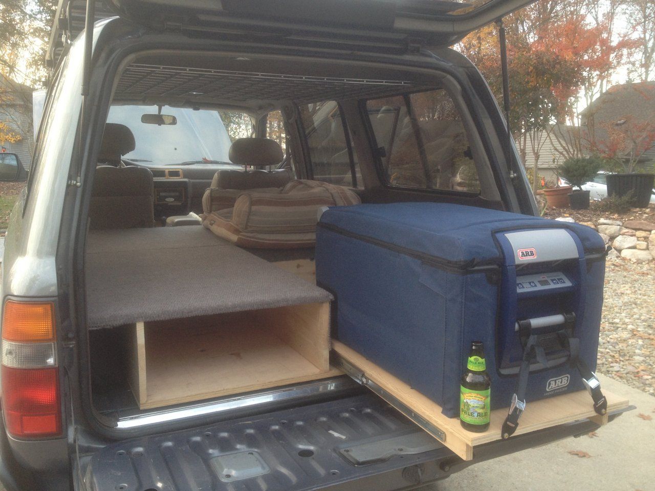

Part of the build was constructed around the purchase of a fridge which i didnt have in hand yet. Tight tolerences but thankfully it fit when it arrived. Even has room for a puma left beside it I voted for the 60qt arb because of the lower height despite my thoughts that footprint should be biggest concern in a limited space . Now that I preserved my view out I plan to add a ctr tire carrier nullifying the process.
I can tell the latch i added yesterday to secure the slide fully closed will not stand up to off-road use and will need re addressing

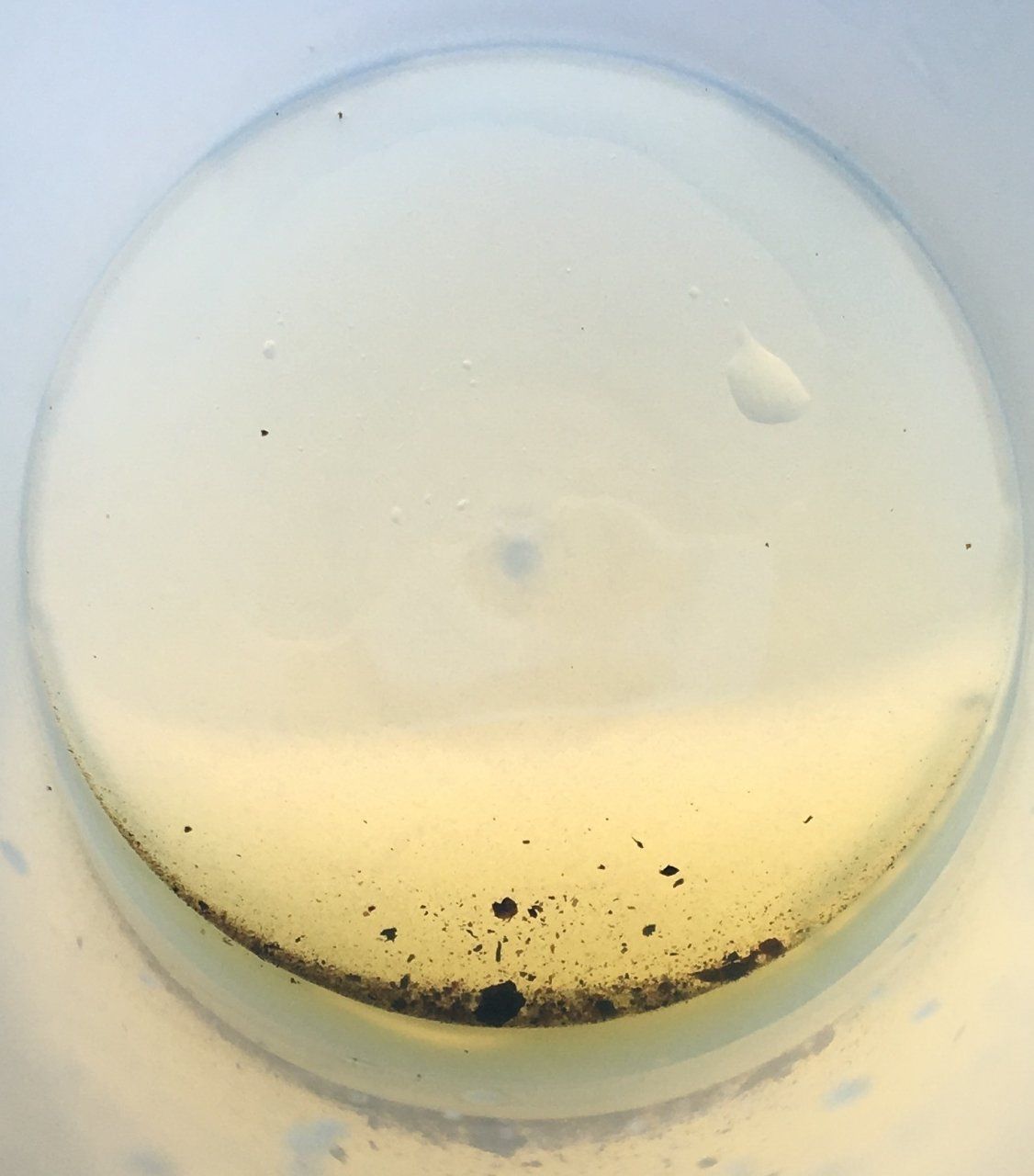

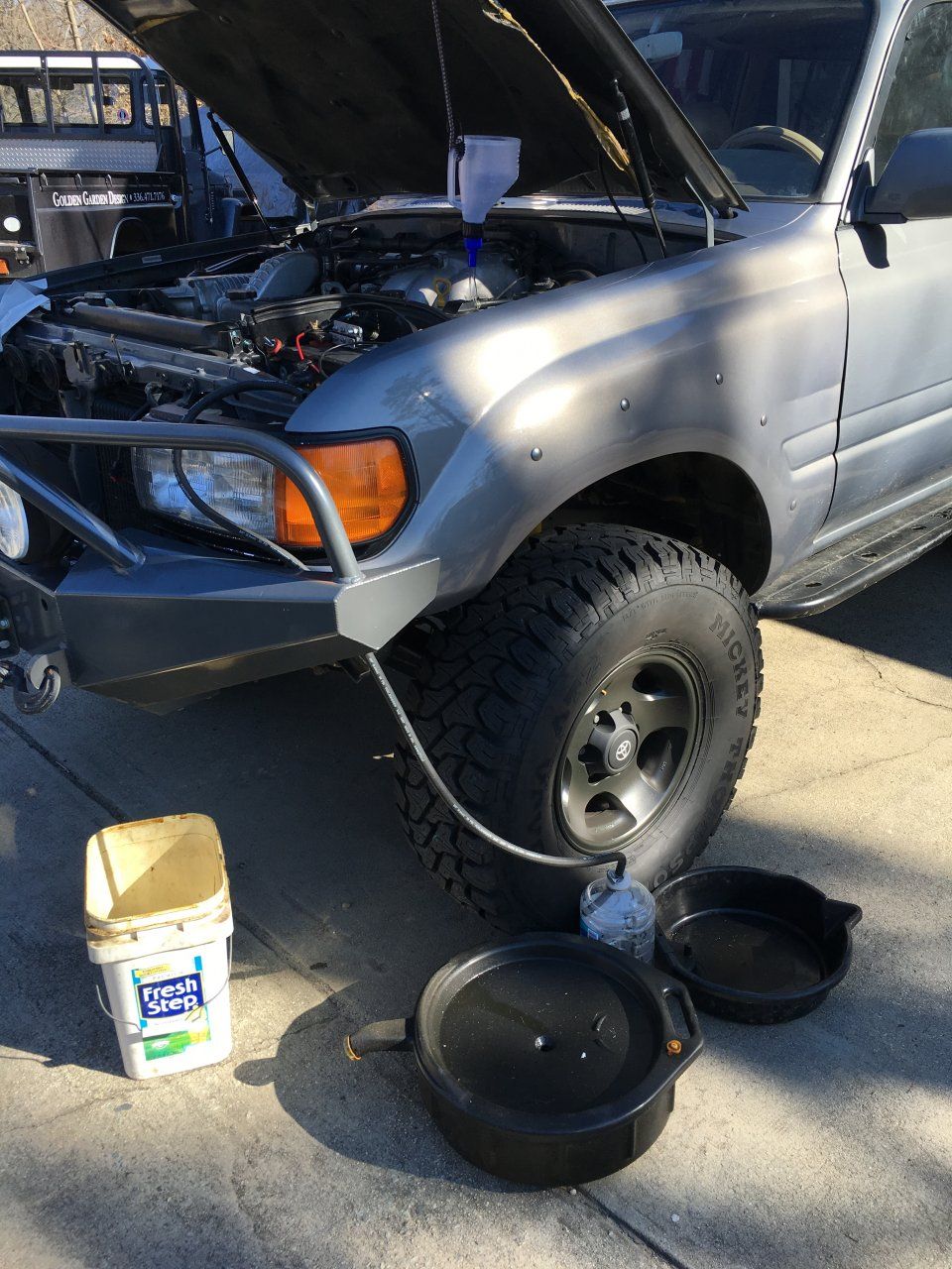

Flushing 10+ year 100k + mile old ATF 285k

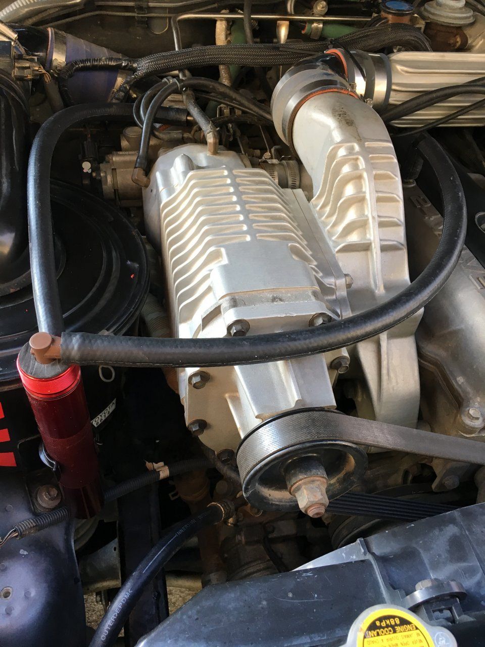

Changing the oil in the supercharger 285k. That old oil is some stinky stuff and appeared pat due for a change. I used the GM supercharger oil mostly because I live within walking distance of the dealer and was in stock

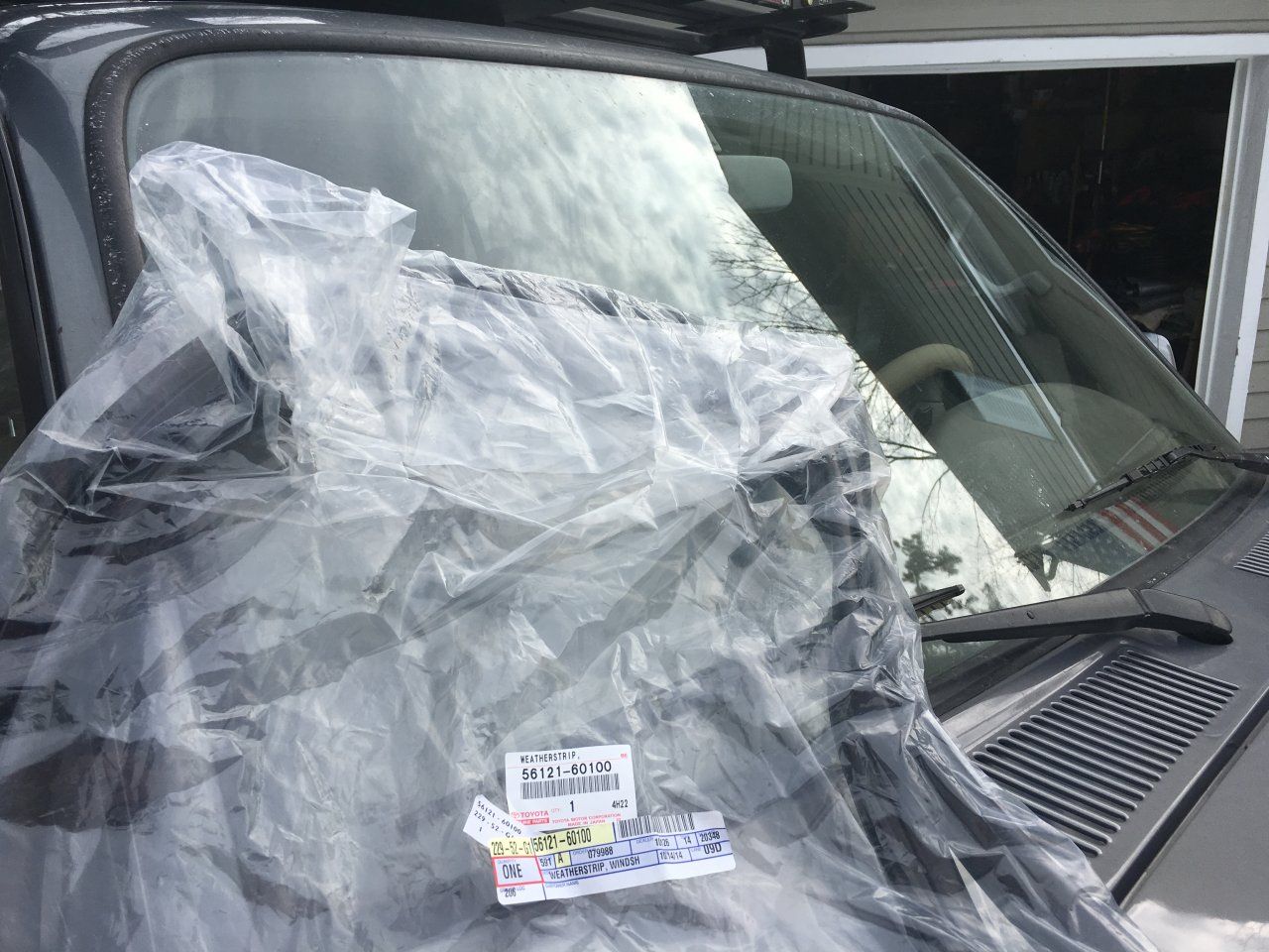

New windshield and gasket install. Thanks to Onur again!
Which warranted reattaching the snorkle in a more secure fashion to a pillar. Threaded rivets this time as the nutserts don't stand up to vibration. Took the opportunity to redrill and paint the stud holes. Apparently my snorkle shrunk, I guess that's normal with age :lol:

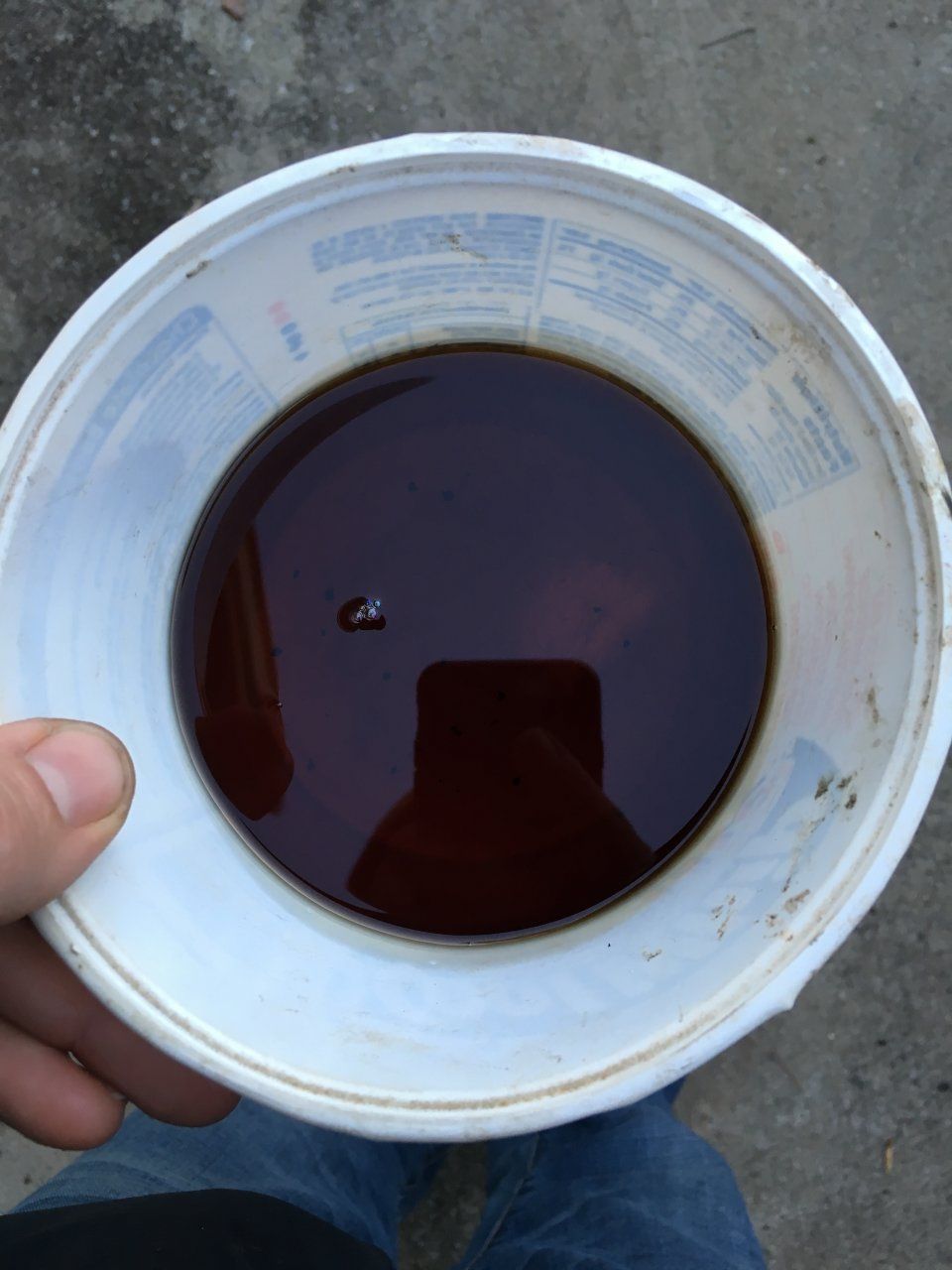

Fluid from right rear caliper which was rebuilt ~5years ago

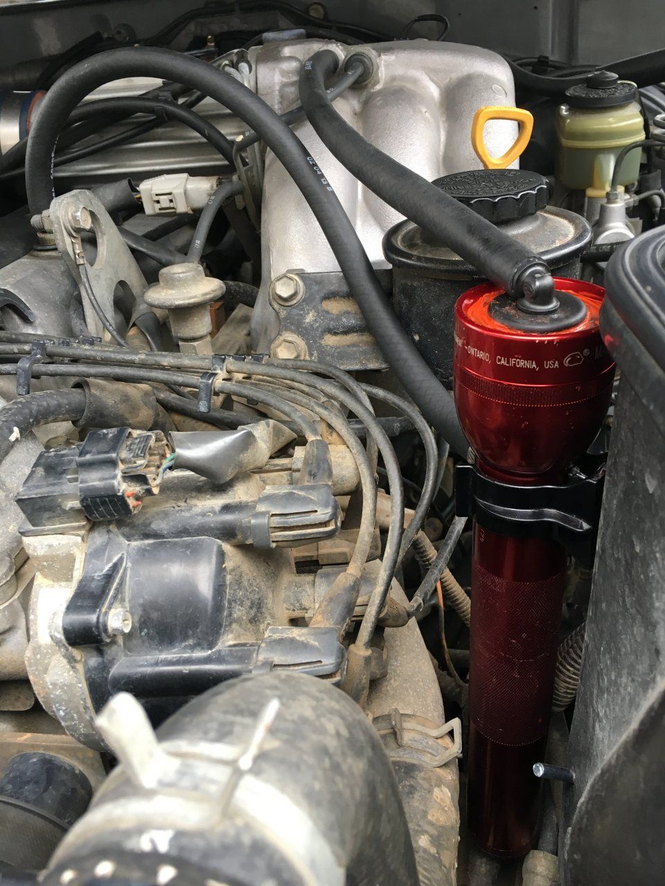

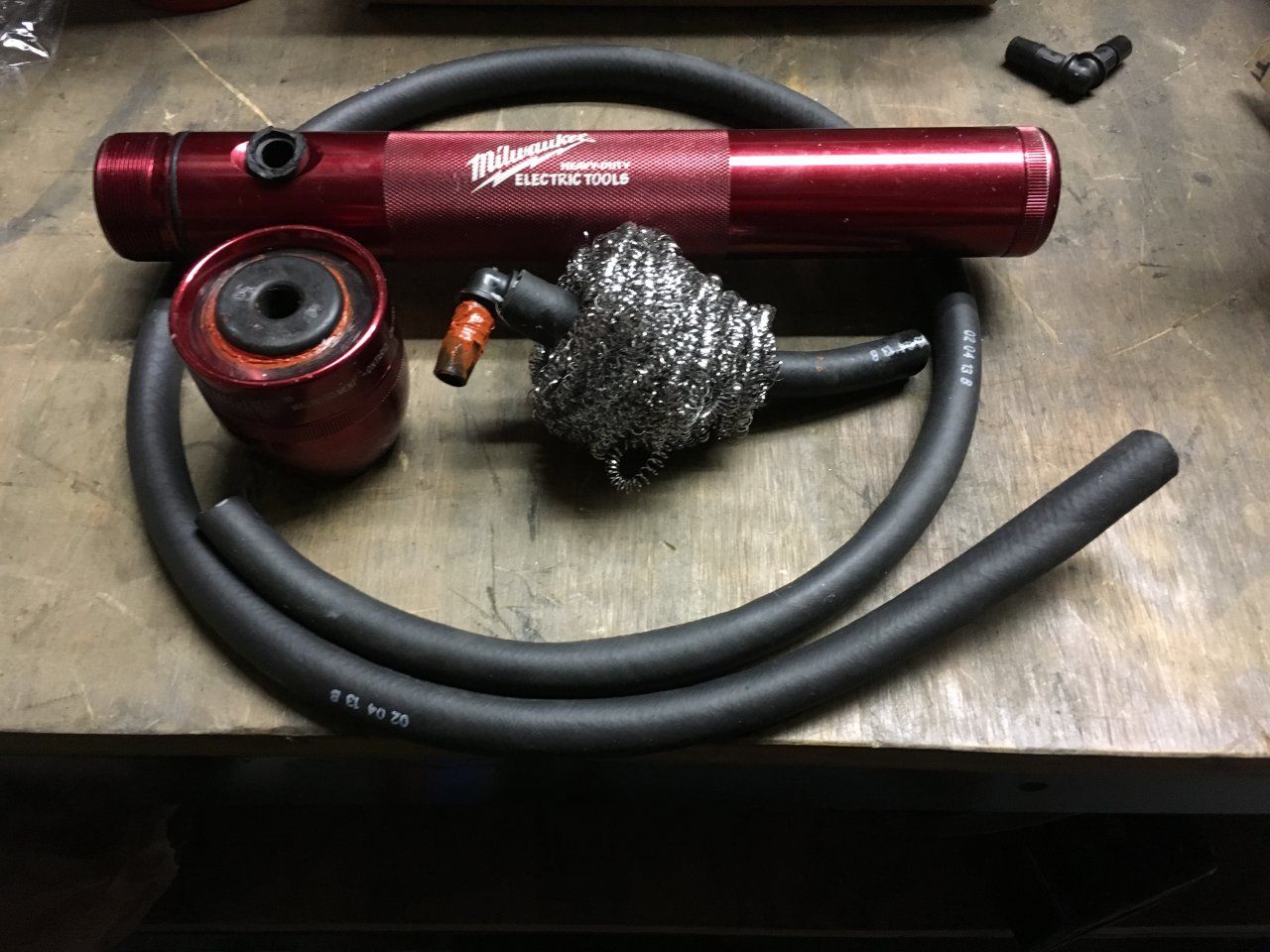

Added an old PCV catch can mud mod from a decade ago. Have held on to these mag lites for this purpose for ages but finally got off my butt and got it done.
And if one is good two has got to be more betterer:) actually only added the second because it sees boost and was my oily line of concern to begin with.
