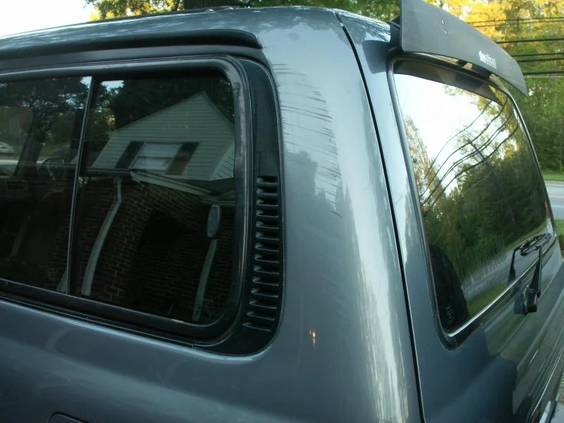

:doh: and now w/ more character .....
and a tentative date to spray the flares this weekend work/weather permitting:)

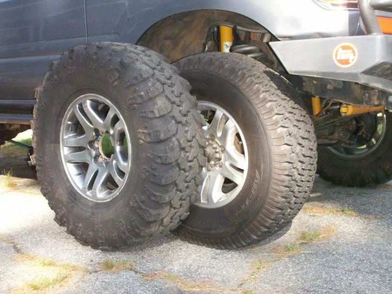

Concrete is running my old trxus and we both liked them. Can be a bit of a bear to balance but its a great in between tire that does good on road and great on the trail. However im running the two sets for now. Road (315) and Trail(37).

It's just a flesh wound. That sh!t'll buff out. :D
Seriously though, a good scrub with clay bar and polish will make a huge improvement.

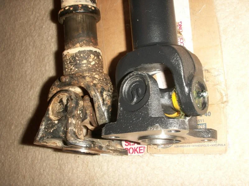

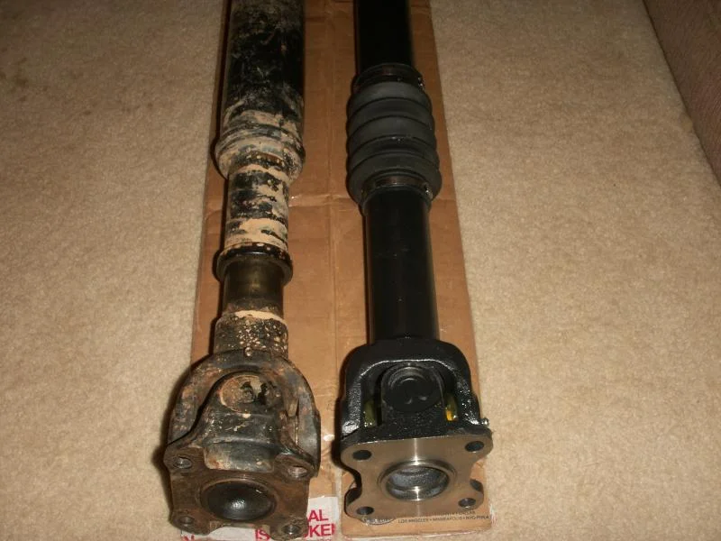

Picked up a new driveshaft from Tom Woods this week. Was surprised to hear Tom himself answer the phone and make placing my order a breeze. I followed their abc's and 123's for sizing the appropriate build, but if you go to their website there are a few other factors to include to ensure vibe free performance and longest life.(pinion angle, tcase angle and driveshaft slope)
For my application(Your results may vary) I ended up selecting their T4 flange w/ a 2'' diameter shaft vs the OE 2.75 but the wall thickness is .120 compared to .083 (i believe but am not positive) of the stocker. The U-joints are 1310 series I also opted for the extended life splines and the boot. I did not realize the shaft splines did not have a zirk but im not too worried as its caused some folks some problems from overgreasing and with the limited miles the 80 sees now i can add it to the annual maintenance if its even necessary.
