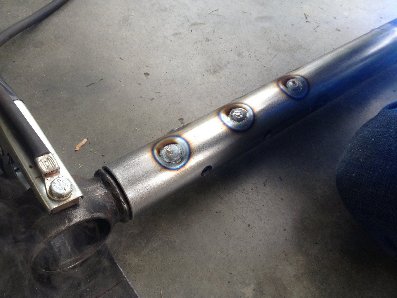

I went back to an OEM driveshaft with original ujoints and 235k miles. Wasnt the plan; the shop was supposed to retube it with 1/4'' tube and then replace the ujoints. The technician didnt replace the joints and when I asked why he said they felt great, plus thems is them toyota joints, wouldnt replace it unless its broke. Place is out of town so I went with it, plus had really wanted OEM units if they were replaced but was under a time crunch and had not ordered them. The tom woods had developed some play b/w the ujoint cap and the yoke and they do not really have a lifetime warranty :(

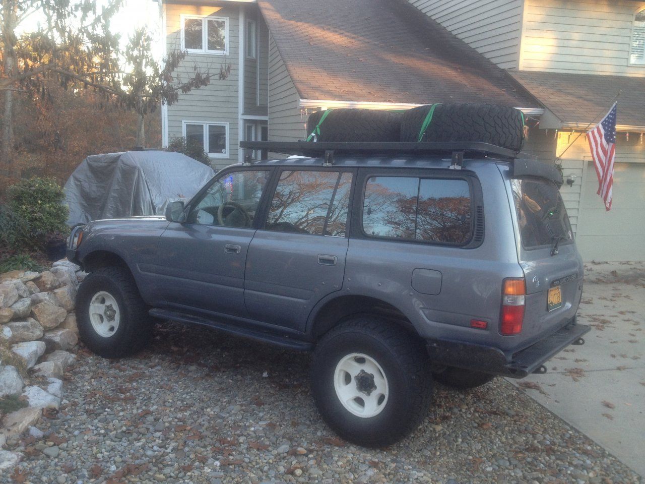

Picked up a windcheetah roofrack by FrontRunner. I had wanted a flat profile rack for eventually strapping a Maggiolina to it for a while now and picked this up from a local mudder.
pretty slick 8mm bolt mounting system allows alot of flexibility, made a bicycle fork mount for it today

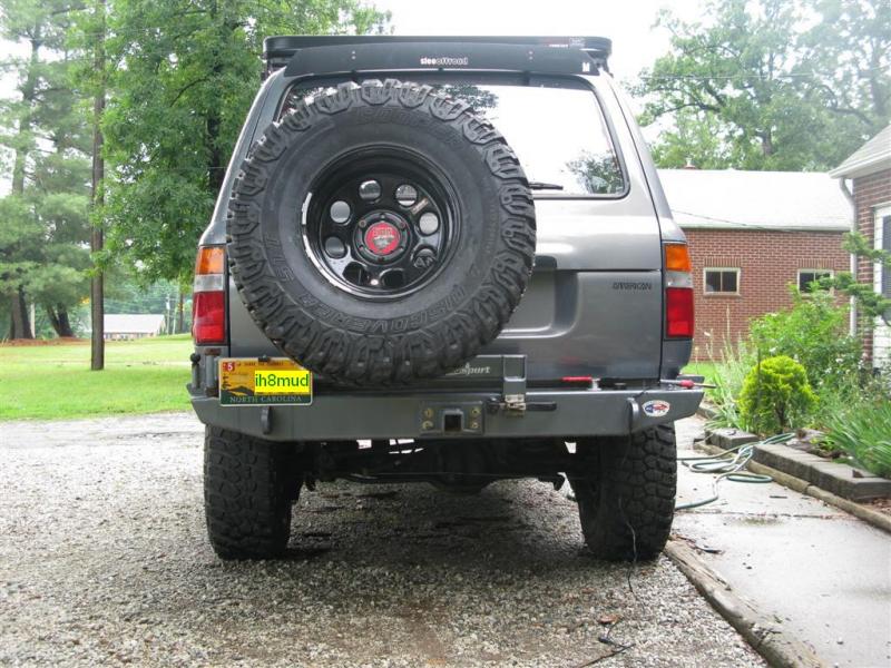

So I didnt have to order the relocate plate and deal with disconnecting it each time i needed the spare (or more appropriately switched tire sizes) I drilled and tapped the swingout instead. Tag fits perfect. Had wanted to mount it to the bumper but the tag is 1/4 inch larger in dimension and would hang down grabbing rocks or stick up making the shelf of the bumper less useable.
Only regret is that it interferes with the bumper when opened past 90*. Not to big a deal cause if you open it past ninety your getting ready to crack a tail light with my setup.
LitePLATE tm from offroadonly.com

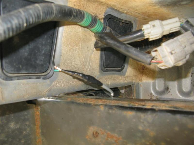

and the routing from OEM liscense bulb fixture I pulled the clip and removed it from the tailgate, ran it inside the rear rocker void and out the square pop out panels. I can always run it back as it was without ever cutting into the system.

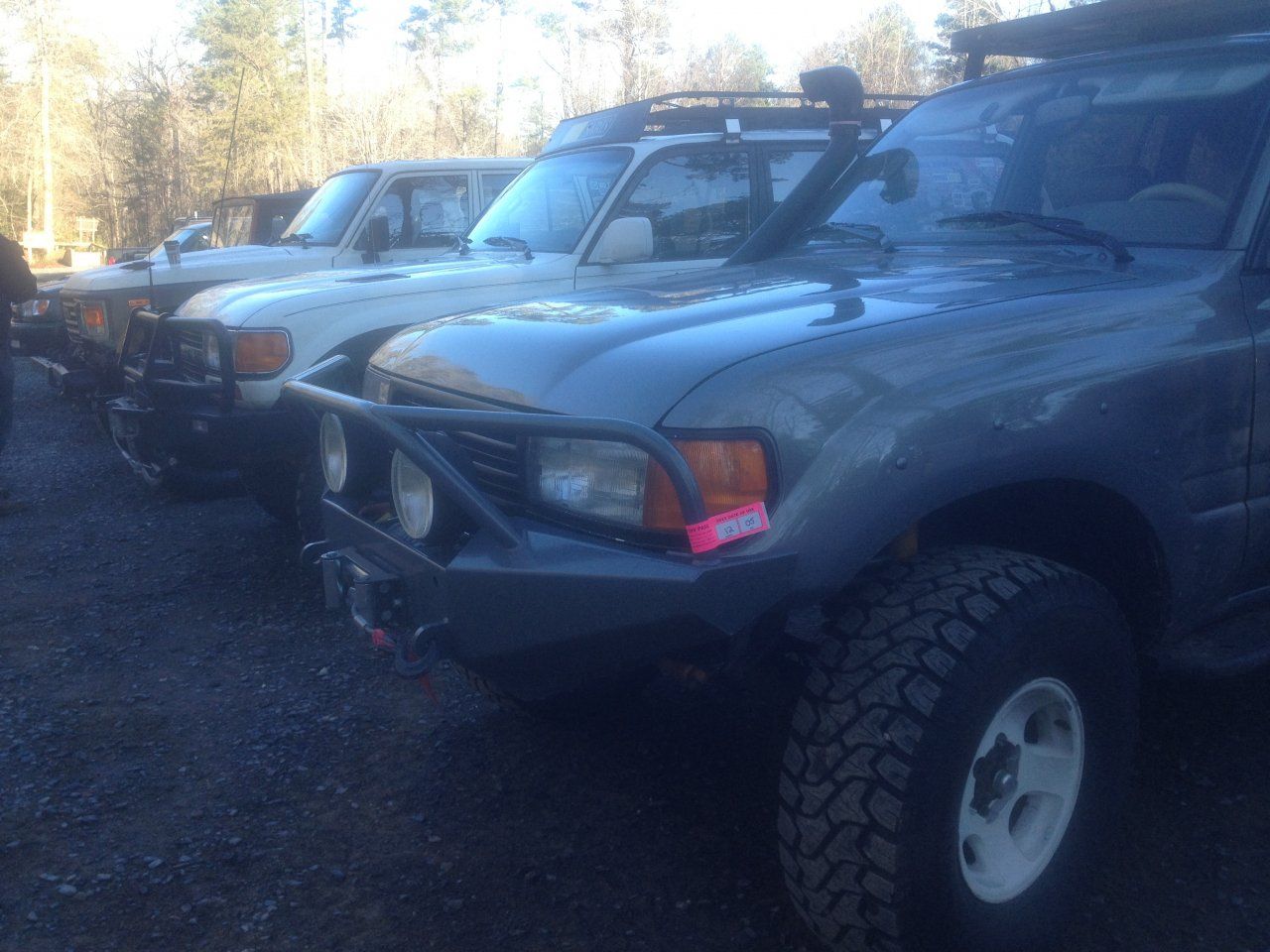

That sucked and this issued in the era of the “runs with white fender” jokes on the ham/cb’s on our club events for a few years as money was tight and im good at procrastinating. I got this one off a local part out near me.
‘runs with white fender’ on a few olde north state cruiser runs

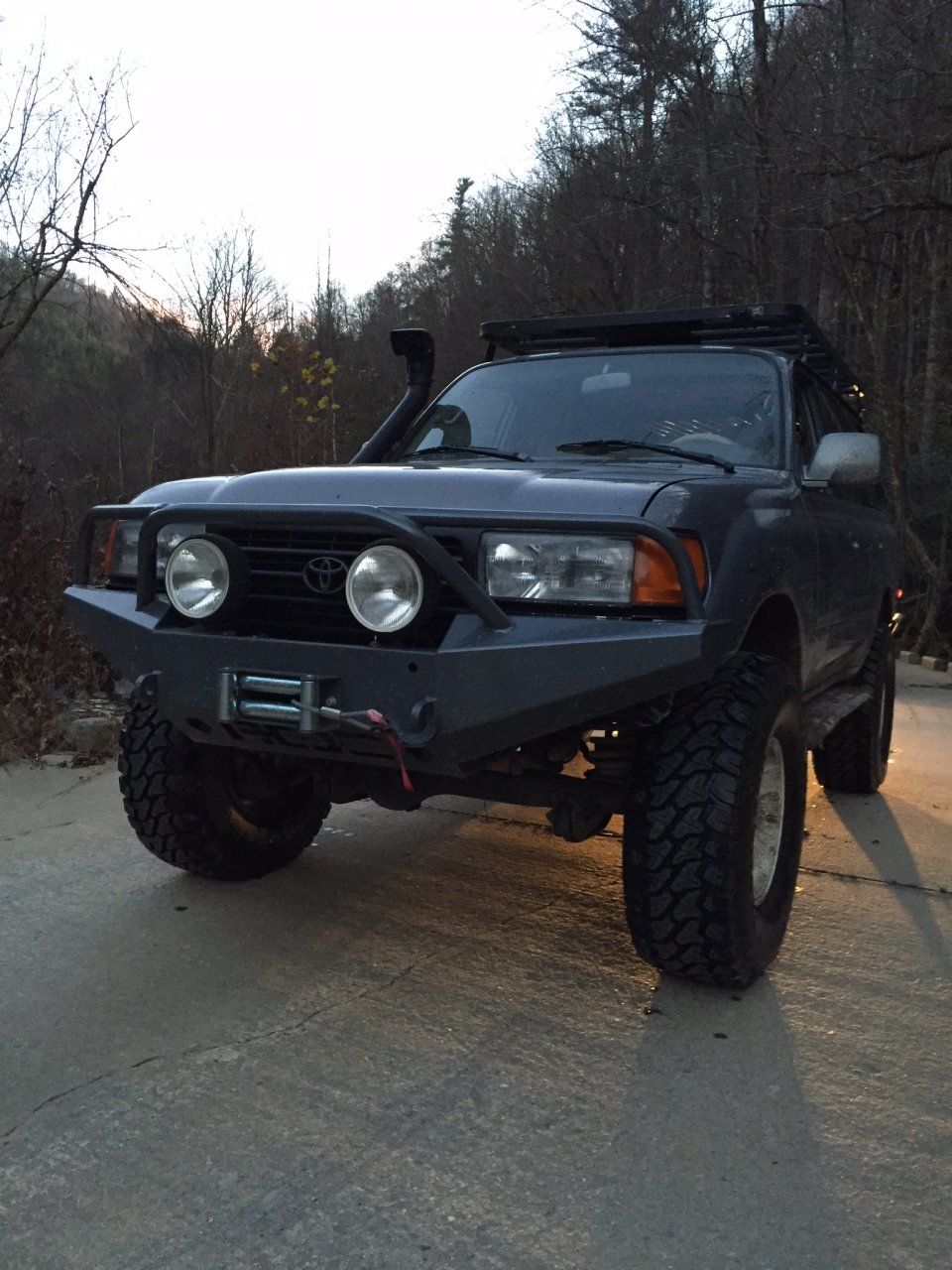

I dont even recall what happened with the old arb???? but i picked up a used one from a local member whose 80 met an unfortunate fate. Back in Black and i was kinda digging it. Wheels followed shortly for a change of pace from the monochrome
Black arb

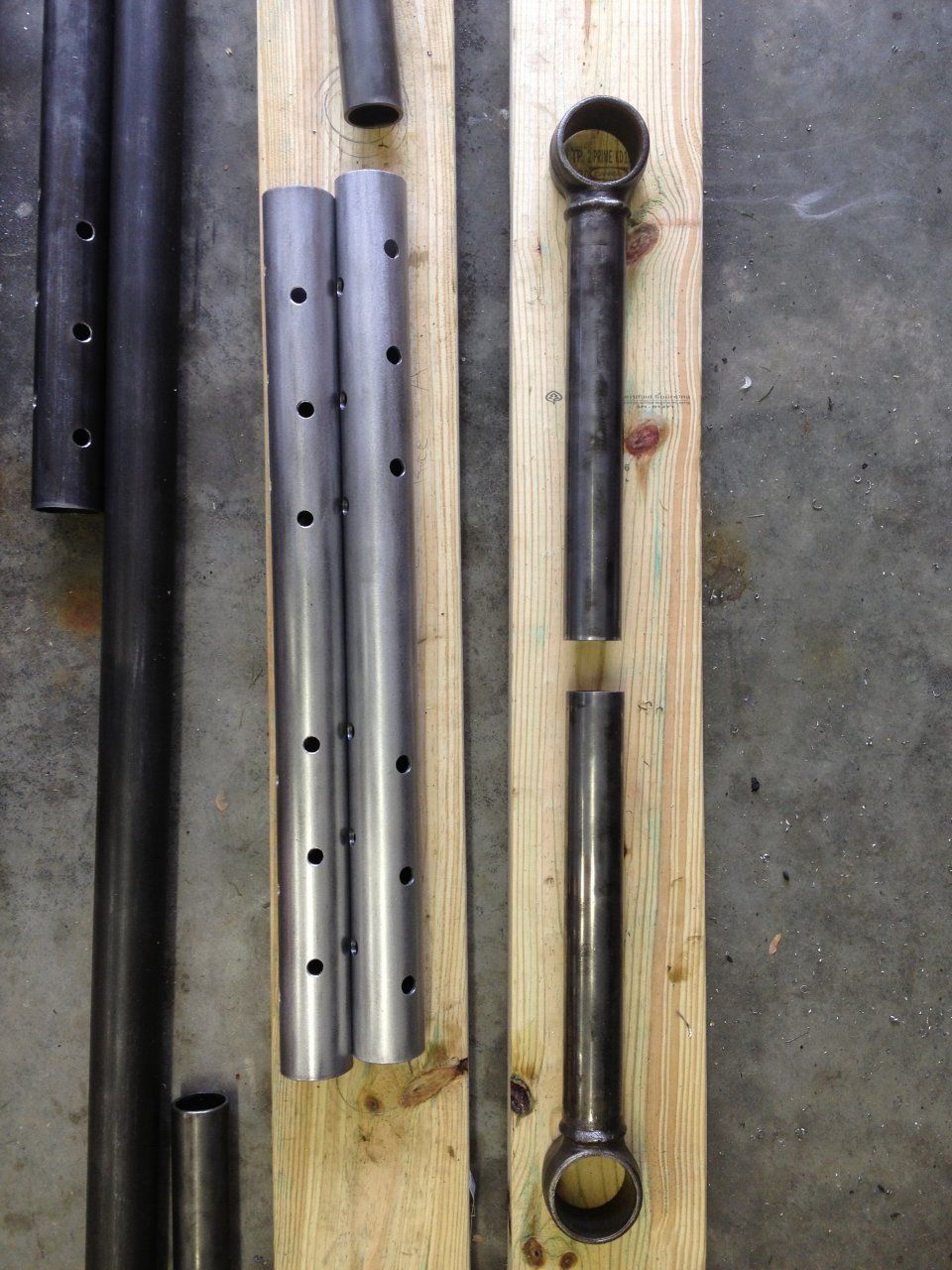

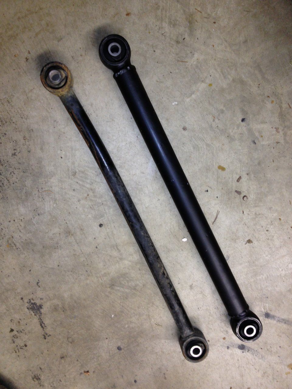

Also somewhere in here between bumper changes i made up a set of lower rear control arms by sleeving a set of early FJ80 arms. Added 5/8'' IIRC to overall lenght and added new oem bushings.
New lower control arms
