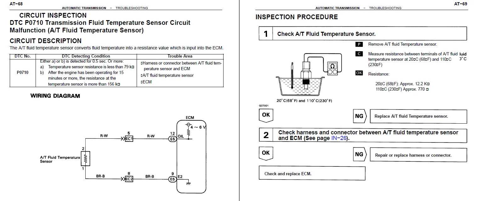

On the A343F, the temp sensor is a thermistor that feeds the ECU which triggers the light. The FSM does not specify a temperature for the light, but does specify resistance vs temp in order to test the sensor.
Resistance :
20°C (68°F): Approx. 12.2 kΩ
110°C (230°F): Approx. 770 Ω
Resistance :

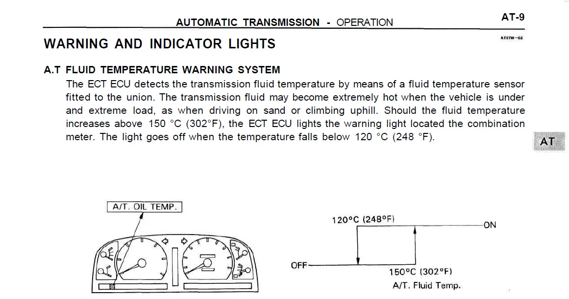

@richmondbob
I realize I'm late to the party, but...
from the A343F manual:
