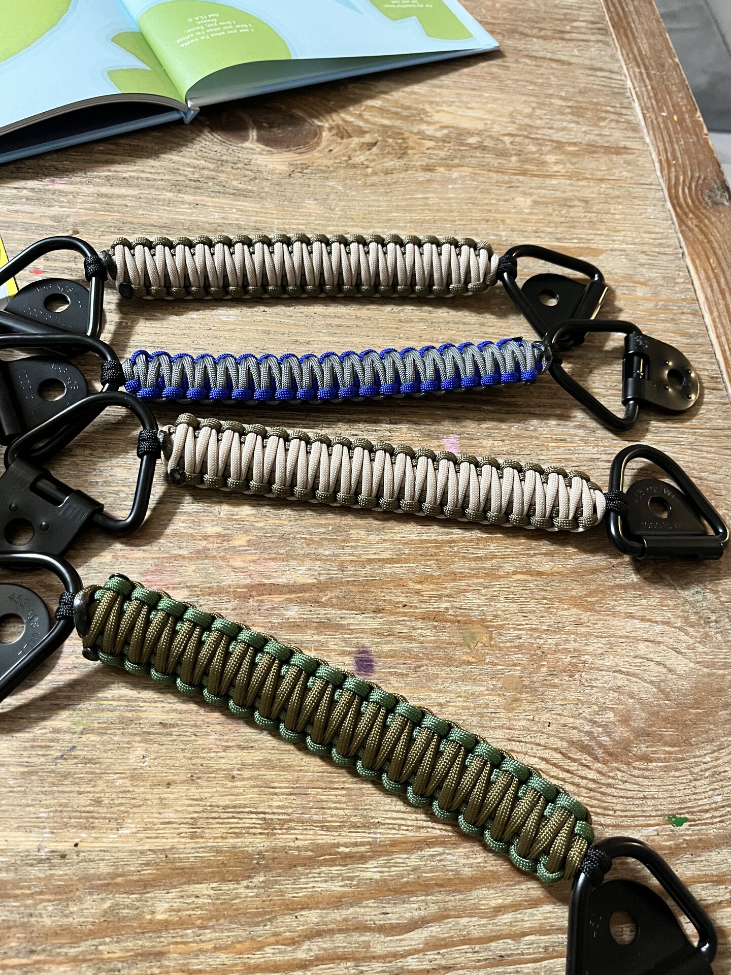

IIRC someone did a quick fix by wrapping paracord around the handles, serves a few purposes (potentially): covers up the crumbly plastic if you have that, or protects the plastic if it isn't crumbling yet, but also you get a better grip on the handle (assuming the paracord is wrapped tightly).
Probably other ways to go about it (wrap with leather or a heavy cloth (1000 Denier Cordura),---

I’ll have to grab a pic. But I use Jeep paracord handles look cool and work good. Bent a stock on dragging my big ass in. And the kids love them in the back cause they can reach when wheeling
I don't mind the paracord portion, but could they not find a cheaper, chinsier bracket for the ends? :doh:
