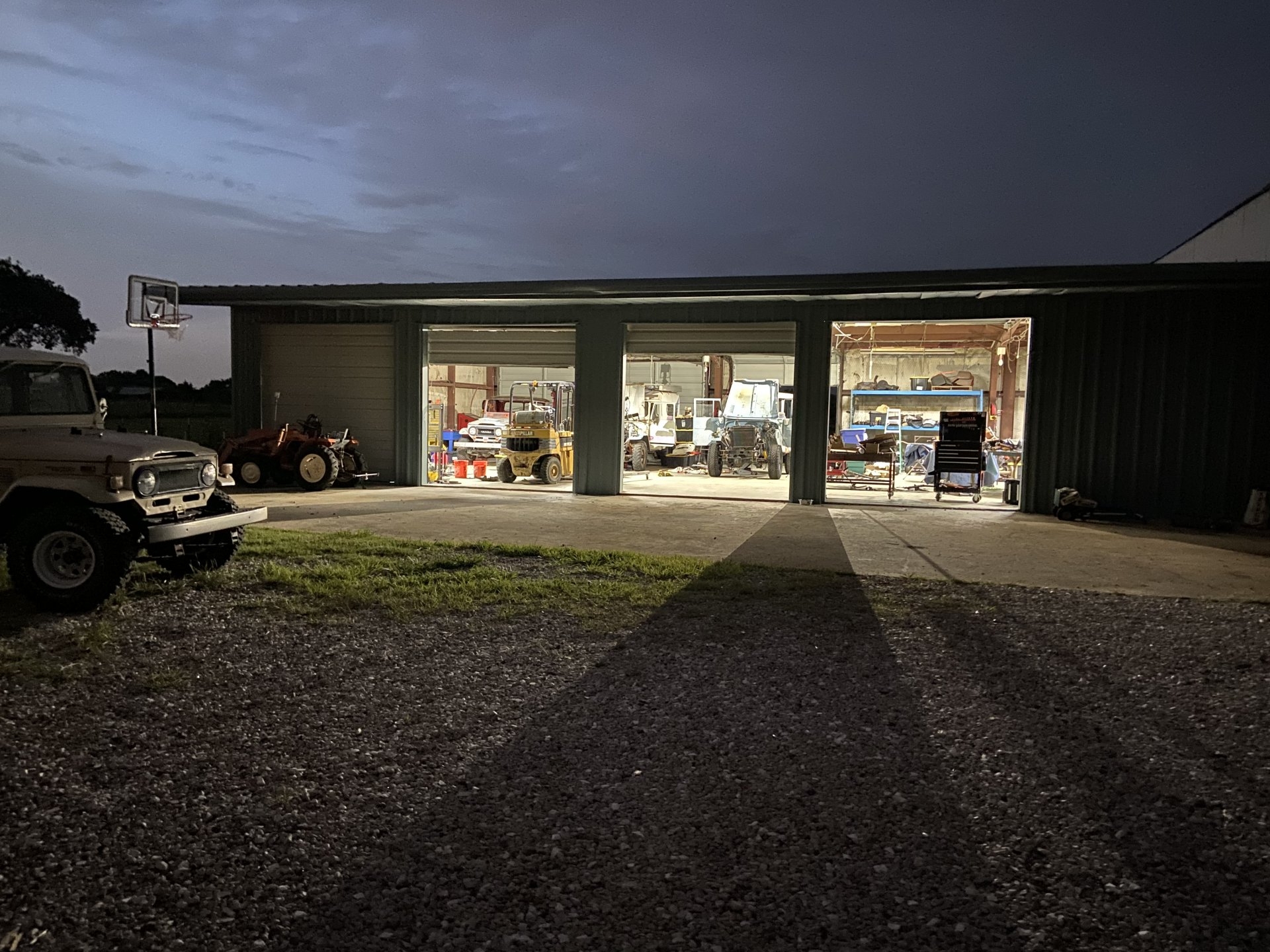

A journey with my boys- The Elf Barn as I call it.
