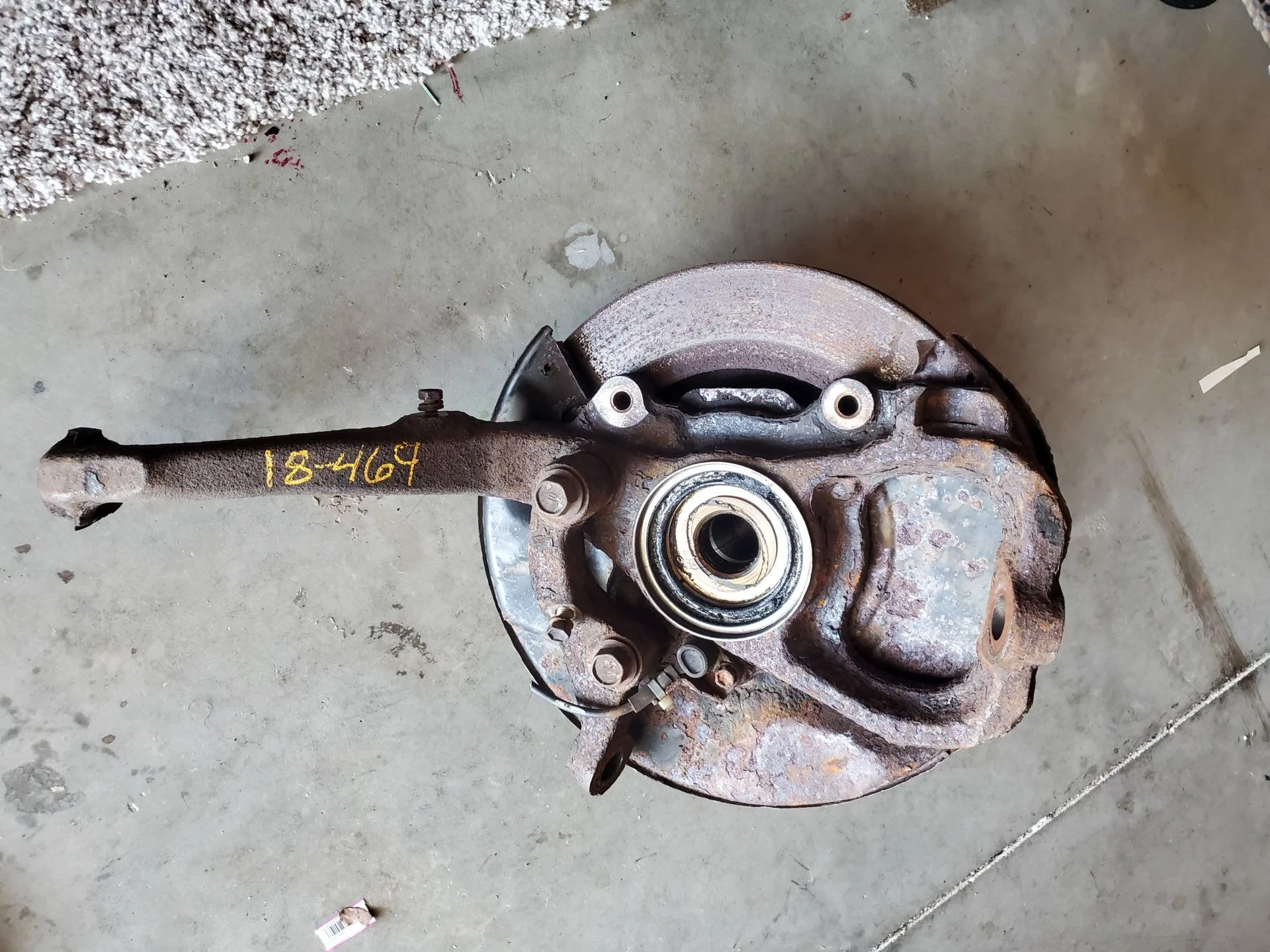

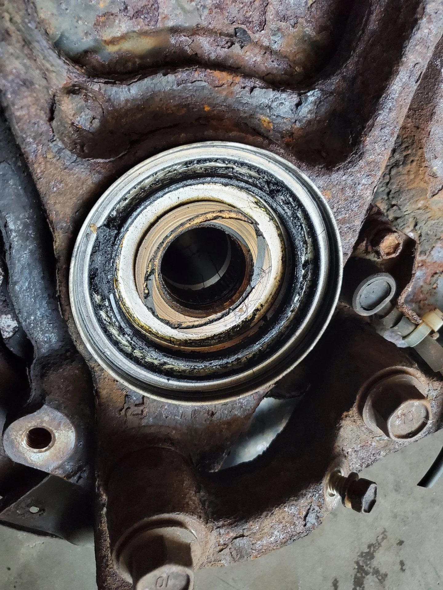

Replacement steering knuckle as I received it:
Yeah definitely give it some love and clean her up. Clean the back to get a better idea of how that brass bushing looks like, seal should probably be replaced with that much rust. Give her a fresh coat of Rust Reformer/Chassis Saver/etc. once done and before you install to keep her nice afterwords.

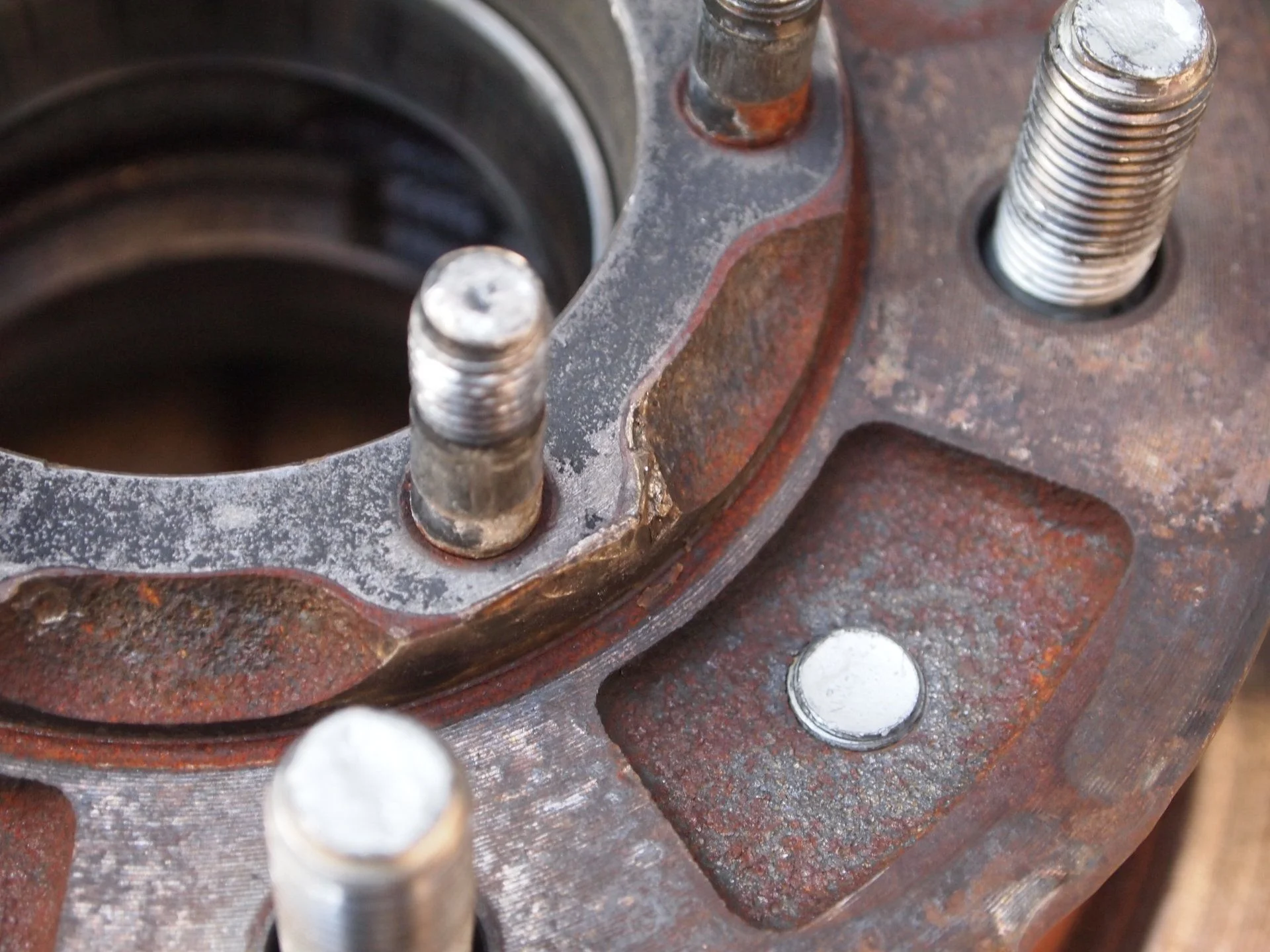

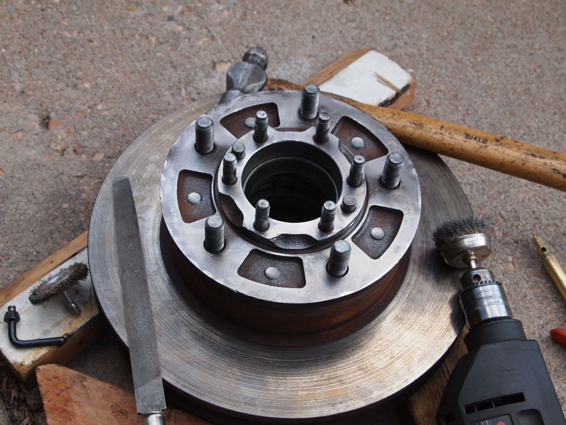

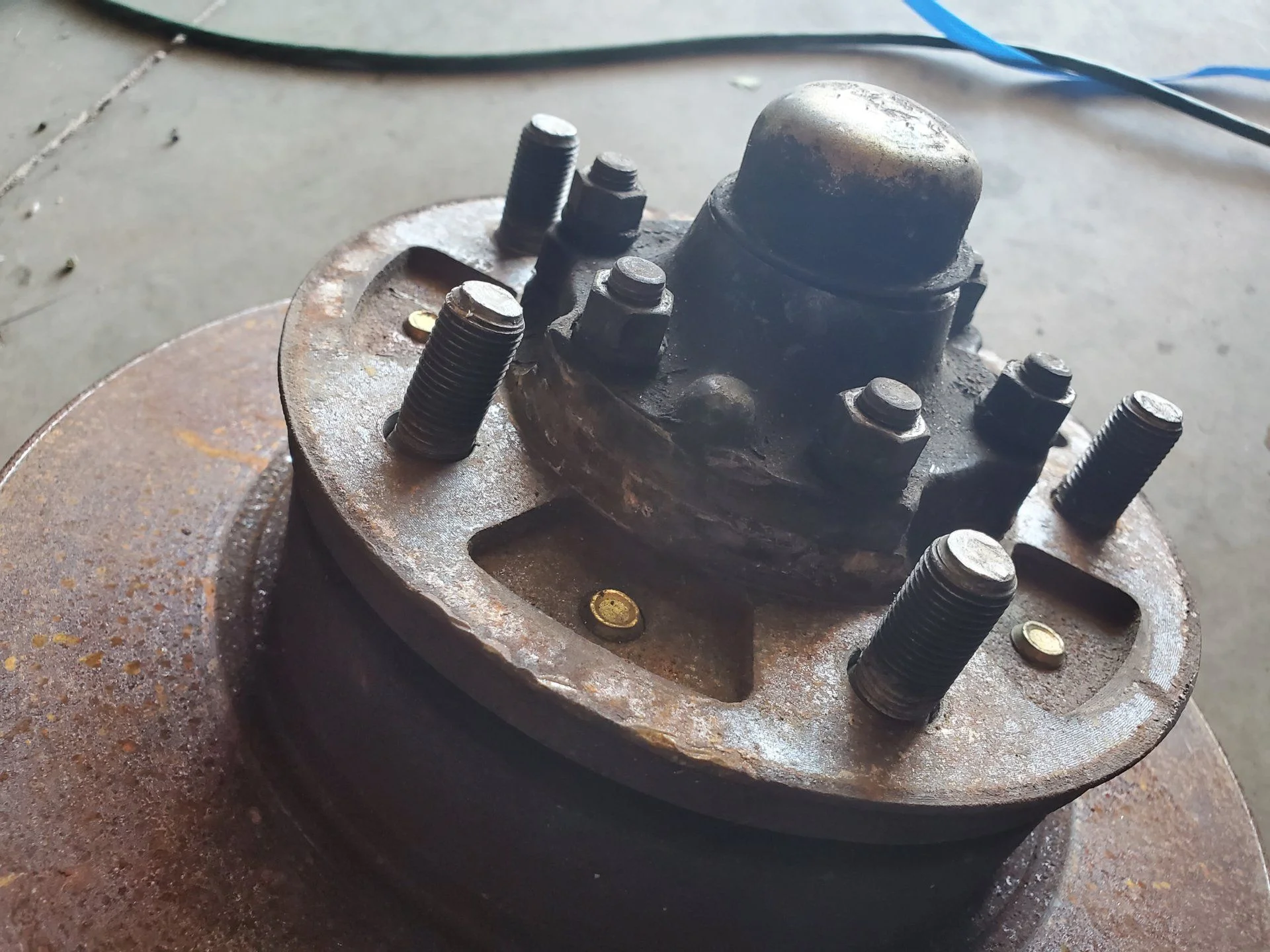

I can see someone pound with a steel hammer, on that hub flange and hub to break apart. Doing that warps the face of wheel hub and hub flange. Than we can't get a good seal. I recondition with hammer and file to flatten out.

Just noticed, like how the seller just clipped off the speed sensor instead of unbolting it. Makes me wonder how many of the bolts are seized on due to the amount of rust.
So going off what @2001LC said, you are going to need a new hub flange POTENTIALLY. I would probably replace just for good measure seeing how pounded on it has been. Then you are going to want to see how well you can clean up the nuts, washers and cone washers, possibly replacing those. Dust shield looks like it has seen better days which means it should potentially be replaced along with the gasket and seal for the backside against the rotator. Once you get apart you will see what the bearings, needle bearing under the brass bushing look like to have a better idea of what all is needed.
YUCK!!!! I am in similar position where I am dreading taking apart my hubs to see how badly 4WP techs really screwed things up. Planning to replaced just about everything there, now to include all bearings, brass bushing and needle bearings, for BOTH sides much like you. Luckily my truck was in warmer climates so there is little to no rust anywhere. I dealt with that on my 60 (A LOT) and am glad to not deal with it again, but damn this is getting ridiculous! I JUST WANT A NEW STEREO DAMNIT!!!
Wow- that used knuckle is rough to say the least. Can you return it? Have you checked cruiser parts for used options? They usually have good take offs.
Best bet is to get a good picture sent ahead of them shipping it.

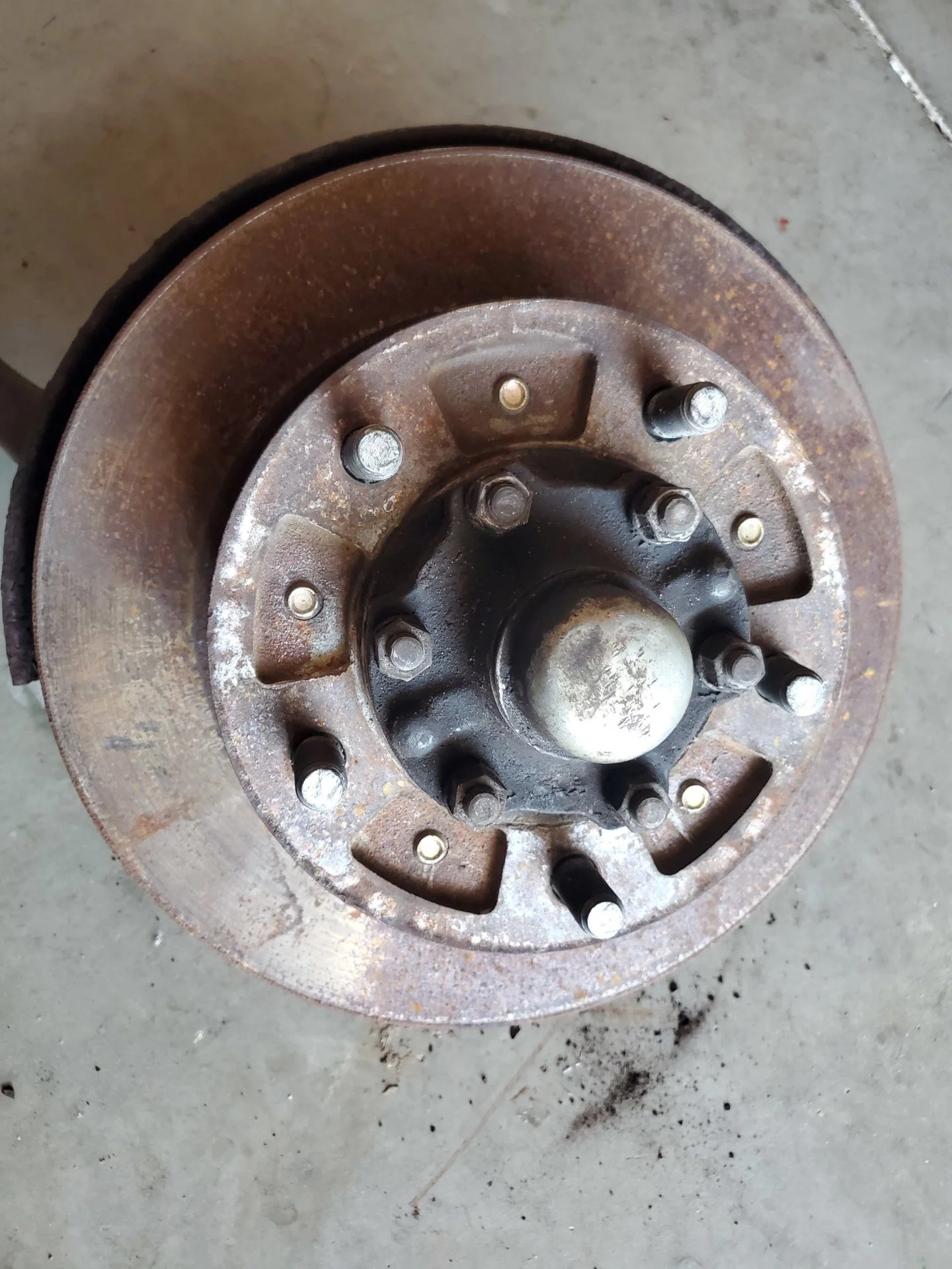

It looks worse than it really is. In fact all the bearings are pretty smooth. Almost everything looks like this in midwest. A little elbow grease and some paint will hopefully make it looking good again.

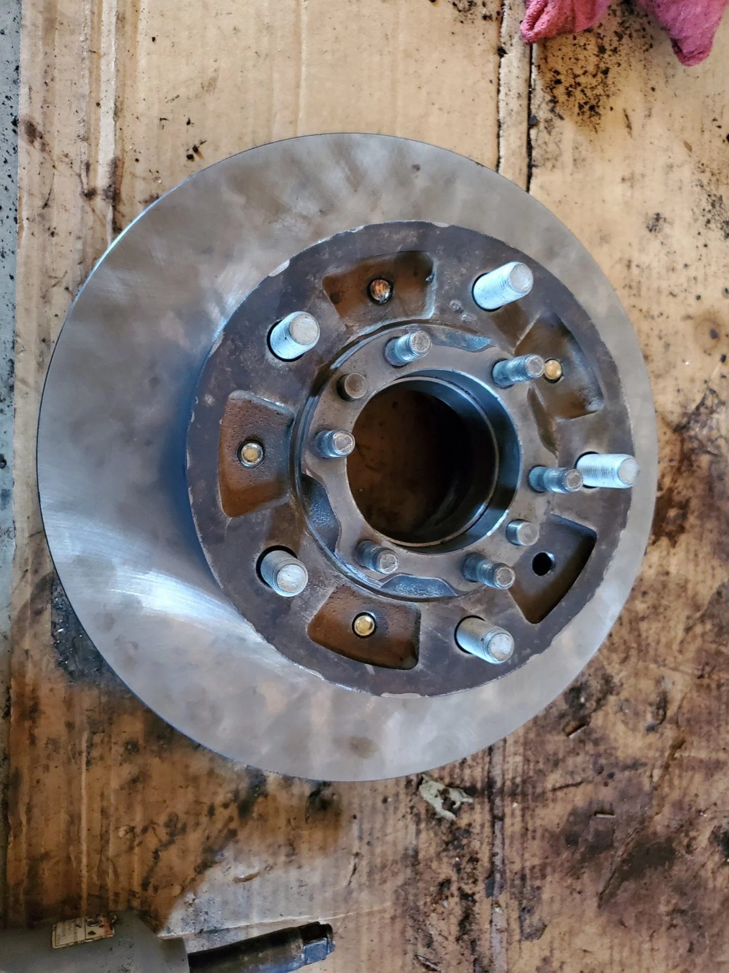

All the disassembly went smoothly, no stuck or broken bolts. The rotor actually appears to be new. I think I will have it turned and then use it.

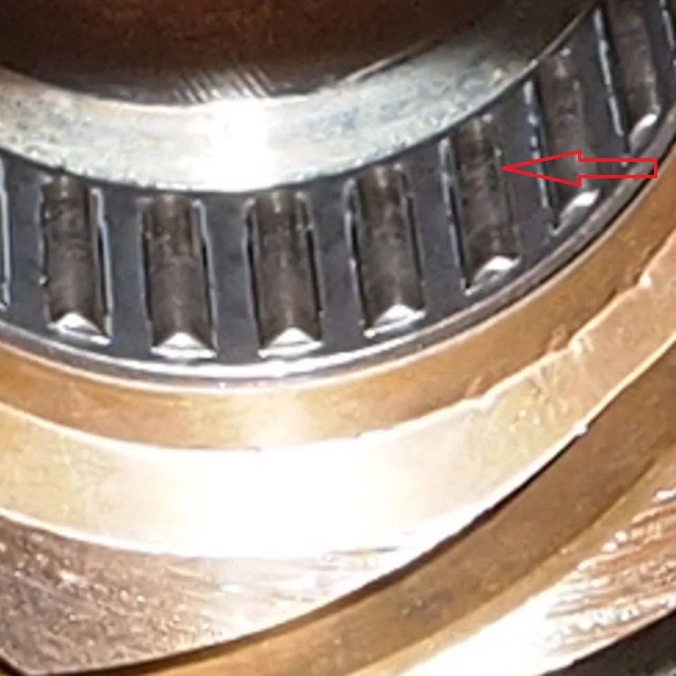

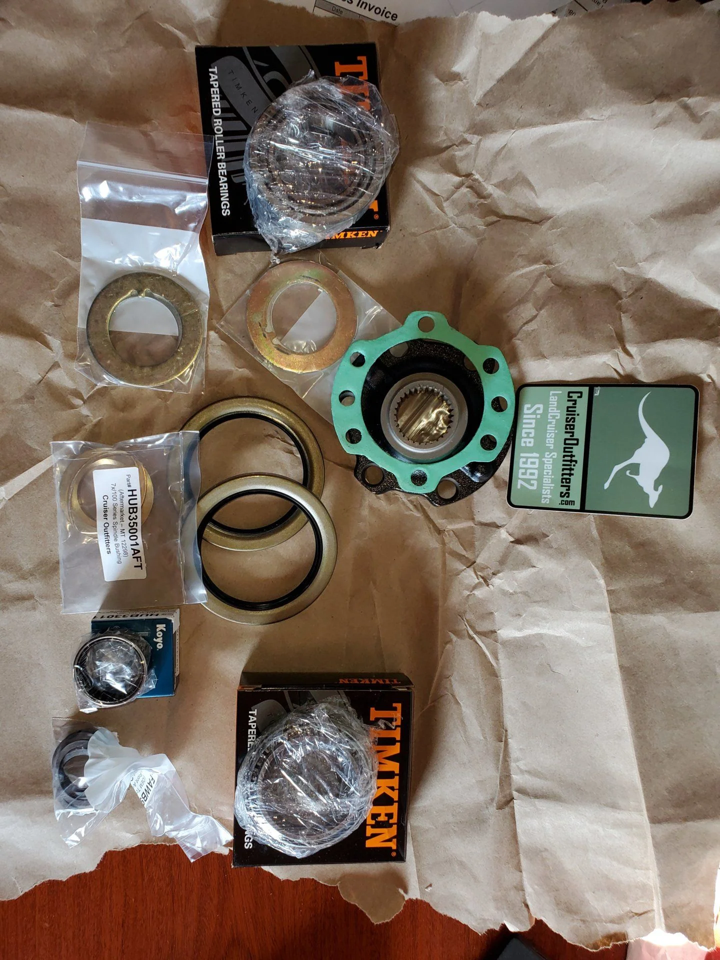

Big bag o' goodies arrived from @cruiseroutfit . I think the needle bearing and the shallow brass bushings in the replacement hub are okay so I might not replace them.

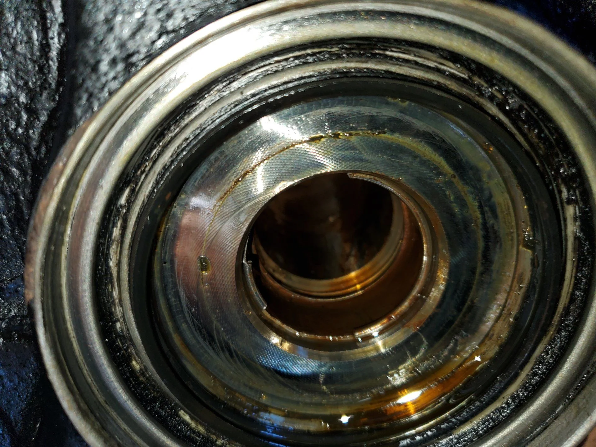

Very hard to tell if old needle bearing cooked or not. I clean very well and look before and after cleaning for discoloration, pitting or scoring.

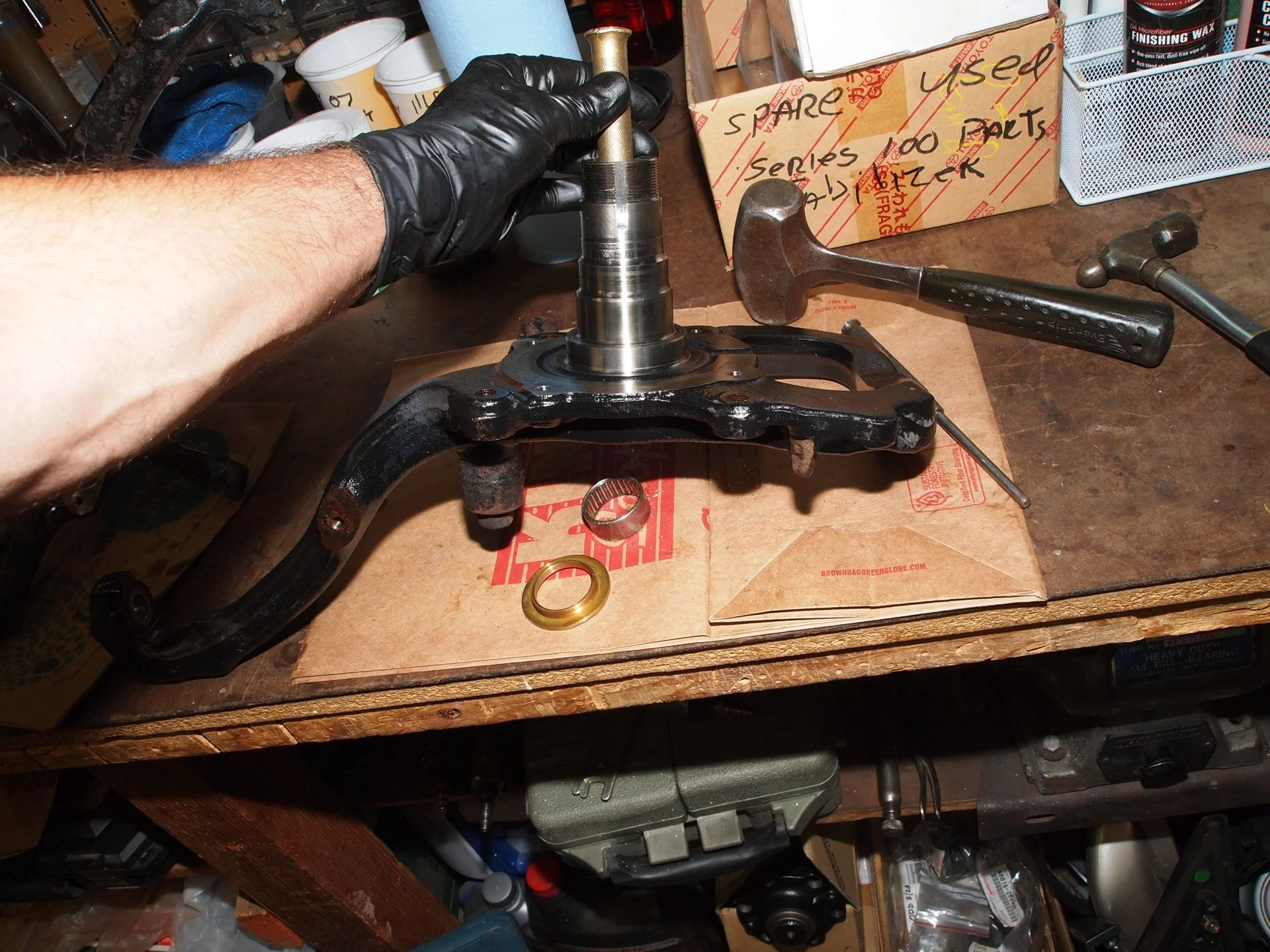

They are very easy to replace if you do.

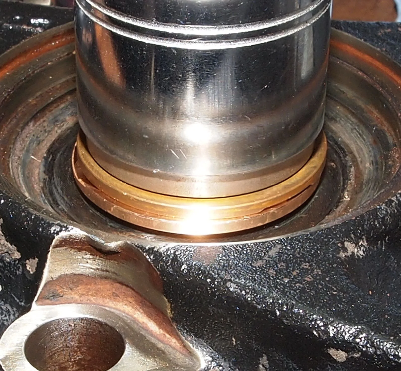

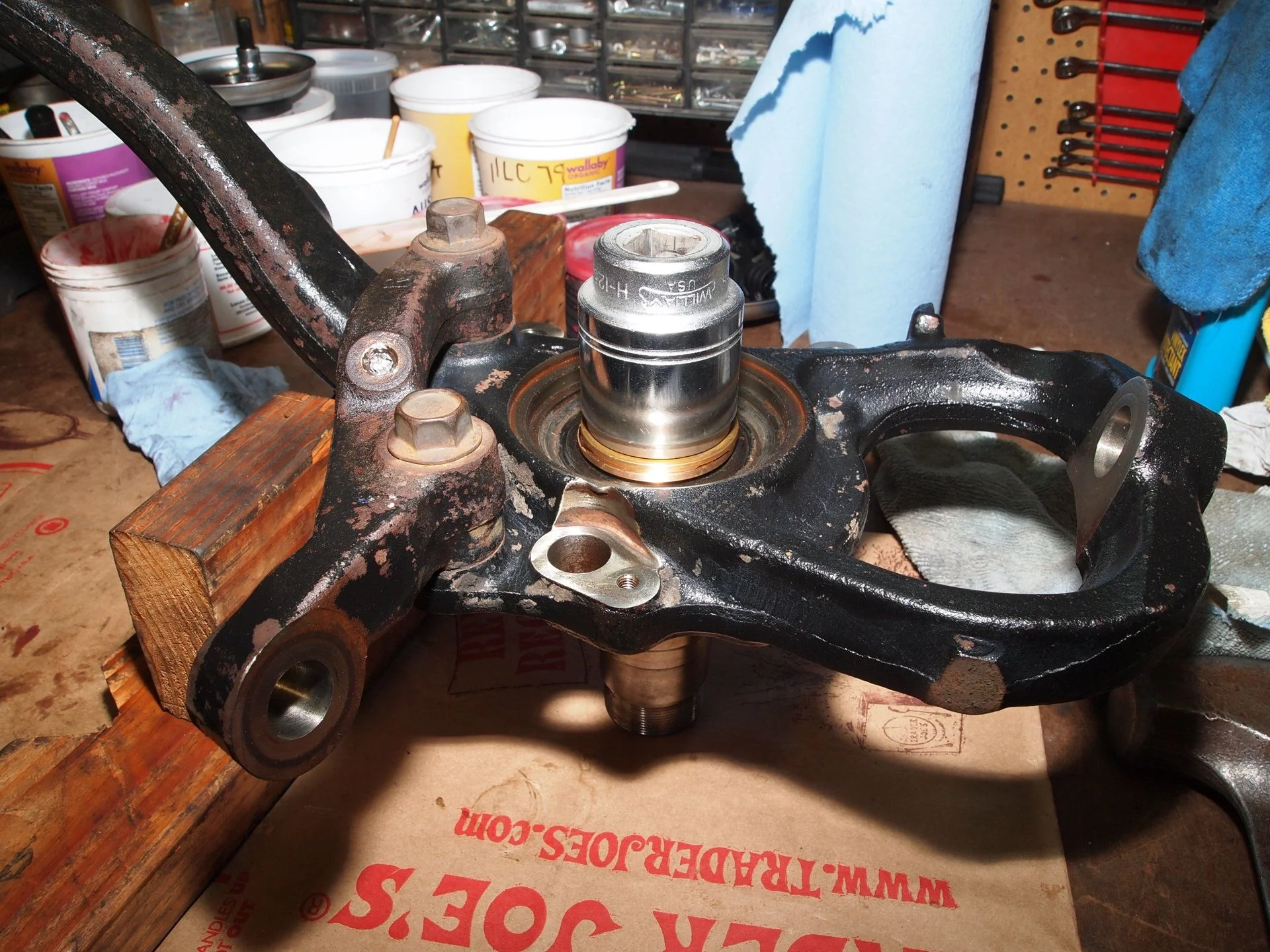

Notice I used old bushing on top to press in new.

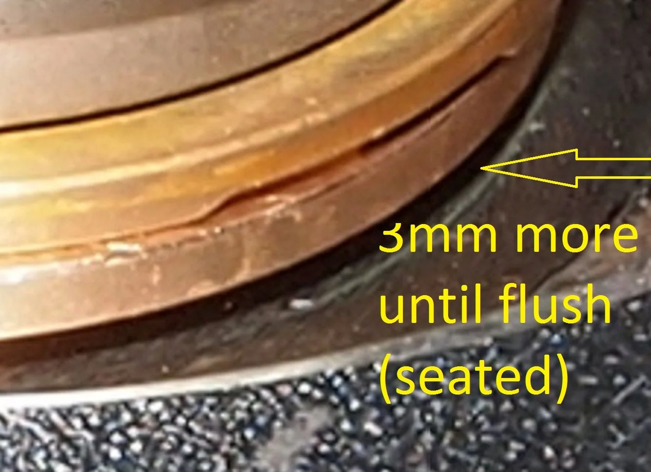

Tap or press in until bushing flush with knuckle.

But there is truly no better time than now to replace the needle bearing and bushing.
Exactly!! This is why I will probably just end up replacing all that garbage when I plan to do the hub flanges on my truck. One of those "while you're in there" type scenarios. In @ClassyJalopy scenario, this is best time instead of taking a chance.

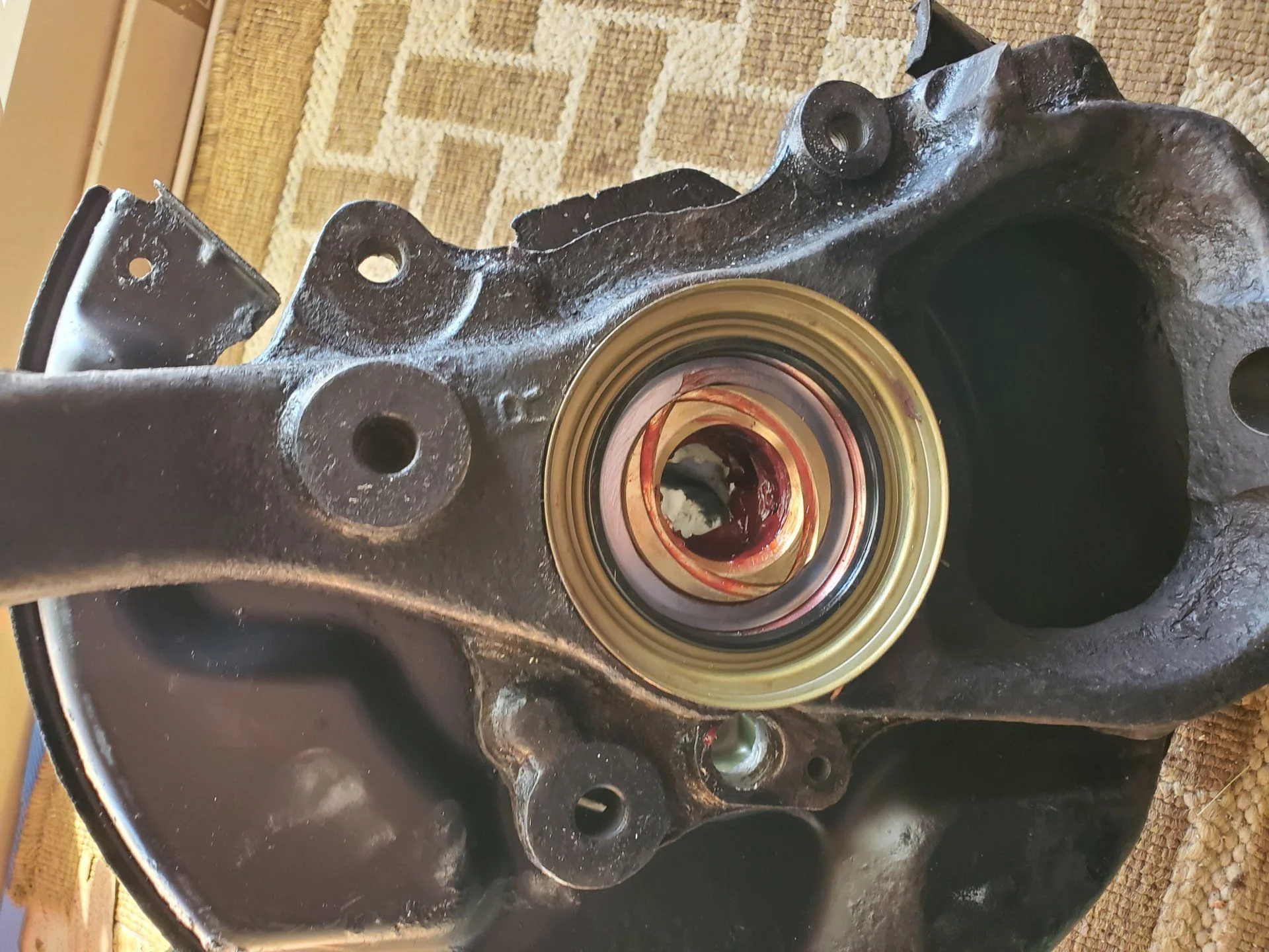

So I got convinced that the proper thing to do is to replace the needle bearing. The trouble is I can't get it off! The bushing came out easily. Then I couldn't get much purchase on the outer race of the bearing and ended up destroying the inner race. All the needles fell off once the inner race came off. Now I am trying to figure out how to remove the outer bearing!
I've never seen one stuck. You may have to dig out. If you can grab that lip next to where metal rip with vise grips. Then possible twist ripping the metal inward and roll out.
Rip the large seal out also. Best to replace.

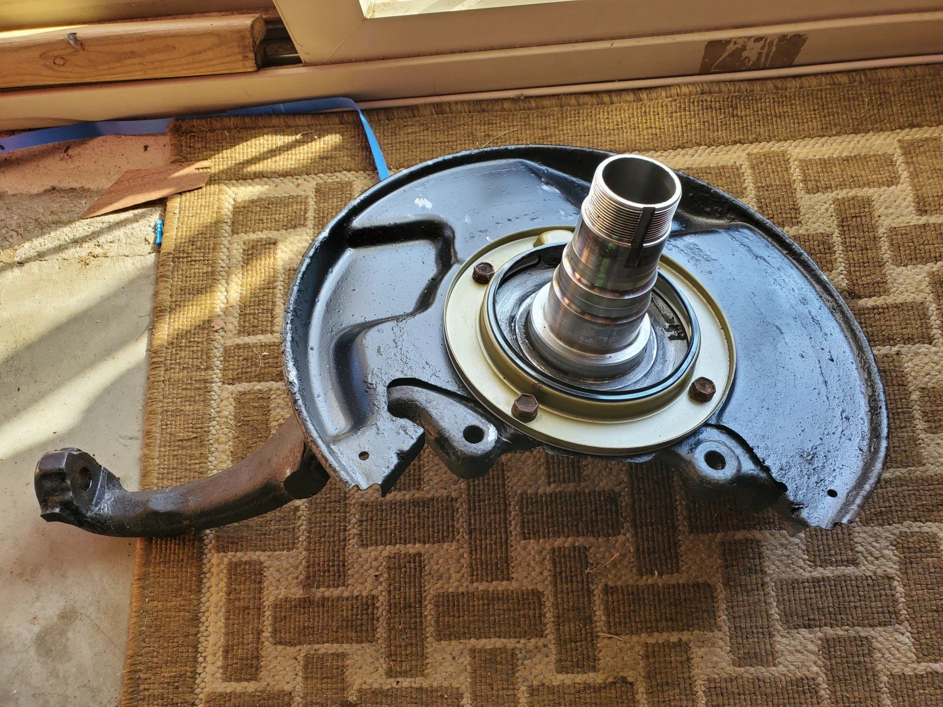

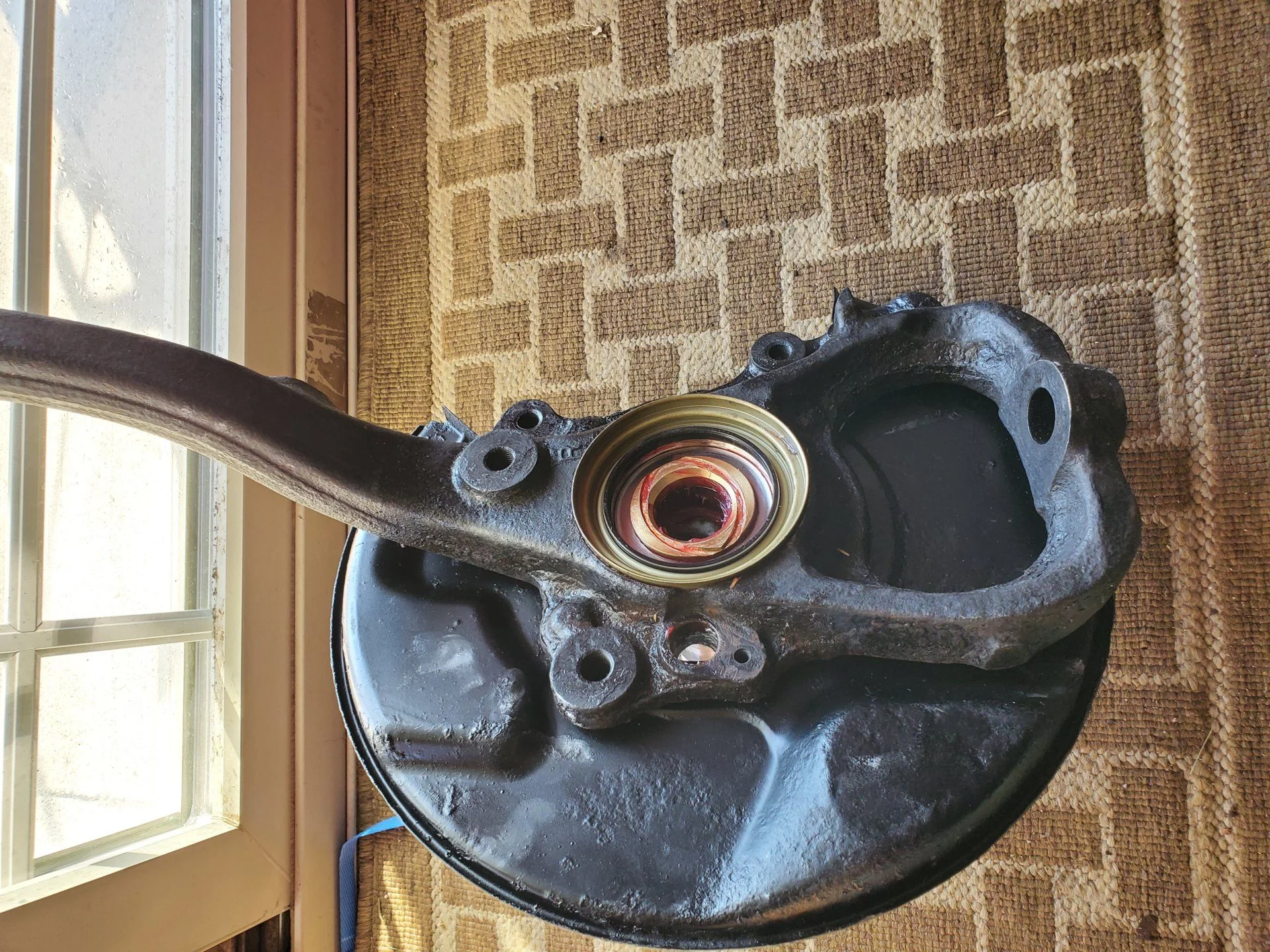

Installed fresh needle bearing and the shallow brass bushing. Pressed in new large seal and installed new oil seal with paper gasket. Knuckle is all ready to go
Cleaned up the hub and got all surfaces prepped for installation. Started putting on the new rotor and stripped one of the bolts :bang:
Tried a theeading tool to rethread the hole but unfortunately it is too large. What are my options here? A helicoil insert or can I used a grade 10 through bolt with a nut?
View attachment 2219681View attachment 2219682
Not sure about above, probably drill and tap for a size larger.
For this pic I would sand down, then smooth out (emory cloth) the place where the rubber seals for the ball joints will sit. With that surface clean and smooth it will ensure no water can get into the ball joints.
