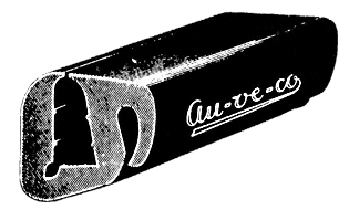

I'm not 100% sure but I think the later model hardtop and rear doors require an offset w/s like this from CRLaurence. Compare the size of the stock glass to the size of the opening in the doors and side glass openings. If there is not at least a 3/16" gap between glass all the way around the AS-1179 style gasket will not work. You can have a glass cut that will fit with the AS-1179 gasket but that will defeat you quest for cutting costs. Good luck.

Short answer on the AS 1179 on ambulance doors is no. The above is over /under configuration. Ambulance doors use offset type rubber.
As 1179 is sold in bulk 50' rolls unless you can get a glass shop to sell by the foot.
