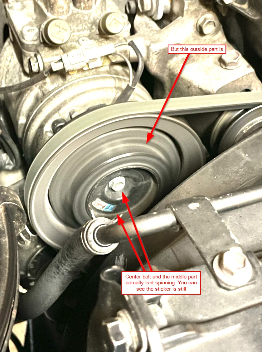

UPDATE: Took the truck into a mechanic to get an educated opinion
So the clutch is failing. The mechanic said the rubber is too lose to grab it. When the AC is turned on, the outside part spins (i mistook this for the clutch) and the middle part doesn't.
His rec is to get a new clutch or compressor. GL to me finding one.....

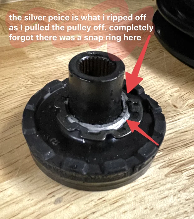

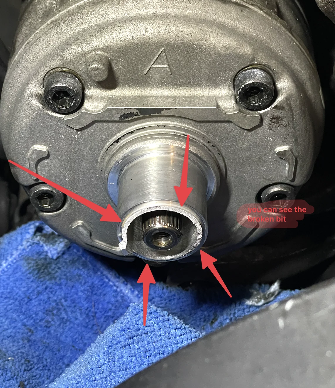

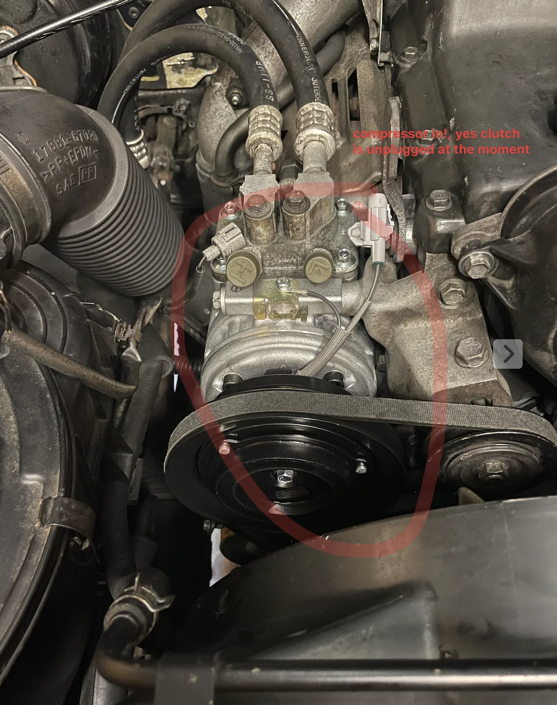

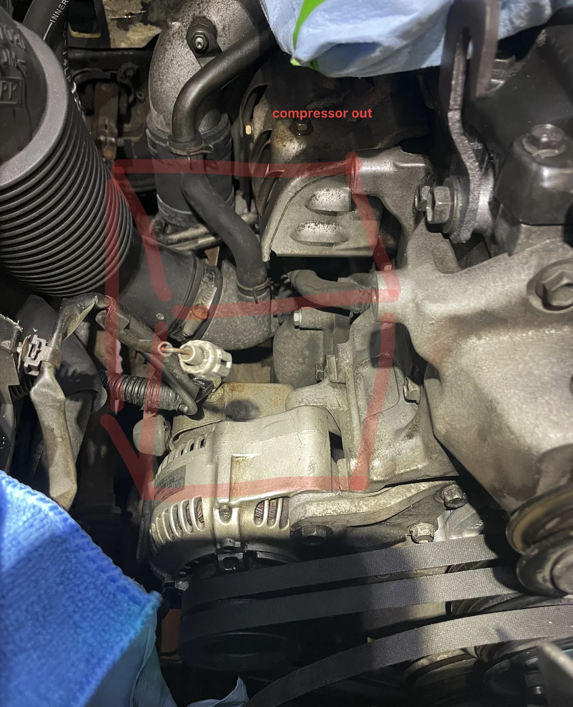

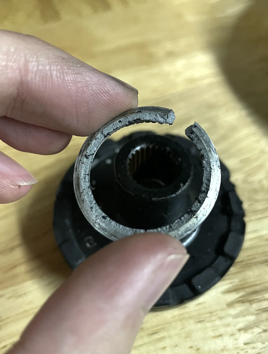

So... how screwed am I? I was hasty and maybe too tired when I did this job and ended up ripping part of the compressor off as I was removing the pulley with a tool :dead:
Pic's below.... Pretty confident I just made a $1k+ mistake, yay. As it is now, Im not confident the second snap ring will do anything now that the lip has be ripped off. Considering JB welding it on just to put the pulley on and have something in place so I can put the belt back on to drive the car.
I've already got an inquiry out to japan4x4 to hunt down a new compressor. The original piece is hard to source (fingers cross for Japan4x4), but it looks like 88320-35H92 is comparable replacement. Anyhow, wanted to share my mistake, get opinions and recommend people have their coffee before taking on any job even if its supposed to be simple...
