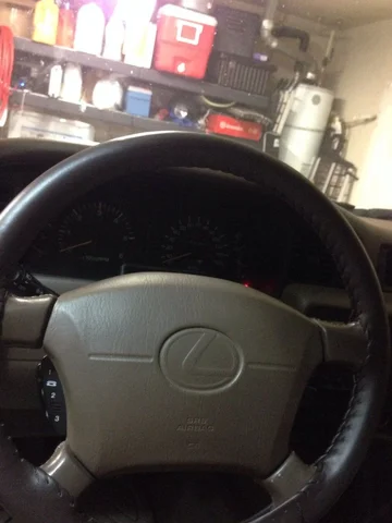

image.webp I just did mine with a wheelskins. I think both are great options. Mine had the leather tearing off the top and was getting sticky. It's actually pretty easy to do. Just pull it tight and pre streatch the thread. I chose the brown. The color matches the brown trim. The oak seemed too light and I imagine it would show dirt and grease faster.
Also, do yourself a favor and wear gloves. I wore rubber fishing gloves and cut the finger tips off.

It's real leather and not padded. The gray color is only a shade darker in real life, pics make it look charcoal. I really like the way it laces on compared to a Wheelskins.
