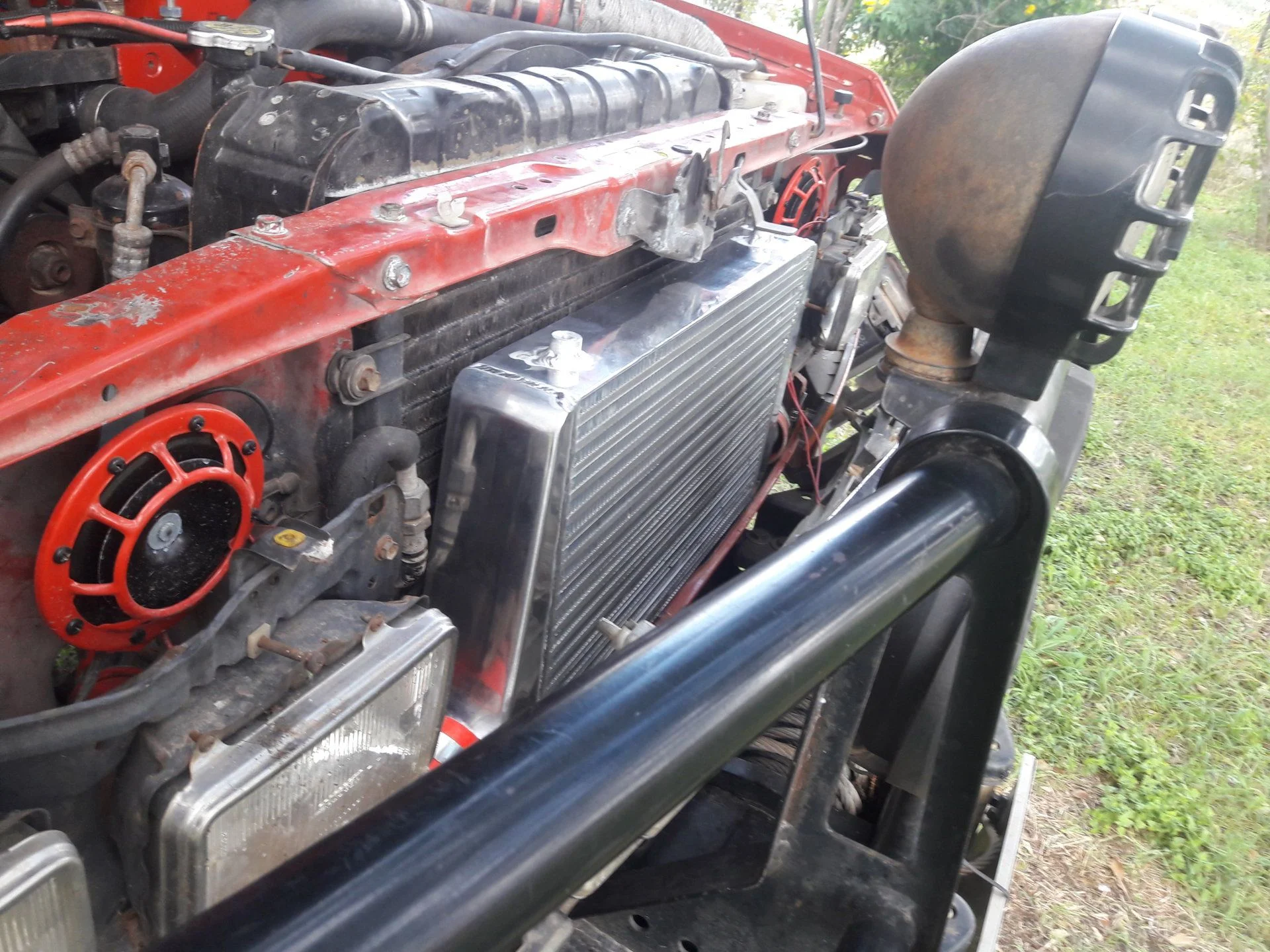

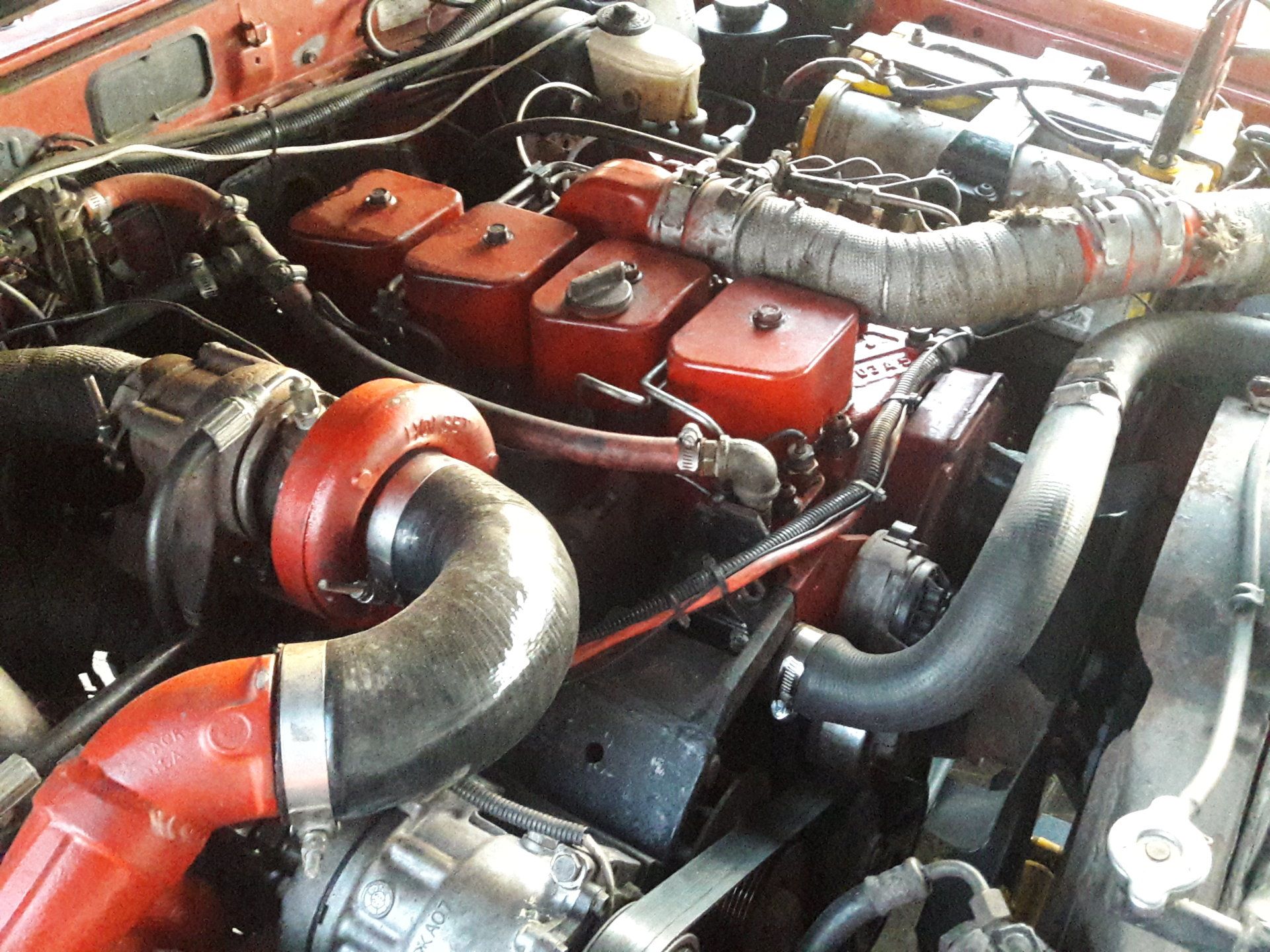

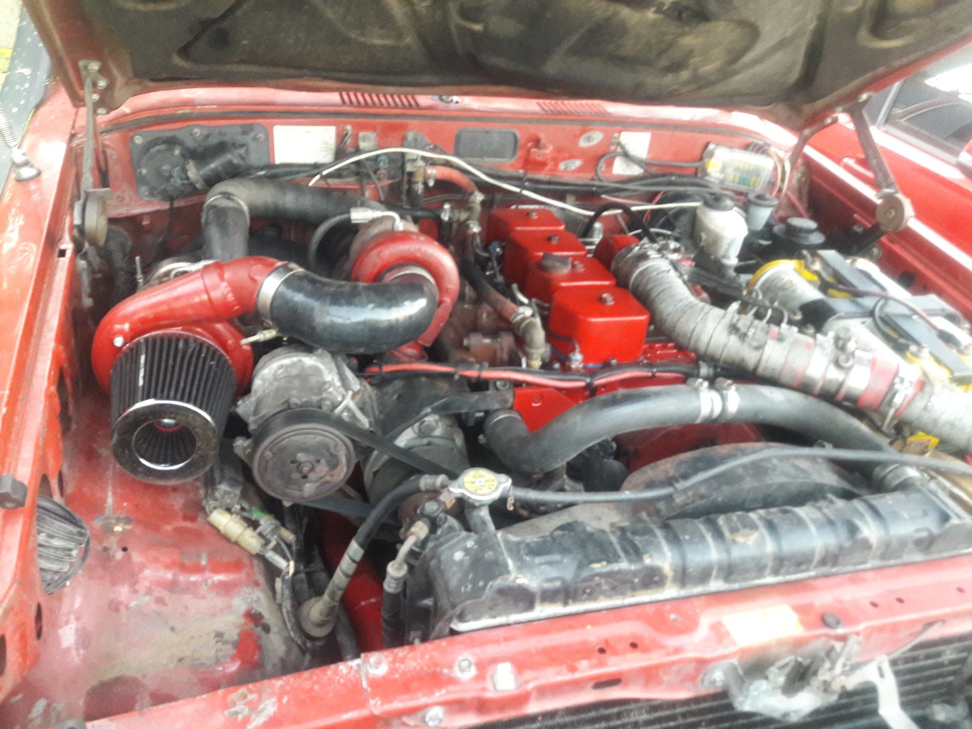

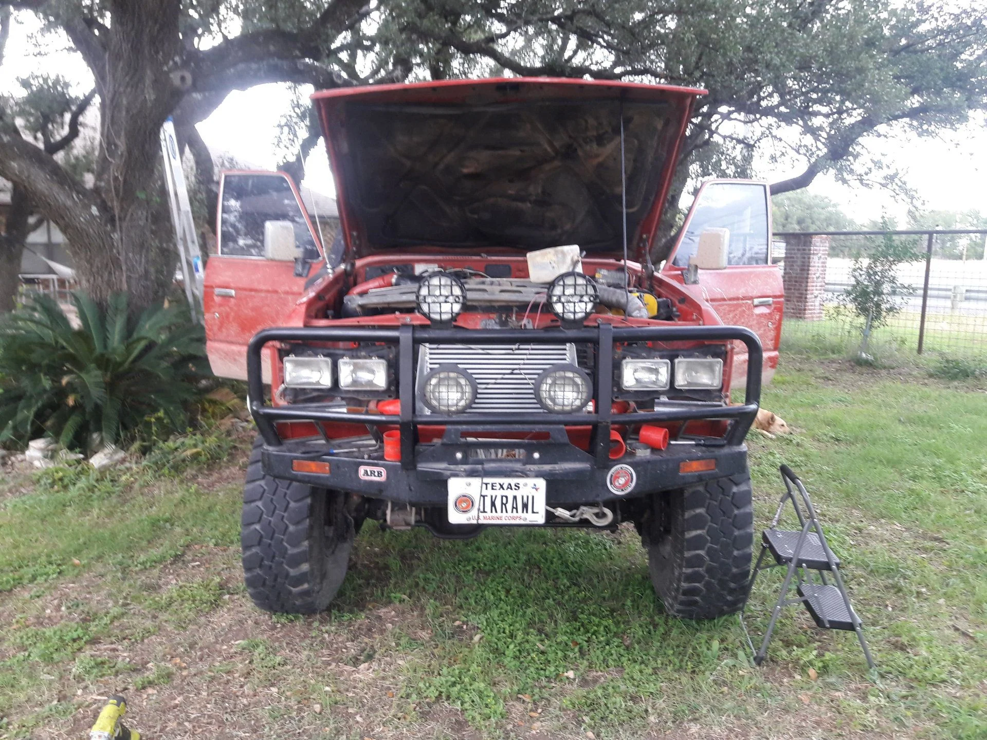

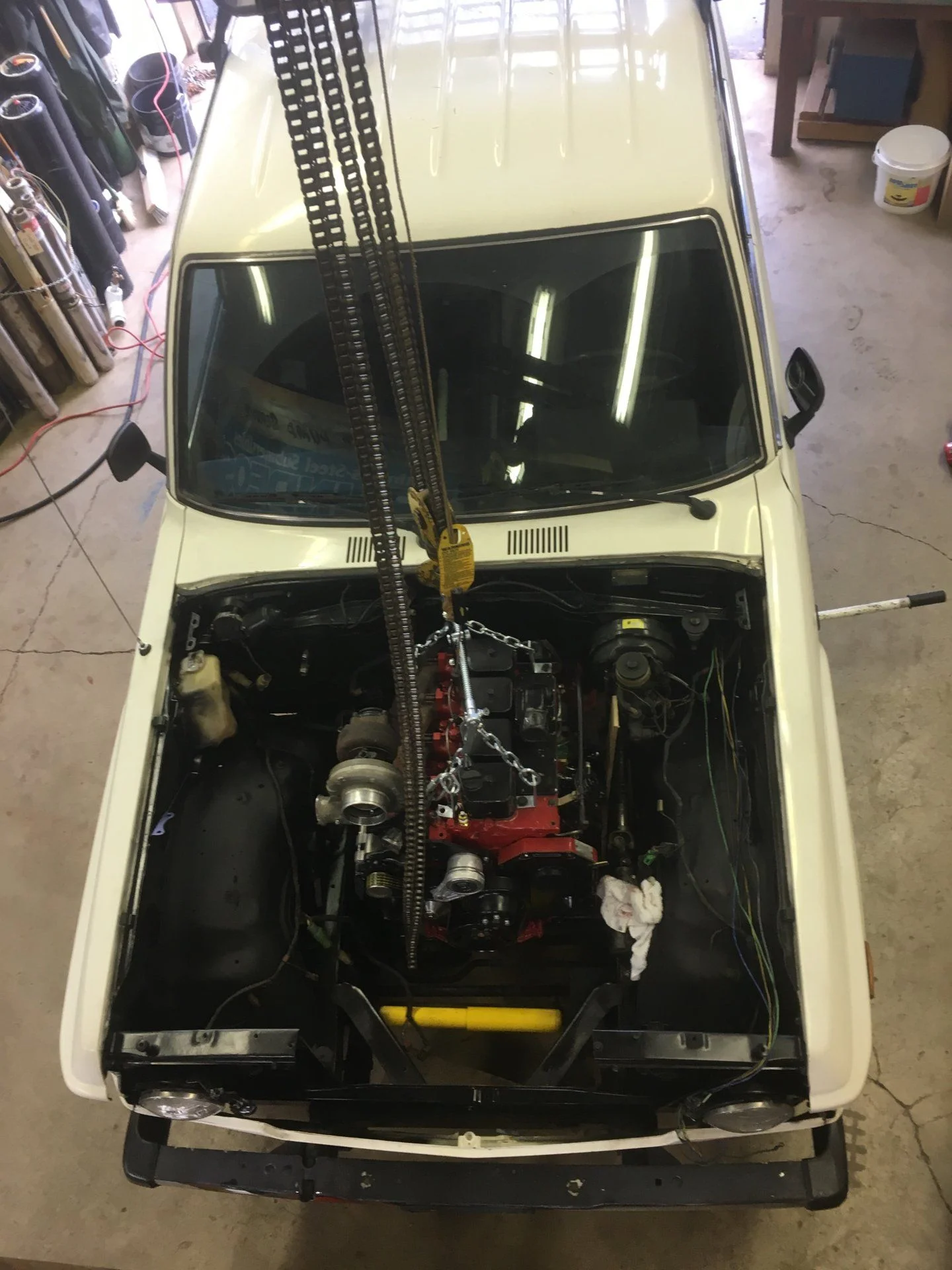

It may be my eyes, but it doesn't look like the hood would be able to close without hitting the turbo. Are you going to cut the hood and make a scoop for the turbo snail to fit, or are you going to mount the engine a bit low?

It's dark and rainy now, but I'll snap one or two pics as soon as I get a chance.
I tried sending you pics in a conversation but it's not letting me attach them. Anyway here are two older pics.
Mike
There have been a few minor changes since these pics were taken.
My turbo doesn't look any taller than yours. Do you run a NV4500?
it may have been the angle of the photo or my eyes playing tricks on me. Yes I run an NV4500 transmission . It's a strong tranny with easy to find parts.

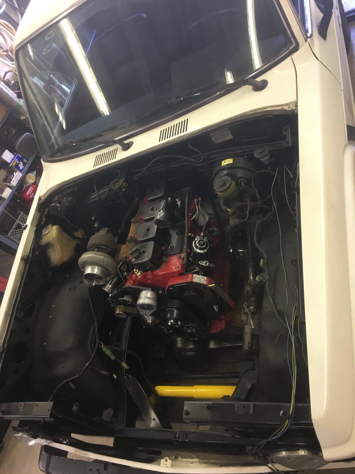

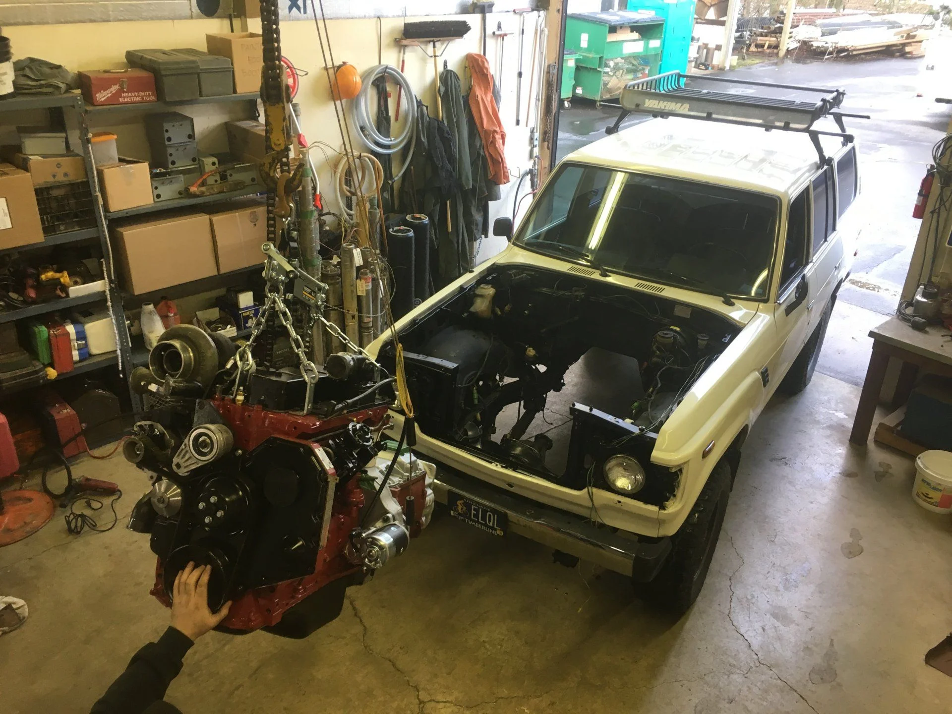

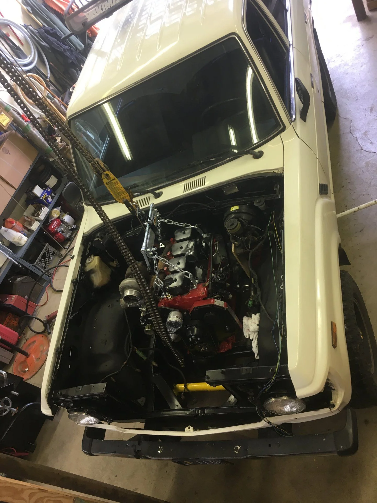

Yeah getting excited for the install. It's been such a bizarre winter in Oregon but has allowed me to focus on this build. Now snow is coming for me tonight into the weekend. Would love to be able to be driving my cruiser but I've just got to have patience. Perfection doesn't happen over night!
I used a 27x12x3 intercooler. It's tight but it will fit. I went thru several before getting the right size.

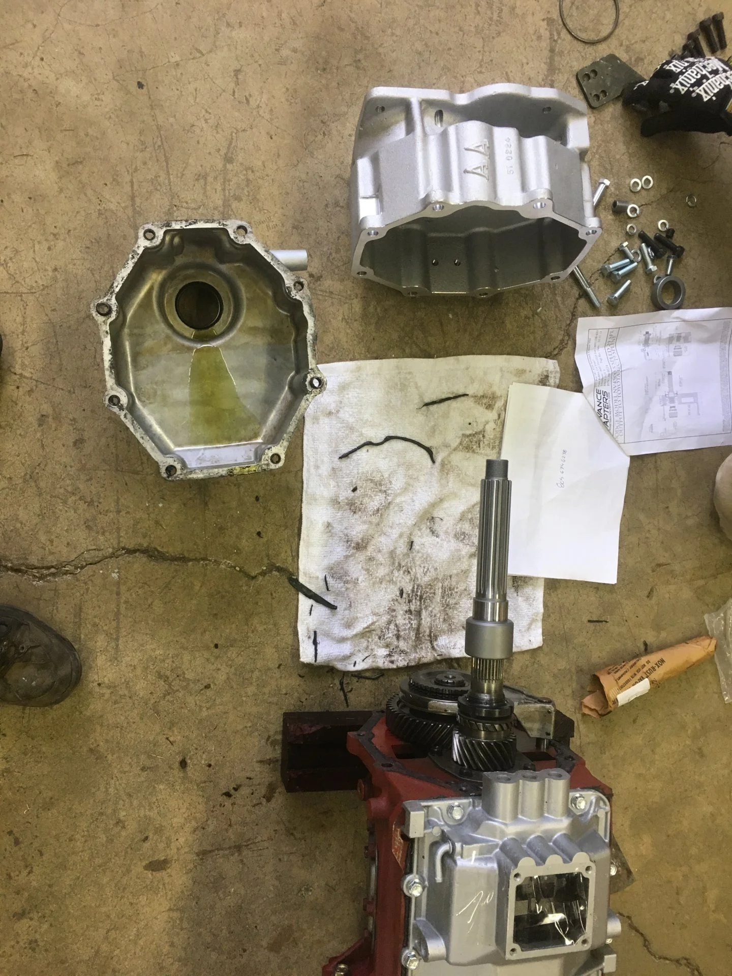

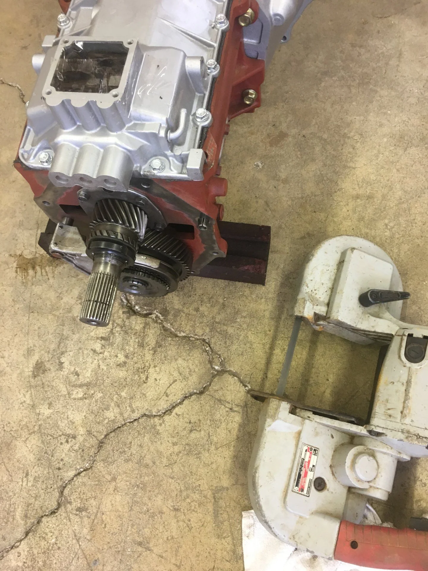

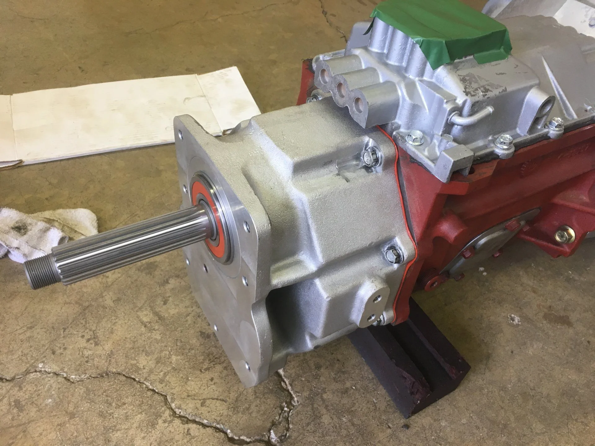

Started work on installing Advanced Adapters adapter between NV4500 and FJ60 transfer case and realized they forgot to ship spacer between bearing and housing. Called and said it'd be here Monday.

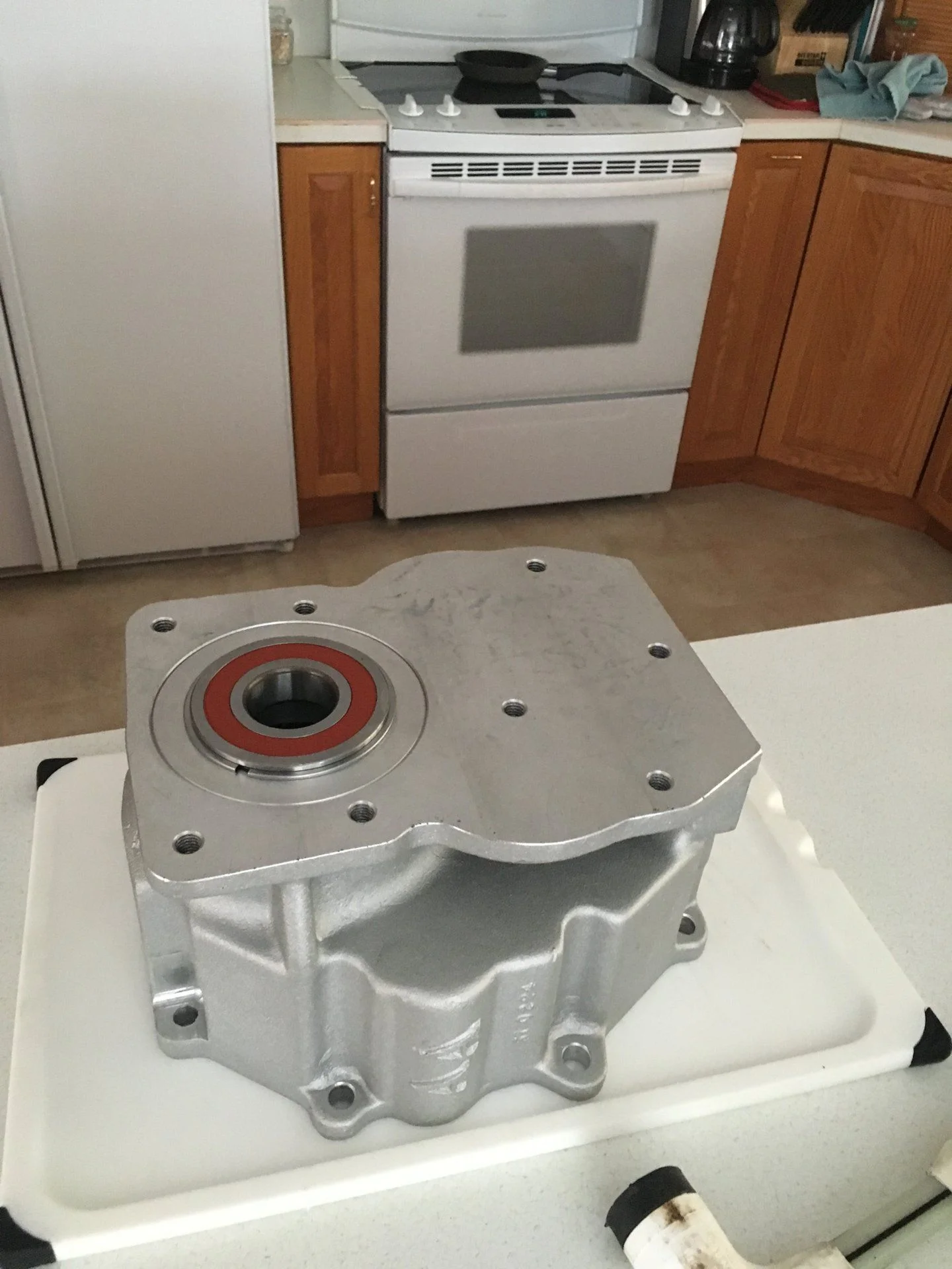

Apparently the spacer was supposed to be sent already in the AA housing. Today we found it was very tight. AA said to put the housing in oven and warm to about 110F. Got housing in oven and put spacer in freezer. Took out housing and spacer dropped right in. Next we were able to set the bearing right in. Depending on snow for tonight we hope to install the motor tomorrow.

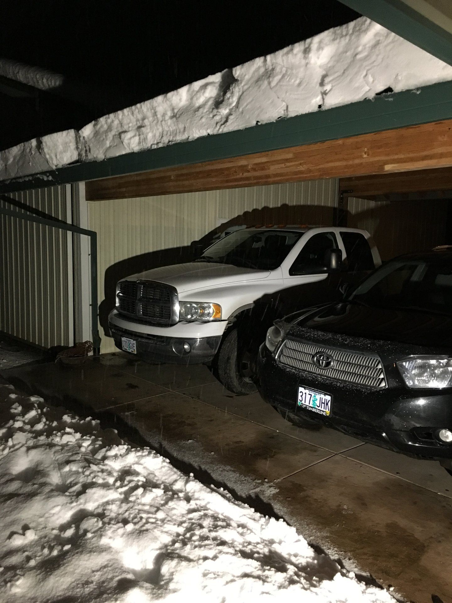

Damn, you got way more snow where your at. I only have about 3-4” up here.
That's 14" on my roof. I put the metal loc seam roof on to allow snow to slide and protect against wildfires. We put it on and Oregon Energy Trust gave us almost $2000 tax credit. I am a winter enthusiast and this past week has been awesome except for not being able to work on the build.
