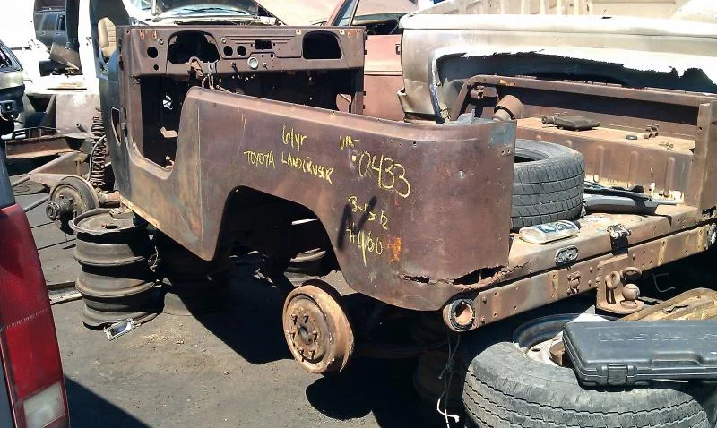

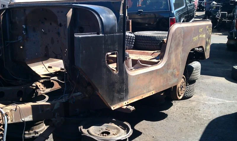

I found this 1961 fj25(thought was fj40) in the junk yard today the tub is in great condition two rusty spot on the sill and the rest was just surface rust...I saved some of the parts but most were gone. I am going to go back and try to buy it tomorrow they could not come up with a price, the axles were good and untouched the front end was gone both master cylinder the clutch and brake looked very different but they are toyota.

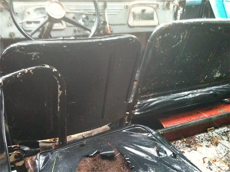

Would love to see the VIN on this one, it looks to be a very early '61. If you look at the dash to the left of the glove box you can faintly see 4 screws that would have held the tire inflation data on the FJ25 models. I have only seen this in FJ40's that were very early off the production line.

61 and 62 both were without a ashtray in the dash but you can see this one has the large gas cap opening. Just that and the gas cap are hard to find parts. Curious what engine was mounted into it. That looks like a very cheap home made motor mount on the passengers's rear.

Looking a little more closely at this picture it appears the VIN is written on the rear quater panel there...... so possibly it is 1-FJ4010433?? making it the 433 produced worldwide
I wonder if it has a spare gas tank with a skid plate . The rust on the rear seems to be in the corners more then the center if the sill. A spare tank skid plate protects the rear sill from the build up of dirt which holds moisture. The rear corners are easier to get to to wash and it has been my experence the center will rust just as fast as the corners maybe even faster because of a lack of cleaning.
I wonder what happened at the back end? That is what looks like what is left of the OEM license plate light mounted to the rear sill.:hhmm:

Don't forget the frame. But it appears to have piece cut out behind the passenger's rear motor mount. The steering box bracket has been removed as well. This poor thing has really been picked over. Most all the brackets and switches are already gone. It still has the brackets for second arm on the jump seat jumps. But I'm guessing the demand for those isn't to high.
I SPY: OEM safety chain eyelets on the back there welded into the hitch. B pillar lower soft top brackets. Clips for the tools on the rear inner fender. Soft top hinges. Warn coarse spline hubs. One tailgate hinge?
