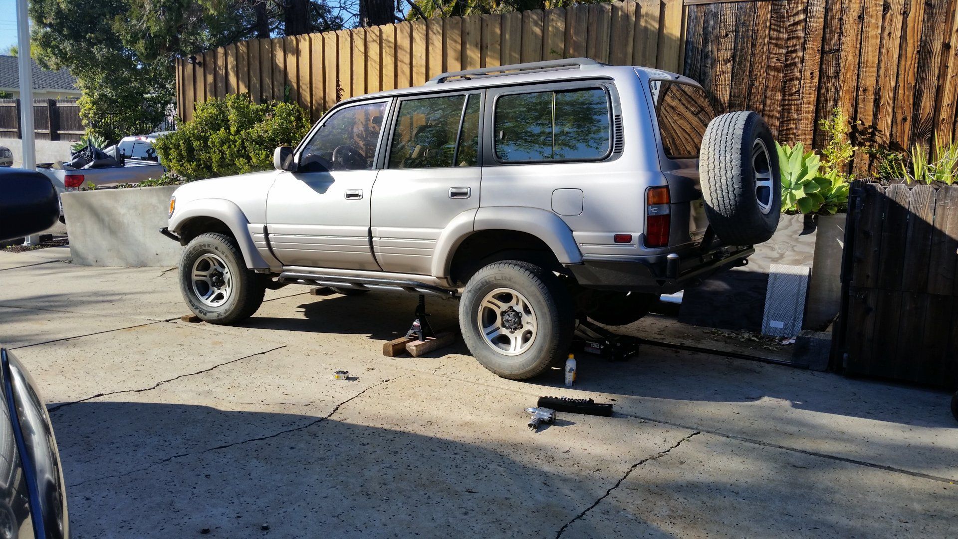

well, it took almost 6 hours to install the CDL switch, 5.5 hours of that was finding the dang thing. Anyway, sometimes things go well and easy, other times things don't go so well, like today. I was putting in the new rear springs when the truck fell off the jack. Luckily nobody was hurt (not seriously anyway), but if you've ever had it happen, it is scary and can mess stuff up. I tried lifting it with a engine hoist, but ultimately dropped the truck a second time when it flipped. Finally, (after some curse words and feeling like a total idiot for a while) I welded the base plate of my hi lift to a 2x2x3/4 piece of steel so I had a solid base and used a bunch of blocking to get everything sorted out...
time for some real jackstands. Glad you're not dead!
Harbor Freight 6 ton jackstands are plenty stout to hold up an 80. o_O
I kept raising mine and resetting my 6 ton stands because the truck would settle to one side first and shift the weight as I lowered it. So it kept sitting flat on one stand and not on the other. It gives me he heeby jeebies not having them sit flat. Glad you are OK.
I have some great giant jack stands, this was 100% user error aka, stupid head! I am glad I am not dead too. In general we only ask question like "is the truck ok" if people are ok. If people are hurt, who cares about the truck, its just a truck...Anyway, I started working on the front today, took forever to get the bushing pressed out, measured and pressed in, but alas, that is done.

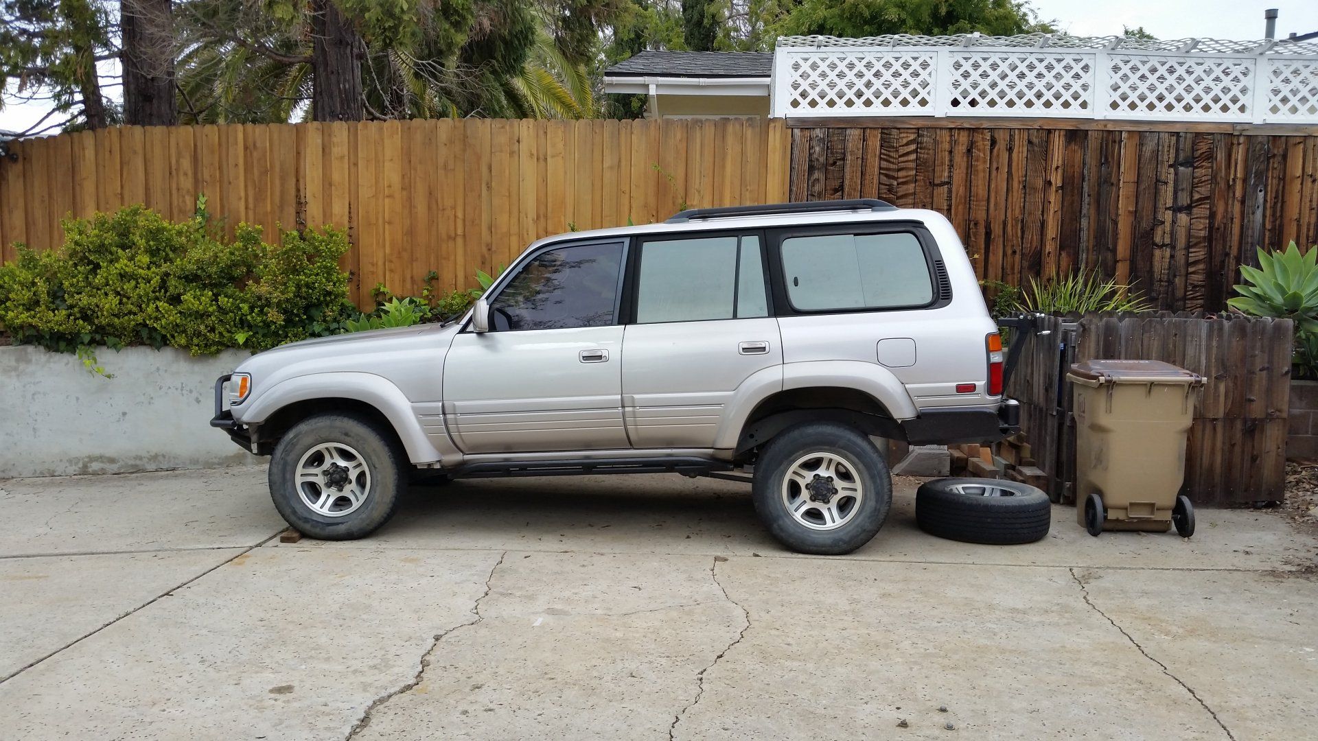

Well, the results of the first drive are as follows:
1) Ride quality is better - need more testing on more varied terrain, but driving around - Thumbs up
2) Sway and boat like symptoms - none, I did a little swerving and it was good
3) Brakes with the 35's - OMG, I need to do something as it did not stop particularly well before, but now it is just a big rolling tank of doom!
4) Driveshaft vibration - None so far, I am going to do a few more tests today and if the results are the same, weld in the washer mod as it is just bolted on right now.
5) Did I mention the stopping - Unrelated to the lift directly, but lame none the less. Powerstop, DBA, opinions?
