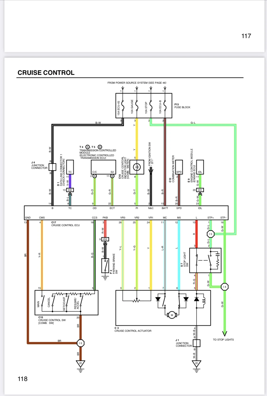

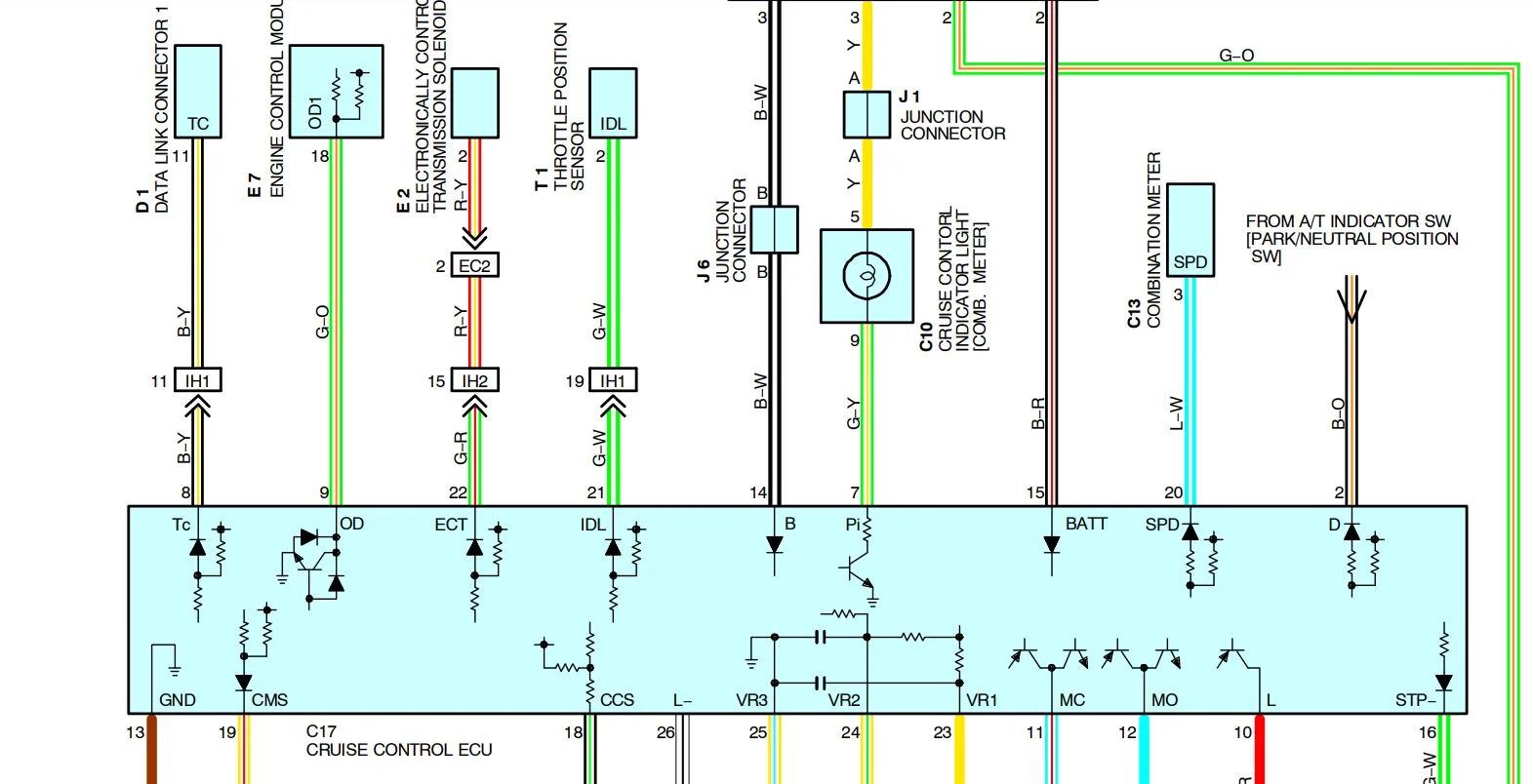

The signal comes from the cluster. See below pic. The cluster signal comes from the transfer case.
EDIT..I'm assuming its a 96-97. The diagram is 96
I'm assuming somewhere down the line it goes through the ABS computer. Because if you have the cruise control on, and the ABS engages, it kicks off the cruise. Right now the truck thinks that it needs to engage the ABS because two of the wheel speed sensors aren't reporting back

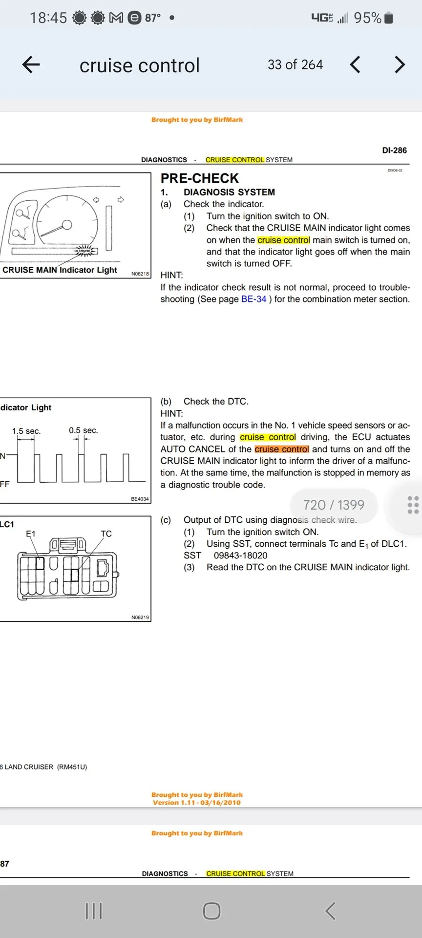

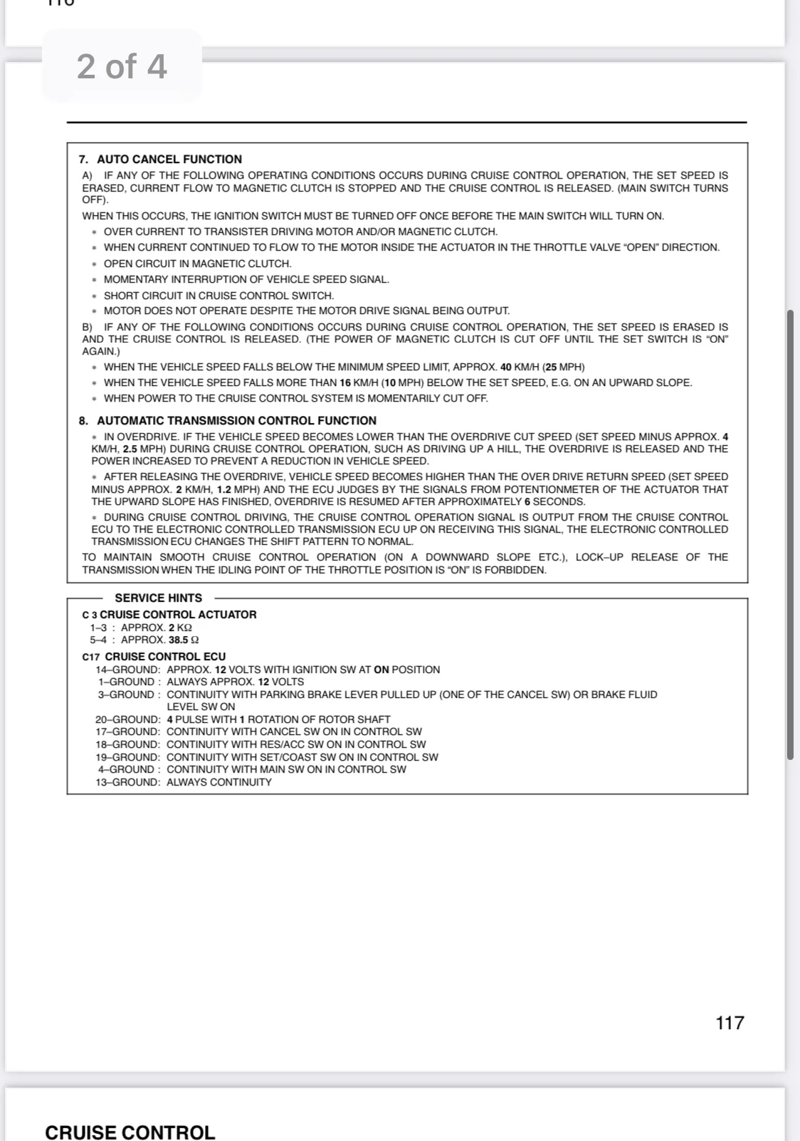

Found this in the 96 fsm, states if a wheel speed sensor fails it will cancel cruise which is where I am. Unless I'm reading that wrong.
Might want to read that again.
It doesn't say "wheel speed sensor", it says "No. 1 vehicle speed sensor".
The #1 VSS is located on the transfer case. It feeds the speedometer which, in turn, generates the speed (SPD) signal used by the cruise control.
