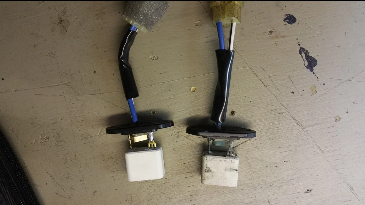

I found out that since the blower only works on highest and lowest setting, its probably a fried blower-resistor 87138-60220
But after opening the glove box, I saw that my car has all parts for an automatic ac, which doesnt use the 87138-60220 but the 87138-60230?
But the 87138-60230 from the parts catalogue I have in front of me should only have been used in the 97 40th anniversary Edition?
Can someone clear this up for me? Is the catalogue wrong and it's a standard part also available in a standard 96?
Also - I could not find a single seller for this part, is there any other part number available from Toyota/Lexus that does the job?

Just curious, but the current blower resistor you’re seeing is this one here, instead of the one that has the part with the pigtail connected to it?
Hey!
Yes exactly, I also found a replacement part in a different Thread which I just ordered from carid but I'm still wondering if this should be in my 96 :cautious:
