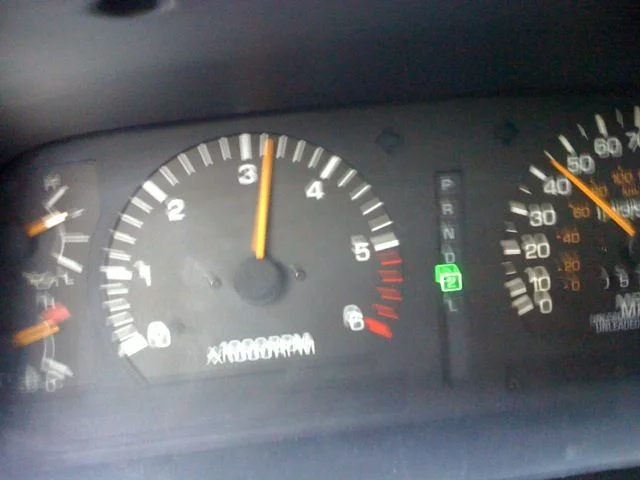

RavenTi,
First thanks for this thread and the latest pictures.
After temp gage was modded my temp gage during long uphills sits just bellow the red line.
There is a 1/16" of black between the red and the needle.
Can your setup show what temp it is?
Also what is consider normal hot, I have a good cooling system with many new parts and modified blue fan clutch. So I have got to assume that on a long climb this is "normal" hot.

Rami, your truck is asking you to shift out of 2nd!
:cheers:
Steve
nah,
This uphill I am towing my motorcycle and the truck has a hard time in D. Although I give up speed, I just put it in 2nd and 3500 RPM and enjoy the scenery. What's the rush? :-)
Besides, on that day I had two days of speed coming up, another reason not to rush.

Well apparently I have done something wrong. After the mod my gaugue acts as I would expect as it sits just above the half way mark but when it starts to get a little warmer it will move up to have the top of the needle just touching the red. According to the pictures posted this should be around 217. I bought the rig last year in October and replaced the radiator, hoses and thermostat with OEM parts and flushed it. I was planning on flushing again in a year since I have no PM records from the PO. After I did this mod it looked like I had a heat up problem so I changed the fluid in my fan clutch (thanks Tools!) and bypassed my rear heater and replaced the PHH and hoses at the top of the engine with Samco hoses and the tension clamps and flush it. Take it for a drive same thing.
With the needle that high the engine was hit with the hand held temperature gauges and the first time it was 192 and the highest reading was 198. That is not bad at all when we are in a Heat Wave warning in Arizona.
Obviously my gauge is off. Any ideas what would be wrong? You can see in post 377 the value resistors I used.
