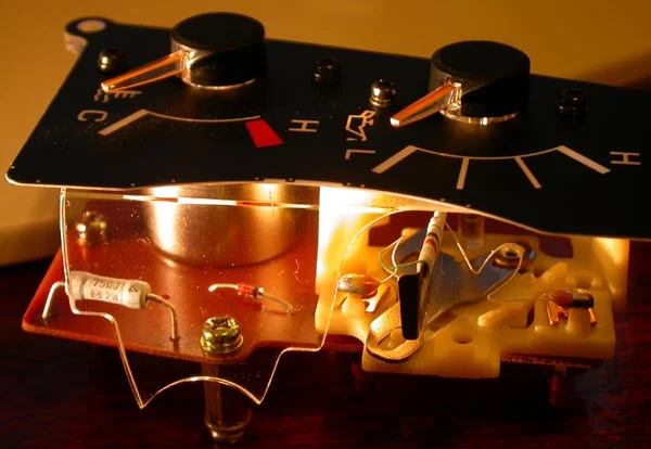

here are some prelim pics of the gauge "before". Note that the oil px gauge is melted and something is broken as the post that connects to the needle is not connected to anything at all.
If anyone has pics of how a functional gauge looks, I'd like t see them. I'm going to fiddle with it a little to see if it can be made to at least sorta work. Ok, pics (click for larger):
This is a gauge from an hd-t cluster. The motor is 1993. The cluster is of unknown year. But definitely from an hd-t as it has the 2 turbo lights and no gear indicators (ie: from MT). I think it is a 93-95 cluster as the newer hd-t clusters have only 1 turbo light for overboost, not the nifty green light for "you're now boosting!"

the charring of the PCB near the R1 resistor shows it got very hot, that could be an indication of an engine overheat, as the sender gets hotter wattage disipated by resistor r1 increases, sharply so at high engine temperatures, another possibility is that the gauge is not right for the trucks wiring or engine, that could explain the oil pressure gauge melt down.

Before I cut the legs off
all finished
