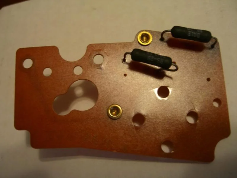

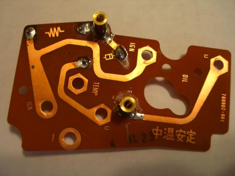

I just did this mod and I kept thinking there has to be an easier way to remove these components and solder them back in. When I had the gauge in my hand I seen this was only a single sided printed circuit board and was held to the assembly by 6 attach points. I removed the hardware and had just the board in my hand. Makes this much easier to work with "however" the 4 nuts holding the board to the back of the temp gauge has a metal housing that will slide off the internal winding so just hold that with one finger, remove the board and you can sit it on a surface until you are ready to assemble.
These are pics of the board from my 93 fuel/oil cluster and one pic I modified that has been shown on here but I added labels.

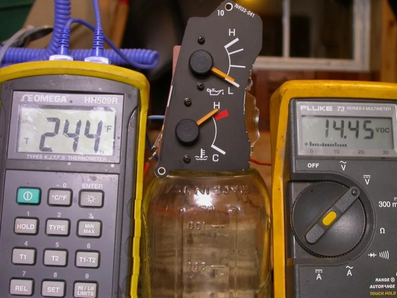

With those resistors the bottom of red should be about 217 and the top of red about 226 this corresponds to the AC kill range, pegged hot (mechanical limit of the needle beyond the red zone) is 244, specs for the AC kill switch are shut off at 226 and come back on again when it cools to 217 (I have not confirmed these by any test just as speced), so if you are in the red above 217 bu do not exceed 226 the AC would keep running,
The 97 gauge from a scrapped LX and the gauge from my 96 LX both agreed with the above, on the 96 and up we have gotten OBDII confirmation that these numbers are reasonably accurate, but Semlin sent me a 93 gauge to test and
we have a bit of a wrinkle, it came out a few degrees cooler, it was not a significant difference and I do not know if that was particular to that individual gauge or a slight difference for all 93 gauges, they are a different part number but of very similar construction, main visually apparent difference is one moved mount post to fit the 93 cluster.
Pics for Semlins 93 gauge on test bench after mod :
