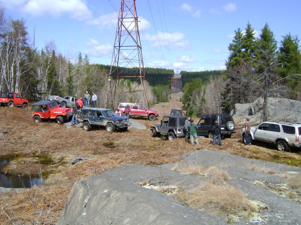

Finally got out last sunday and a bunch of different rigs showed up for a change. Only 3 heaps, thats some kind of record. No I didnt take the van, it still needs a couple things...

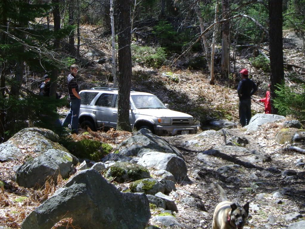

4runner sway bar link snap.

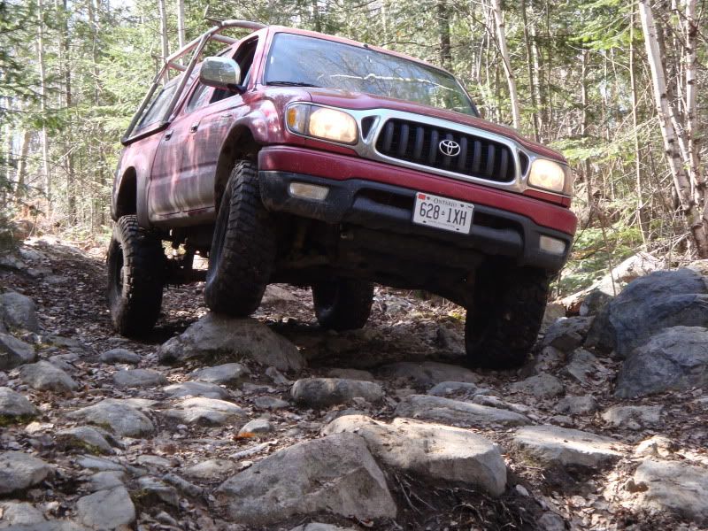

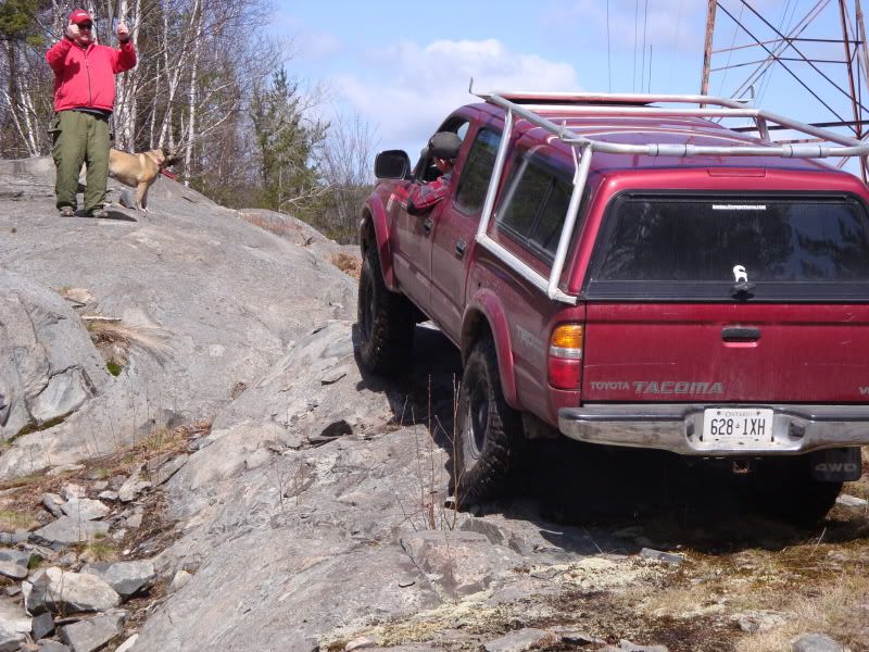

Then he stole my truck.

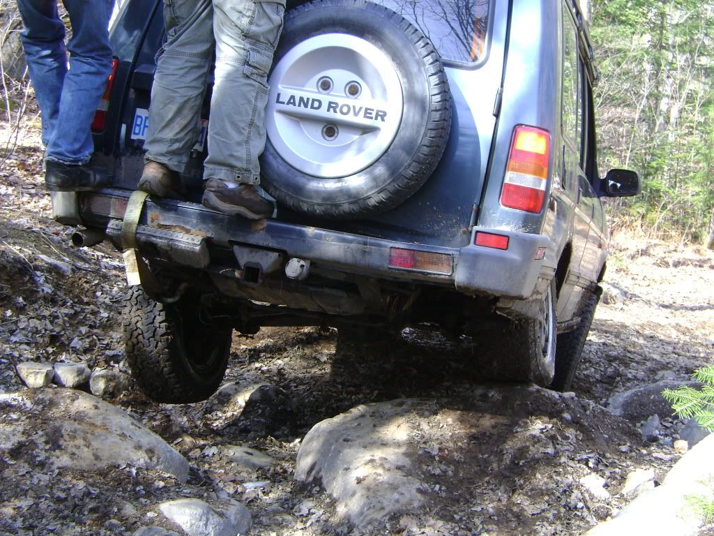

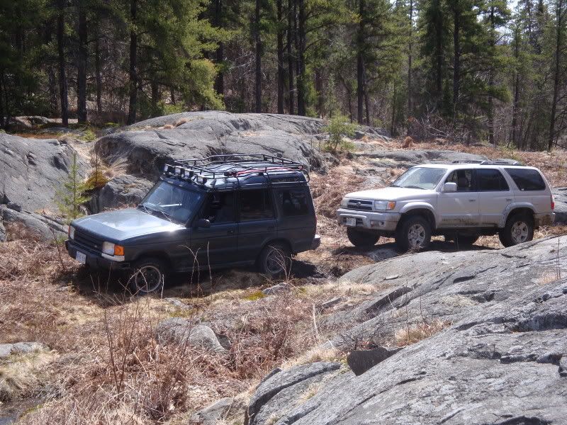

Rover.

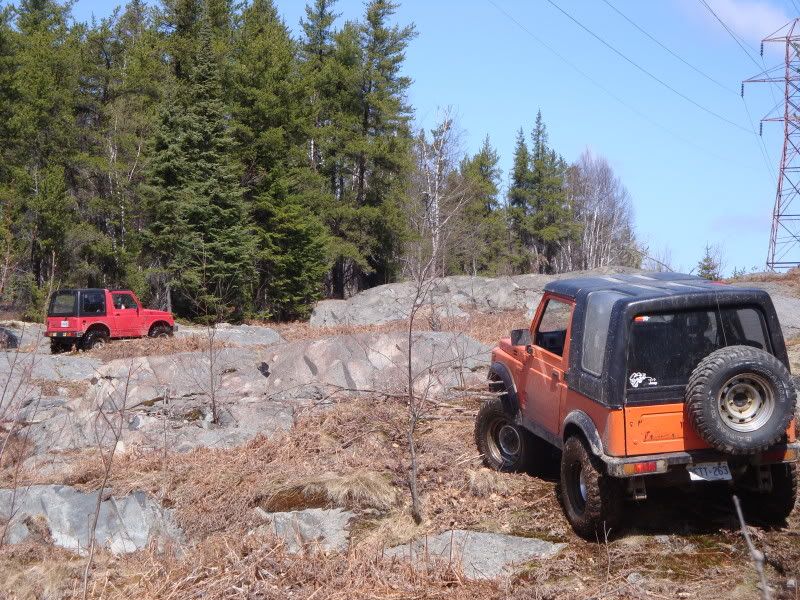

The twins

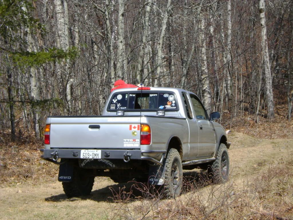

Nope the 80 sat that trip out. It still needs said lift and some xfer protection before it goes out. I was piloting the silver xcab taco.
