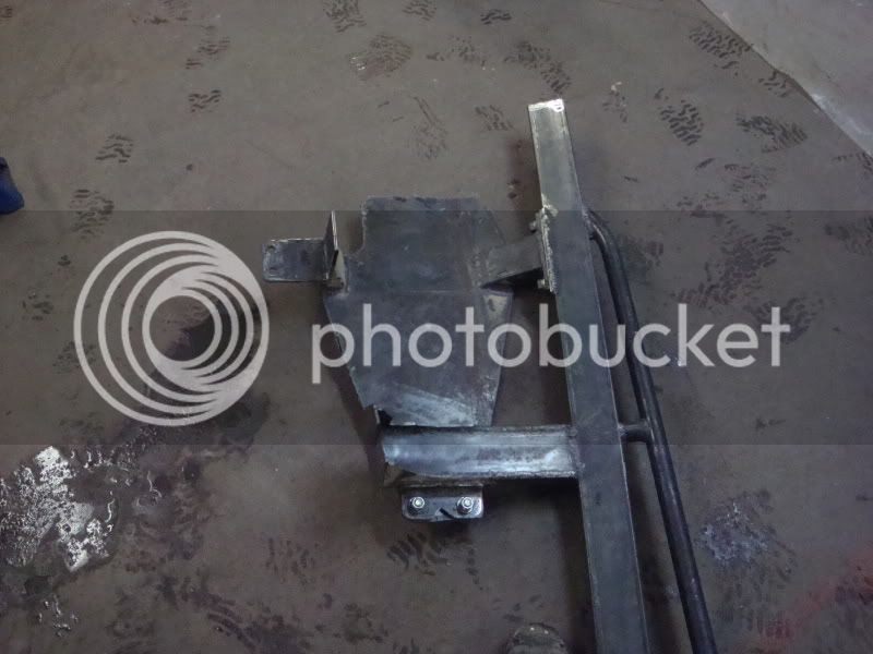

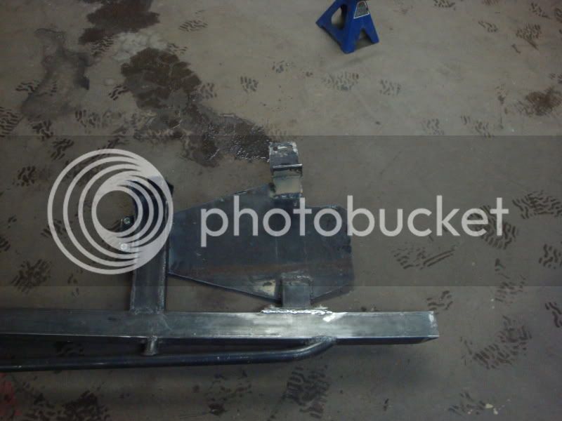

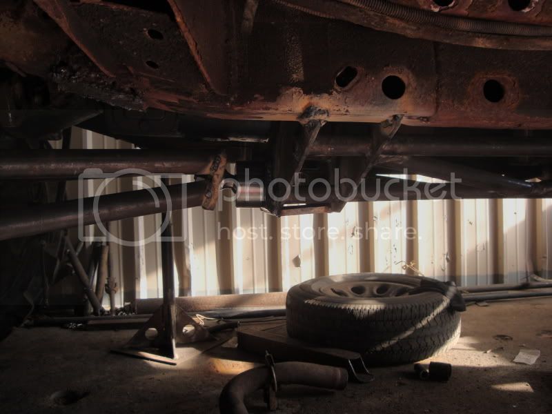

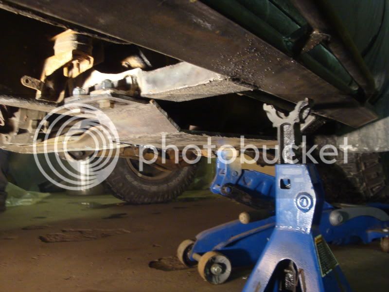

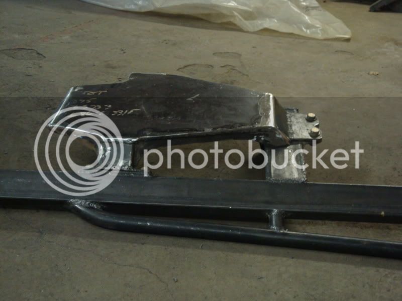

Well I finally tackled that pain in the ass cat outrigger/skid. Pete came over to lend a hand and all in all things went smooth.

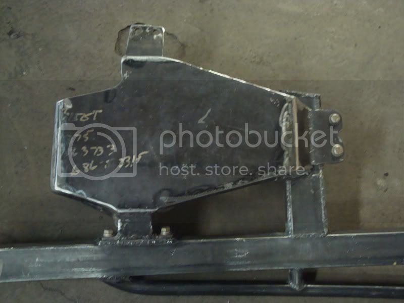

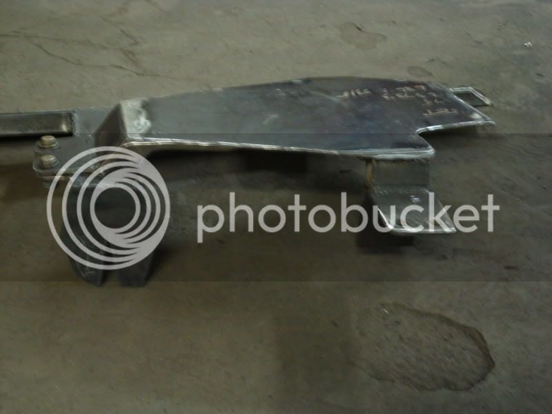

We used a combination of magnets, jack stands, and jack to position everything then tacked the 2 tubes onto the brackets. Next we used a level as a straight edge and marked the cuts for the skid. The skid was cut out of 1/4" and trimmed as needed. Ended up with a cool coffin shape, not that anyone will see it. Its held on by 6 grade 8 bolts/nylock nuts.
Its a heavy MOFO and some speed/drainage holes are in order.
Still have to clean it up and do some creative gusseting..... Heres what it looks like so far.
Gettin there.
D
I would gusset/triangulate every single mount point you have on there. I have bent 1/2" plant w/out gussets, but 1/4" plate has help up on the same impacts w/ gussets. Just triangulate those mounts. it's a small effort you WILL NOT regret.
PK
If youre referring to the skid portion of the slider, damn straight Im gusseting. I learned my lesson w my budbuilt belly skid on the Tacoma.
I was torn between stickin a tube under there or the flat plate. When we had the "down" tubes positioned and tacked it became obvious how much more ground clearance the plate would offer. Theres a little more than an inch between the exhaust and the skid and 13" from the bottom of the skid to the ground.
The plan is to gusset the perimeter of the skid, from the outrigger to the "down" tubes. I also plan to laminate a fancy piece of 1/4 on top of the skid... Does that make sense?

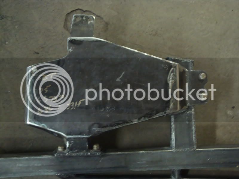

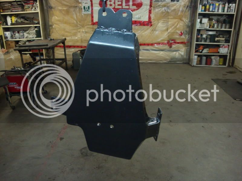

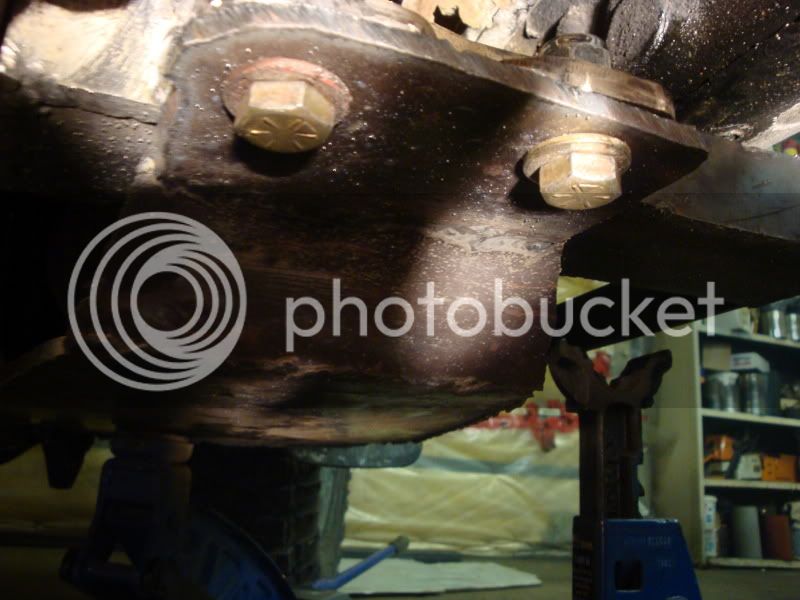

Got a bit done this afternoon. Cut out some gussets and welded them on then did some grinding. Its starting to take shape but its also gettin heavy. Some strategic speed holes may be in order.
Oh and dont make fun of my stupid lookin gusset thing. Tried to get fancy then said screw it.
D
Finished up then painted everything. My head hurts.

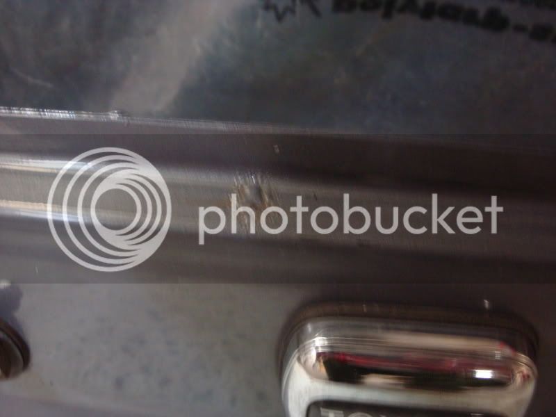

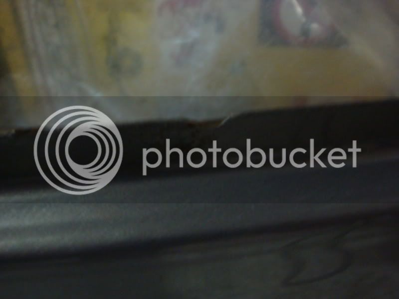

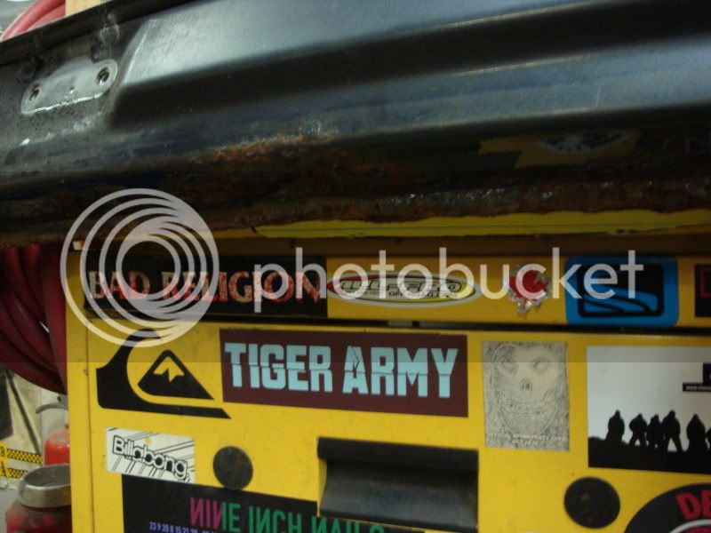

Yep, its a little nicer than mine. Couple little rust spots around the window lip but they are tiny and easily fixable. You can see how/where the rust starts on our hatches.
The bastards managed to bend the bottom ps corner a little during shipping even though the mudder I got it from packaged the crap out of it. Again easy to fix before paint.
The seam that starts to rust if your window leaks.

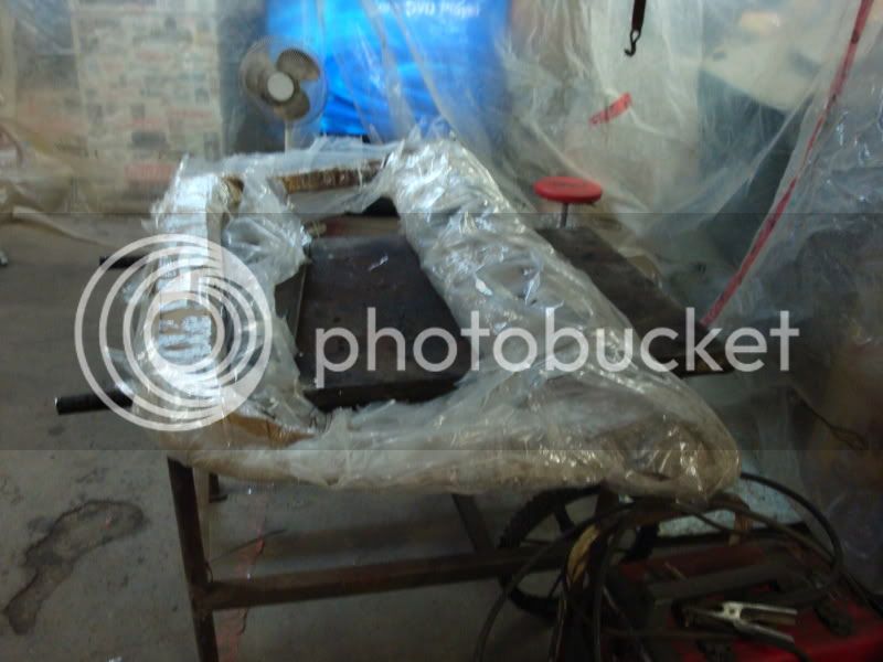

I removed the rear wiper motor/linkage, the key fob, the lower seal, the toy emblem, basically stripped it down for paint. Also managed to bend back the corner that got bent during shipping. I got frustrated trying to remove the rear squirter deal and after taking a close look at the outside handle, quit before I started breaking things. Mud told me how to remove the squirter and its pretty well the last thing Im taking off before paint. I also found out the handle isnt removable/reusable so Im just going to mask it off instead of messing with it.
One thing I have to figure out is how Im going to hang this thing when I do paint it. I have some bolts laying around that are the same size as the hinge bolts so Im thinking of using those as anchor points for some bailing wire. Ill figure something out.
Next step is to remove all of the emblem tape, clean up the little rust spots, then sand and sand some more.

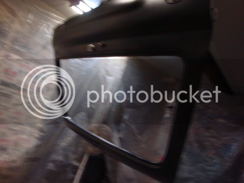

Fast forward a couple days and I have a painted hatch.
I got rid of what rust there was, primed a little and hit it with some blue slate metallic followed by cc with hardener. Turned out half assed.
I reassembled everything today and took the time to anti-seize all the bolts. I put a coating of grease around the openings for the squirter/lock/wiper ect. to hopefully ward off future rust issues.
Still have to clip on the seal and eventually swap hatches/windows/trim but Im one step closer now.

We welded on the sliders today and surprisingly it was uneventful. I guess thats a good thing.

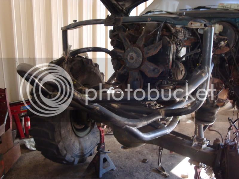

Couple pics of what my buddy Sam has been workin on at his shop. The raider is sweet but the ram is freaking wild.
Thats the story.

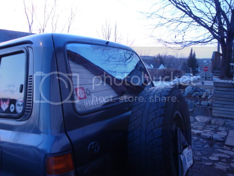

Manned up and put the new hatch on today. Had to paint the 3rd brk light bracket, did the wiper arm while I had the paint out. Window swap was pretty simple. Turned out mint.
Some pics of the old cancer riddled piece of poo. Wow.
