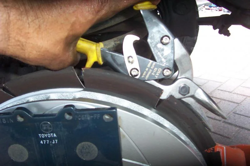

Ripped into new rotors,calipers and pads yesterday under the hot sun.
Gotta say it's always eaiser the second time.
Of course the supplier only shipped three front pads, but luckily I had an extra set of bigger, thicker bad boys...
Have to love the tin snips, made a few cuts and 15" dust shields fix 16" rotors.
