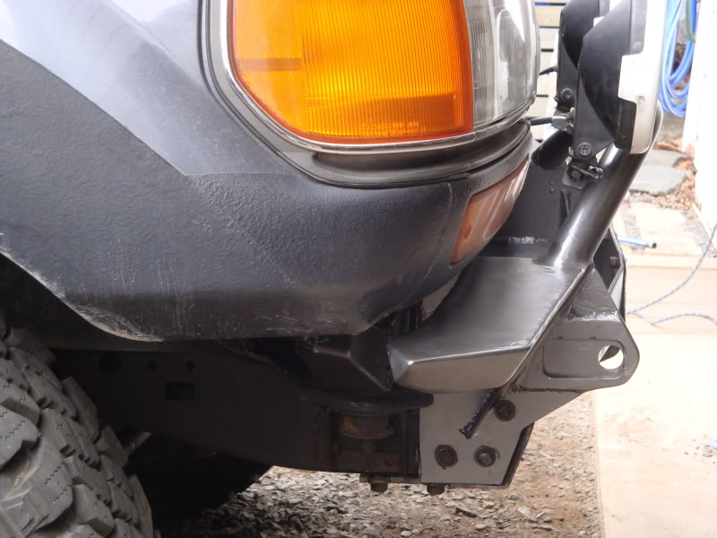

Trimmed the rad mount/apron/inner wheel well today. Wasnt that big of a deal and it turned out pretty decent.
After marking cut lines then removing the front bumper I drilled out the tacks that join the lower support to the apron sheet metal. With the support free I used the plasma to cut a v notch in the lower support. I guestimated and took out 1.5" of material. I then realized I only needed to take out 3/4"......
Before bending the support up into its new position I cut off the lower part of the inner wheel well as well as some of the apron sheet metal. I bent the support, tacked it into place, and painted everything black.
Havent tried fitting the bumper back on yet since it desperately needs a repaint but Im sure itll look a lot better than before.

I had to go back to page 2 to see what the gain would be with the bumper installed. It looks like you'll have a pretty high clearance front end now.
mmm......... Duratracs
Ever since I put the bumper together the crap hanging down behind it has bugged the hell out of me. Whatever extra clearance was gained is a bonus.

Nice work. I just hacked mine off along that same line so it followed the lines of my bumper. Didn't even occur to me to v-notch and bend :D
Thanks guys.
Nay, I cant take credit for the notch and bend since I got the idea from another mudder. It sure was fun though.

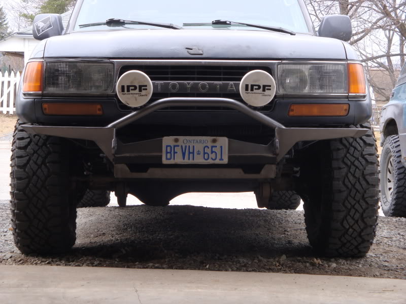

Looks a little better.
Got to the roof rack holes 90% done today. Gonna paint the black bed liner patches body color tomorrow and that should be it.
D
Not just a "little better."
Those are some sharp lines! Very clean. Probably adds 20 kph to the top end...but what really counts is the approach angle.
:beer:
Before
After
I got tired of searching for a before shot too...

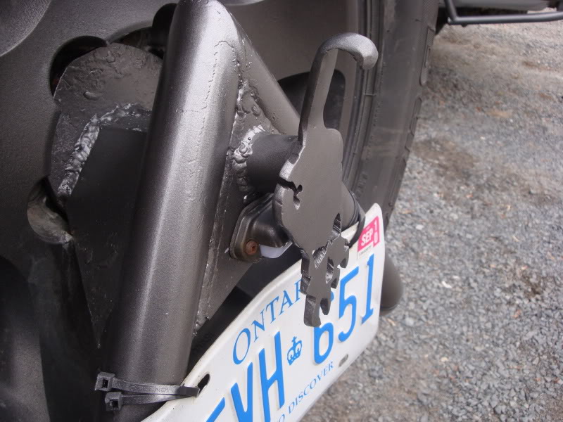

Well ive been messing with the van for a week straight. Did the apron cut, gusseted/cleaned up/repainted the front bumper, redid the roof rack hole patches/plugs, cleaned up/repainted random spots on the body and cut off the spare tire xmember.
Oh and a good buddy stopped by and convinced me to mount my "custom" bottle opener. I still dont know if I like it there.......
I wanted to repaint the rear bumperettes and tire carrier but got tired of painting. The van does look a little better overall now.
