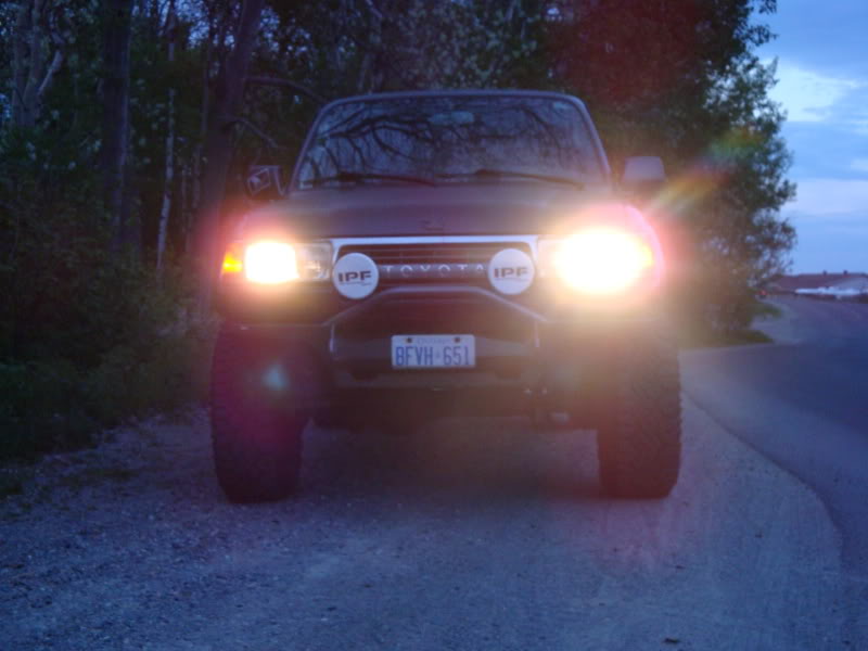

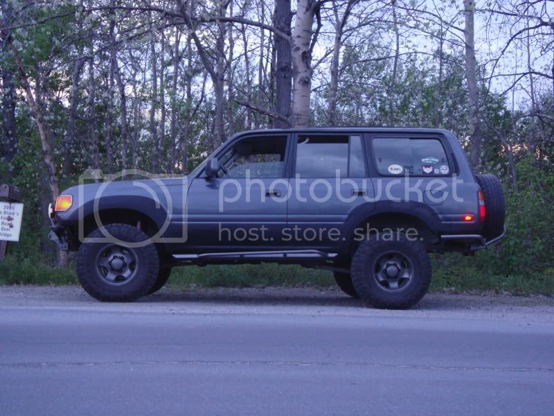

Heres some daytime pics. It seems to sit about as high as an f250 for what thats worth.

Those aren't OME medium rears with that much lift :hhmm:

With the pic, I'd say it looks good. If I end up there front vs back, I'd be happy...
Except I forgot to mention is that I'm tending toward the "stock" height coils. I'm just not sure that I'd be able to get it in the garage with 2.5 plus 33" tires. I'm going back and forth between put the lift on it and seeing how close it fits the garage or buying the tires first, then seeing if the lift will fit. Not sure either approach is ideal or maybe I should just breakout the sawzall and an I-beam to put a lift on the garage door?:confused:
Anyway, hijack off, your ride is looking real good now, "complete" but ready for more changes.:cheers::beer:
This is what OME medium looks like with 33's. Those pics look like J's in the rear.

looks good. btw, that's exactly how mine sat with the 850/860 combo too.
Good grief, he has 5"+ of lift in the rear.
It's a warm and sunny Friday, and I was going to refrain from another rant on how you can order a 50mm suspension and get 5" of lift when the next guy with the same vehicle gets 3" (and in my pic there is no spare tire/carrier on the back)...
Maybe OME has just started using rear Slee 6" coils for their 2" kit :flipoff2:? I never get how this doesn't piss you guys off. You order a 1" taller front coil hoping to end up with a properly level suspension and still end up with 2" higher in the rear. Now to fix this you'll add front coil spacers and suddenly you have a 5" lift with completely inadequate coil specifications plus everything else that comes with a tall lift when all you wanted was a basic 2" lift and some 33's.
The good news is you can do 37's now no problem and somebody else will buy your OME coils for 60% of retail (75% if you sell soon) so you can get coils properly designed for that amount of lift on an 80.
Unbelievable the lack of quality control to get those kind of lift variances from the same coil. Of course, I was in the UK last week and a Scottish colleague of mine was going on about what a great beer Budweiser is, and that kind of explains everything...:hillbilly:
Oh the skid came w hardware and some stickers to boot. Thanks man.
Thing is the factory x member bolts are snapping and I dont have a tap thats the right size to use the ipor supplied hardware. I went to my local mine supply place and picked up some gr 8 bolts that should do nicely.
As far as the lift goes, I found one of the stickers that came on the rear coils and theyre 860's. The rake has already started to grow on me so I dont see myself going w spacers.
