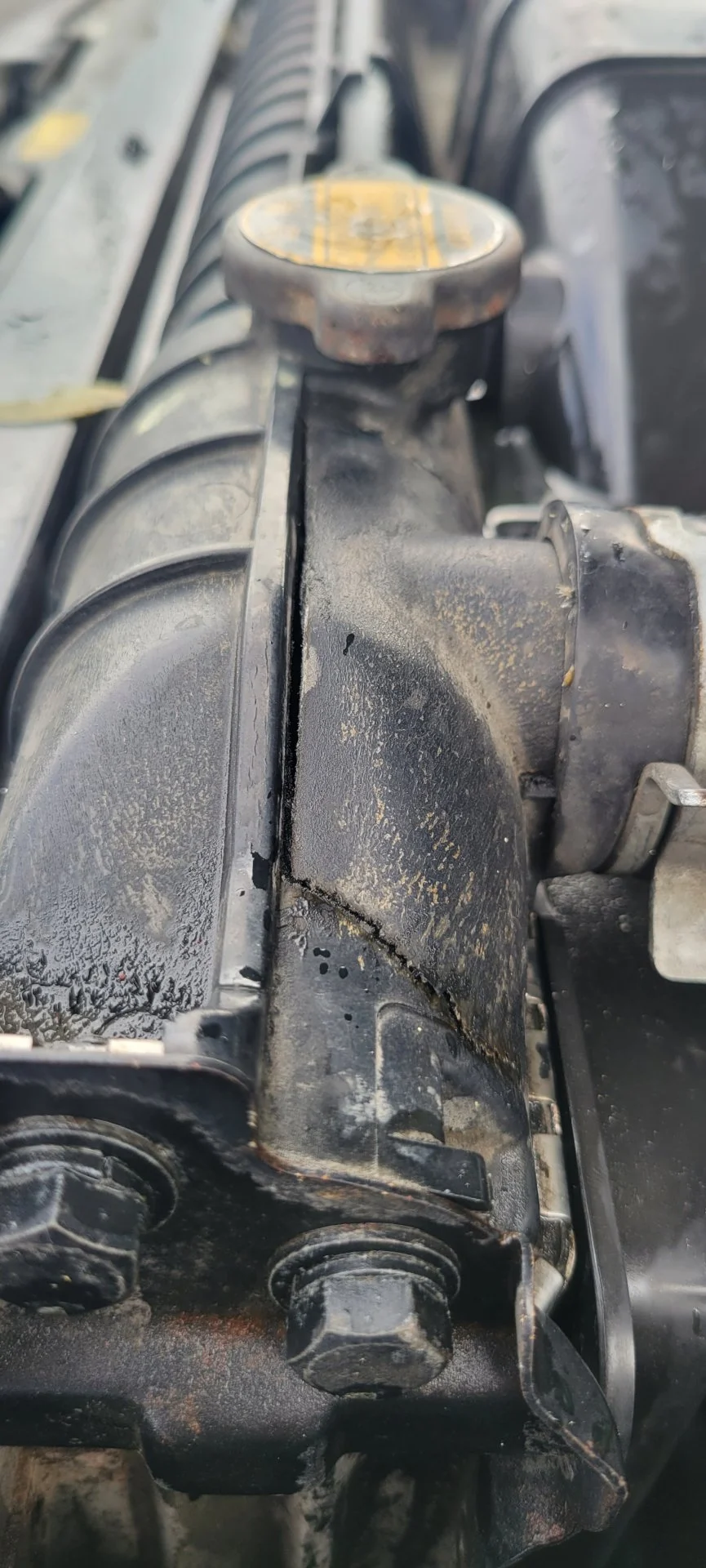

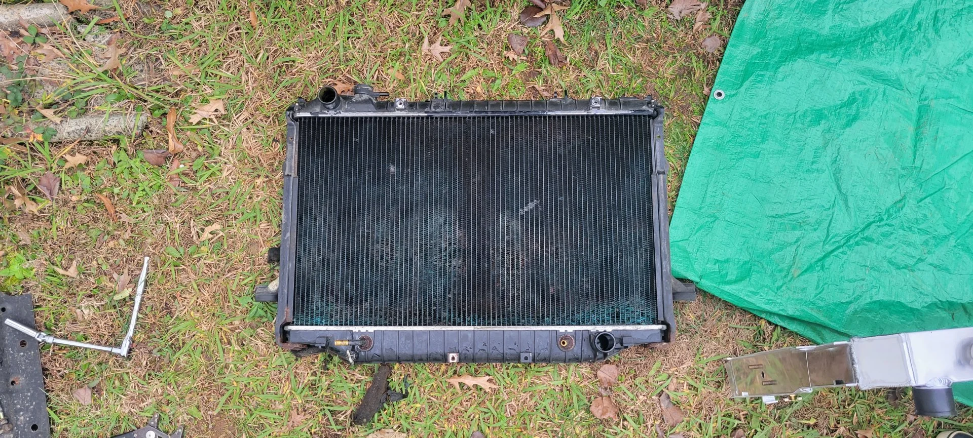

Hey everyone,
My radiator decided to blow going up 85. Can anyone recommend a replacement? I'm looking at a 3 row all aluminum now. Going to do the thermostat and hoses for it as well.

You’ll get another 30 years from an OEM radiator. Twice the price of the options but far fewer people have had bad ones out of the box. Time saved replacing a new one is money on the bank to me.

TYC1918 Radiator from RockAuto. The Arizona guys use them and love them. It's thicker than OEM, Koyo, Denso and dirt cheap. Will it last as long as OEM? probably not but I can buy two for the price of one OEM. Be aware that some have come damaged from the factory. RockAuto is good about sending a replacement.

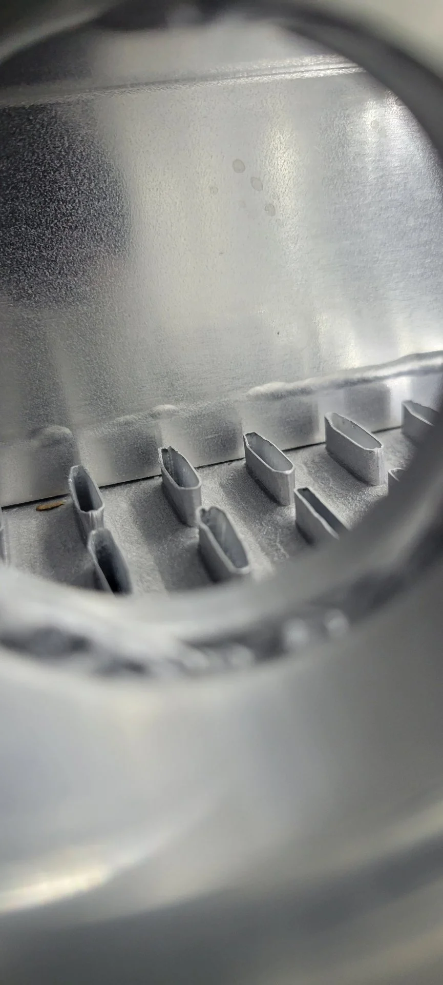

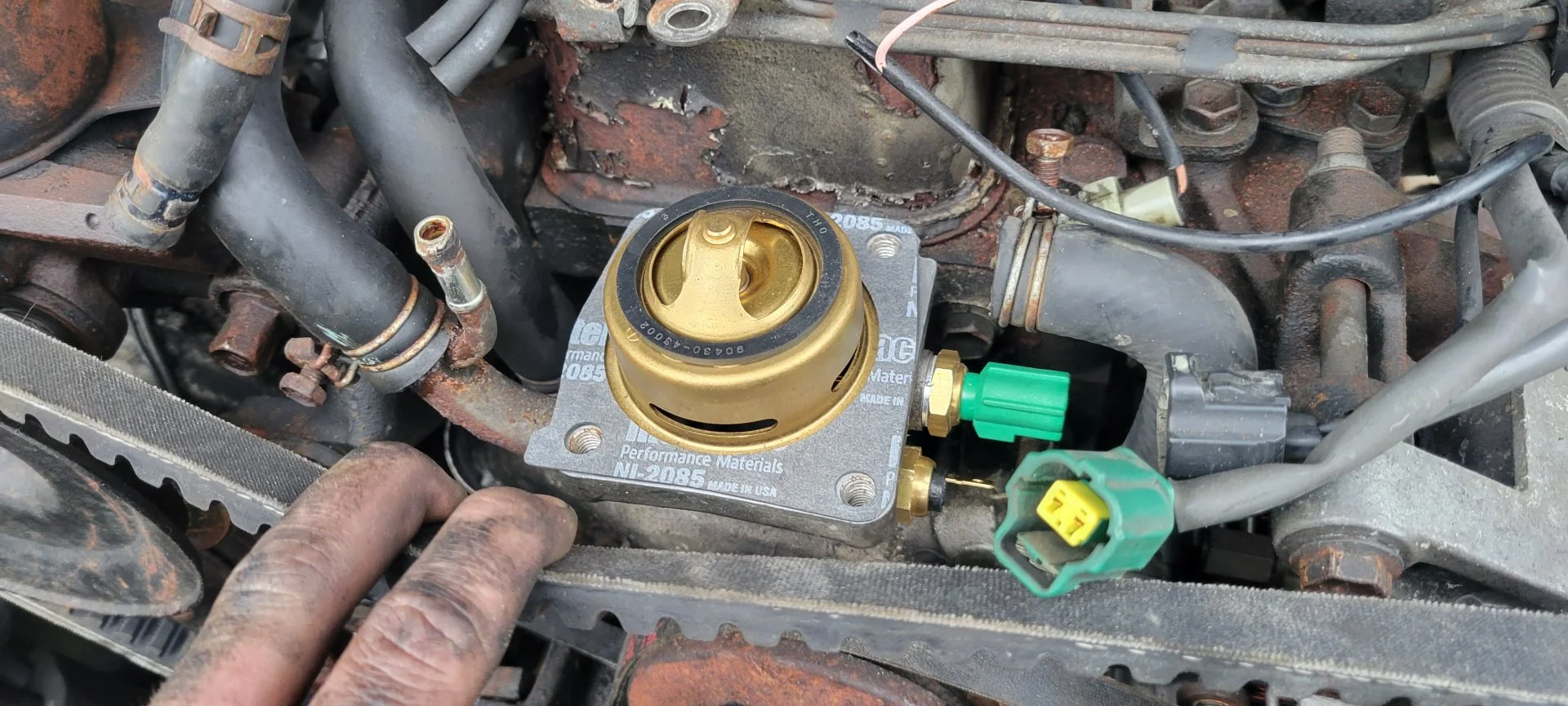

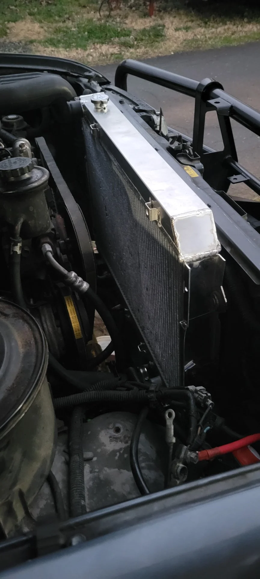

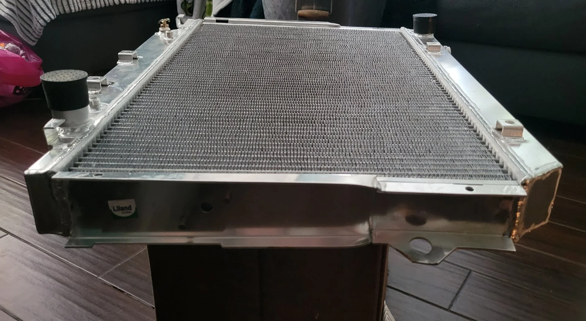

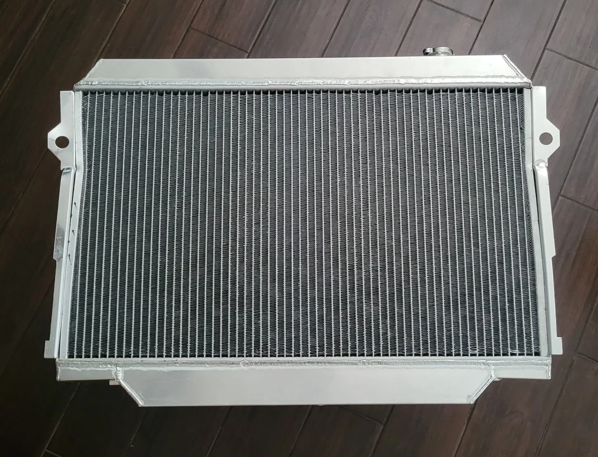

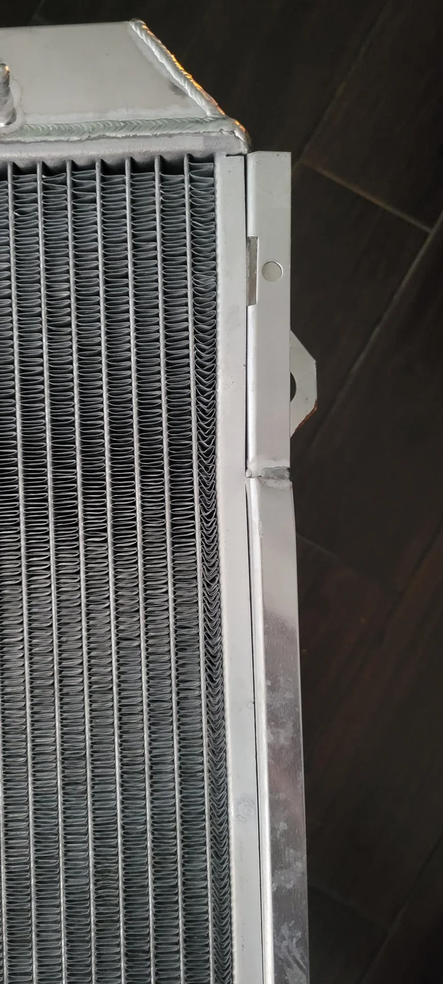

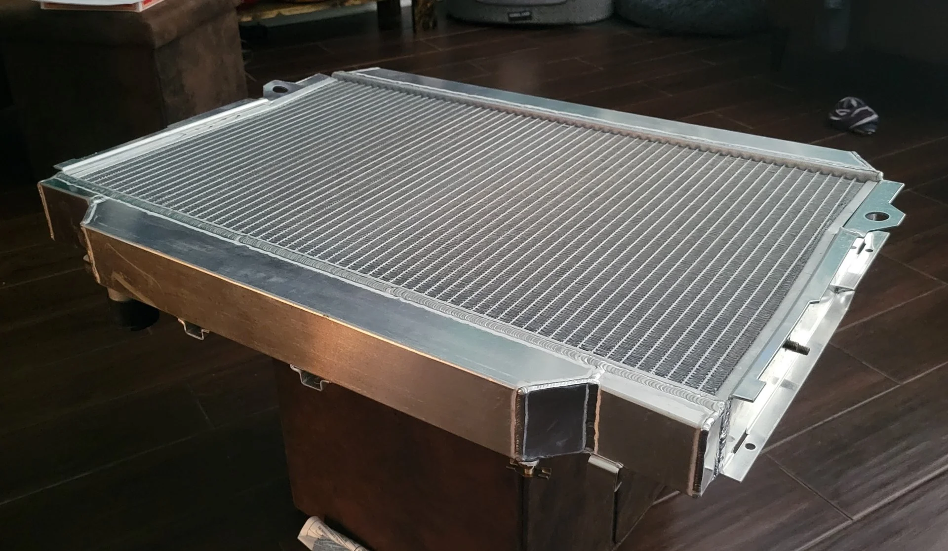

Update.
I ended up going with an aluminum (Liland 1469AA3R) radiator, oem belts and hoses, thermostat, and replaced the water temp sensor and sender on the bottom of the thermostat housing. This fixed my cold start issue and my temp gauge issue. Turns out the sensor and sender were bad/broken.
So far the new radiator has performed well. I did put an oem radiator cap on it. It was delivered with a little deformation on each side from shipping. Made a couple spacers when I installed it and that put the mount holes where they needed to be.
Definitely learned a lot on this swap. Next up are breaks. And maybe a service manual of some sort.
