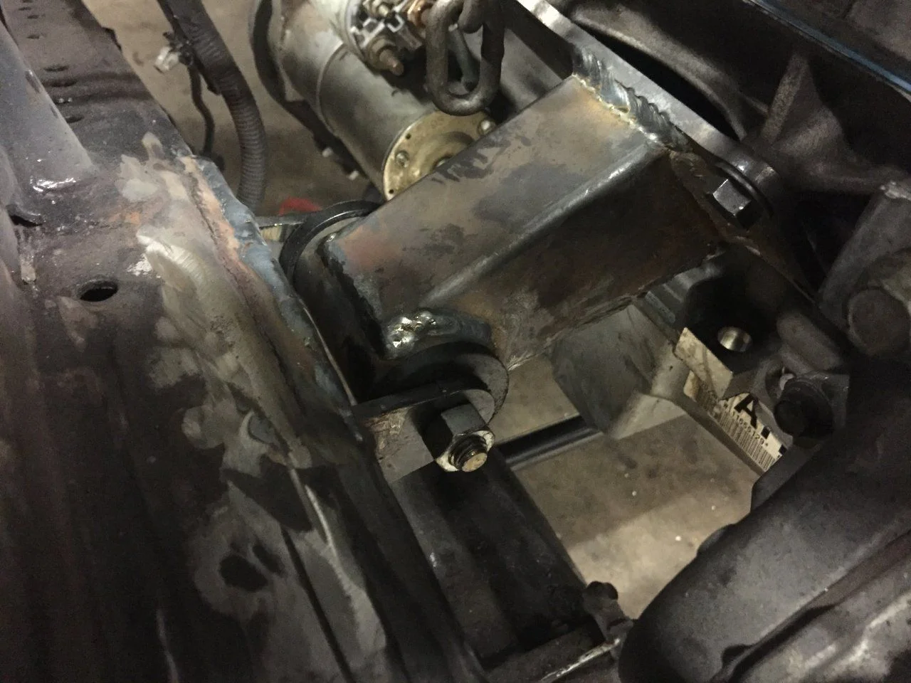

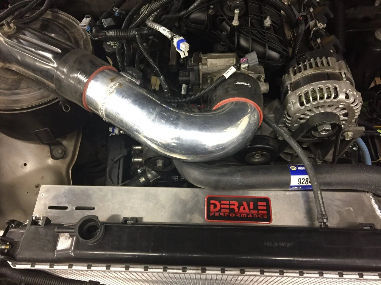

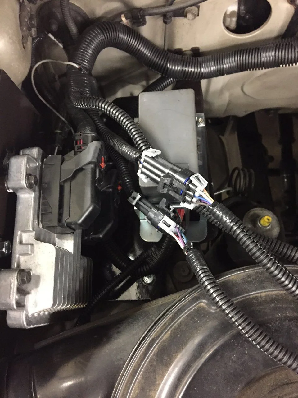

a couple updated photos. I hope to fire it up monday. I was not able to use the mark's motor mounts so I built my own . They started with some plates from liquid iron industries and i went from there. I made the computer and fuse box mount out of 1/8" plate with a couple strategic bends in it and welded all the nuts to the backside to make component removal easy
