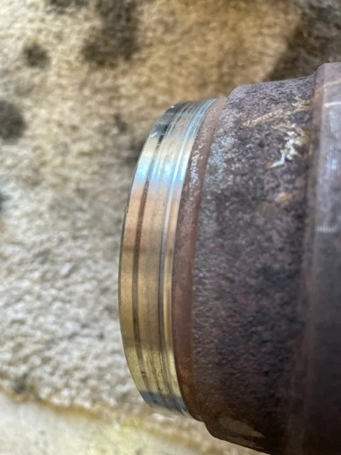

I posted this on my build thread but didn’t get any response. Anyone have experience with the rear portion on a front hub? It has a wear ring on it. But I’m thinking only the dust seal rides on it. Not sure if it warrants replacement.
Your correct, it's just the dust seal that rides against it. Mine was in similar condition an I lightly sanded it with scotch brite to clean up the surface an ran a new dust seal.

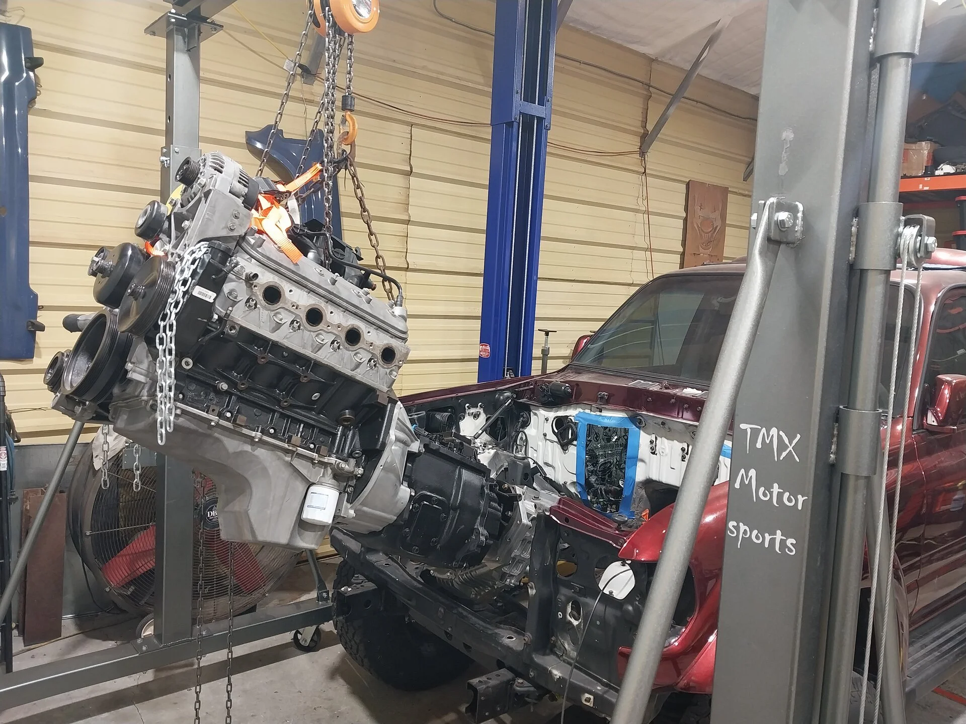

I am curious the weight difference with these swaps over our stock setup. I know my 6.0/4l80 will be heavier then the 5.3/4l60 swaps due to the extra trans weight but I am hoping it near evens out vs a stock motor/trans. It took me a while to get my lift setting how I wanted it.
My LT1/ 8L90e combo is about 250lb lighter than stock.
