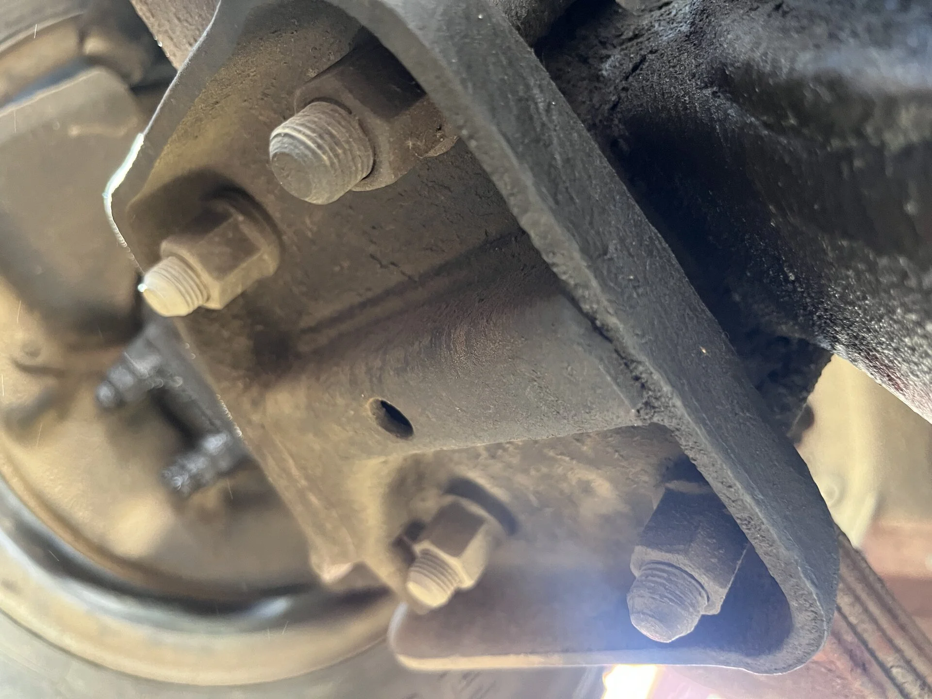

My lovely PO broke the front lower shock mounts off and welded bolts in place instead. Those have now broken on me. I’ve sourced a used set of spring plates, new u-bolts and shocks.
Started working on it today and discovered the plates I got are slightly different than the OEM ones on the truck.
See pics. Mine (62) have an extra tunnel welded down the middle-I’m assmuiming to stiffen them. The used ones I bought (60?) don’t have this tunnel. Should I be concerned?

Make sure you put some never seize in the the bores of those new spring plates or you may wind up recreating the PO's fix for stripped out bolt holes. If I had it do over again I'd be welding a long bolt under there too. In all my years wrenching this one PITA shock mounting setups I've encountered.
Thanks for the tip-I hadn’t considered the previous bolts might have seized. And the used plates I got certainly had rusty/crusty threads!
