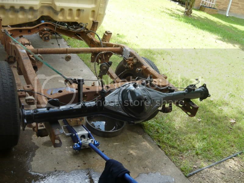

Built a five leaf spring pack out of Toyota rears for the front lift and had a new hanger welded in. Installed the new TG shackles and bolts with grease zerts. The springs moved the axle a couple of inches forward so now I have to fix the steering arm because it lost all its travel to the left which is in the plans.:D Moved on to the rear today, removed as much as the unessary that I could before the fab work can start. Also cleaned up the 93 rear V-6 axle that I scored with a Detroit locker.

Got the rear springs mocked up and the hangers tacked in. Need to find someone to weld them in, my machine is just to small.:crybaby:
Once I get some more weight in its rear I think its going to ride just right.
