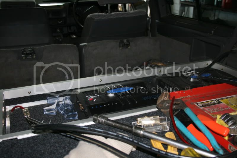

Start with a box to house the amplifiers/capacitor:
Line the box with carpet and aluminium angle for bling bling:

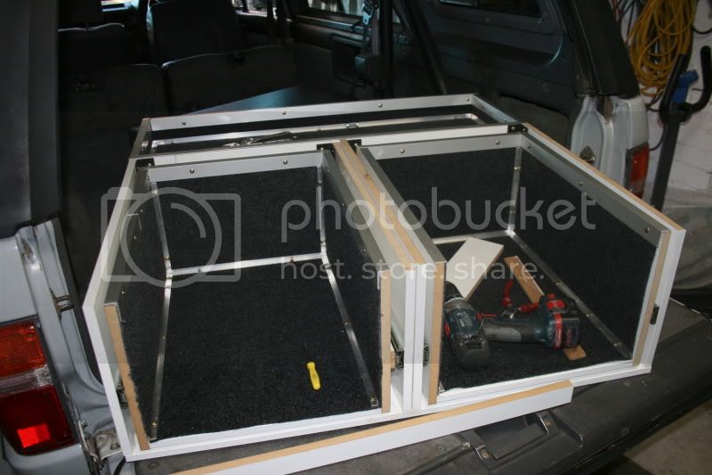

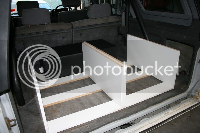

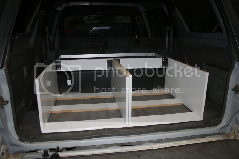

Make a frame for the drawers:

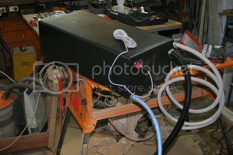

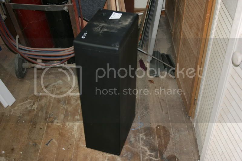

Here’s the water tank, it cost 90 dollars and holds 59 litres, it will sit underneath the amplifier box:
Attached the amplifier box to the drawer frame so it sits clear of the tank:
Here’s the water tank with the filler, breather and tank gauge sender attached ready to put in:

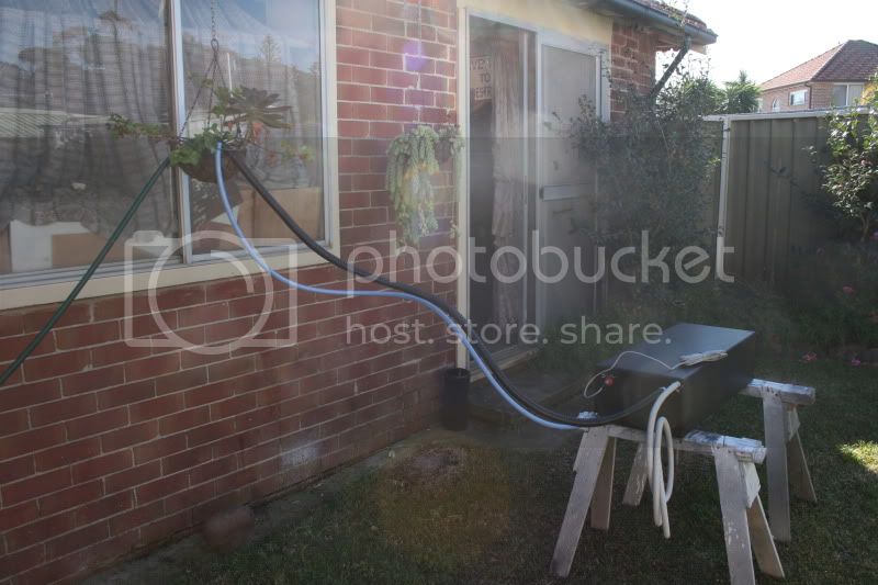

Quick test for leaks, all good:

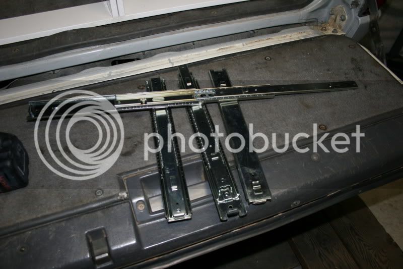

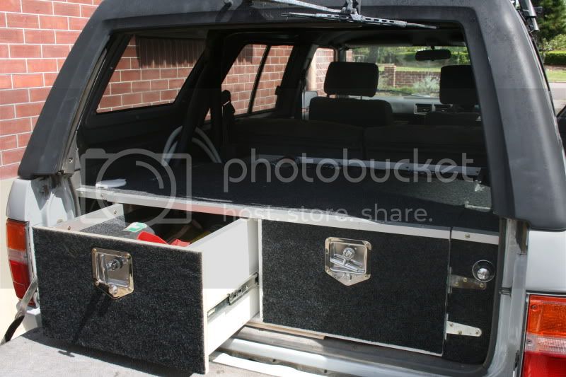

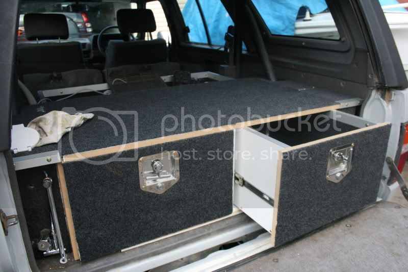

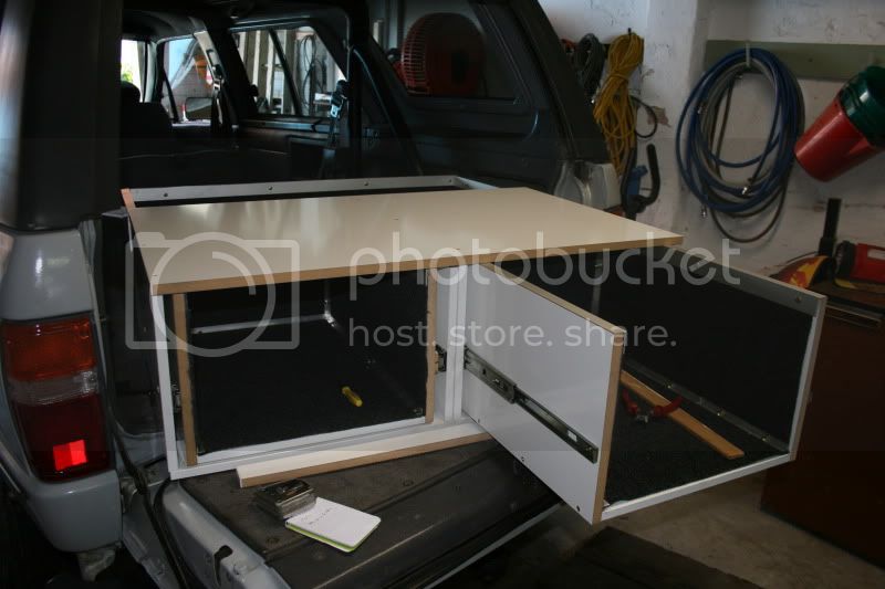

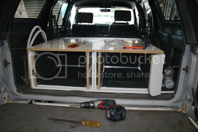

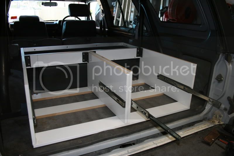

Here’s the drawer runners supposed to be good for 20kg each so 40kg a drawer, ebay special have used them before in my patrol and they worked well for the money:
Attaching them to the drawer frame:

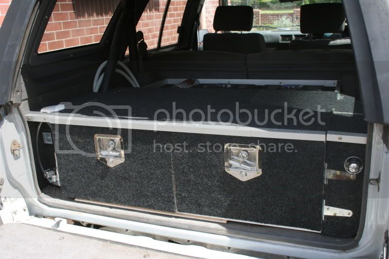

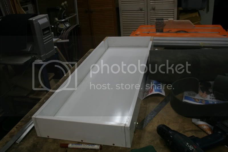

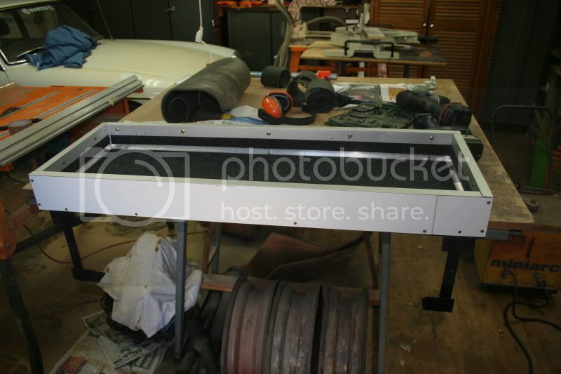

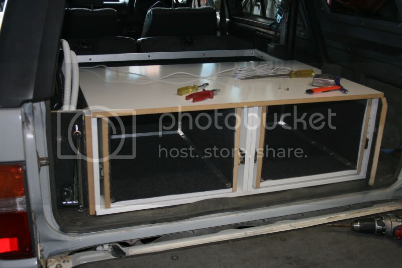

The drawers were made and got the carpet and aluminium angle treatment. I like to run maximum aluminium for extra offroad capability:
Put a top on the drawer frame:
Putting in the plumbing for the water tank, I’m running a shower neck and laundry tap:
Closer pic:

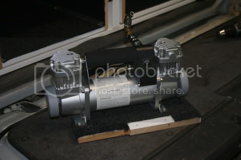

My never say die twin piston compressor, it sounds like a few rocks rolling round when it runs and has done since new:
Mounted on the opposite side to the plumbing:

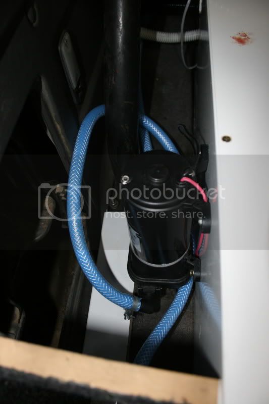

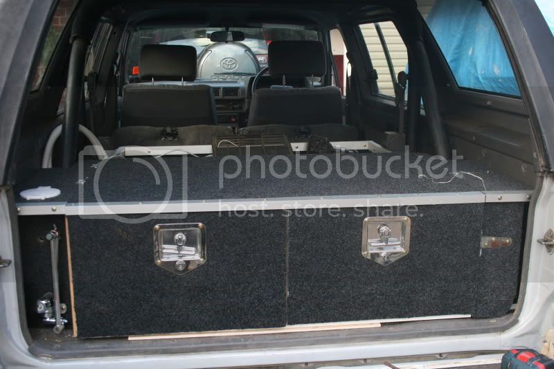

Here’s the 12v water pump for the tank/tap mounted on the side of the drawer frame, works awesome can put an extension on the tap and use it as a hose/transfer pump easily:

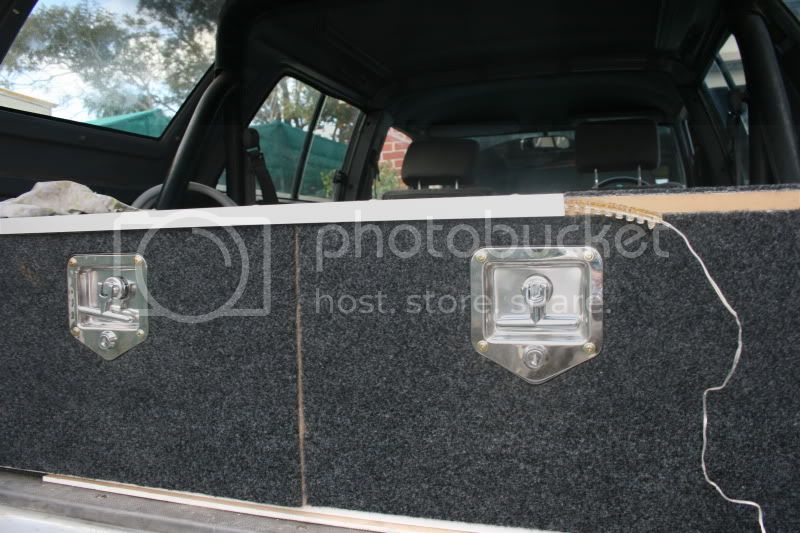

Using T handle locks with keys for security and pull factor, they work great:

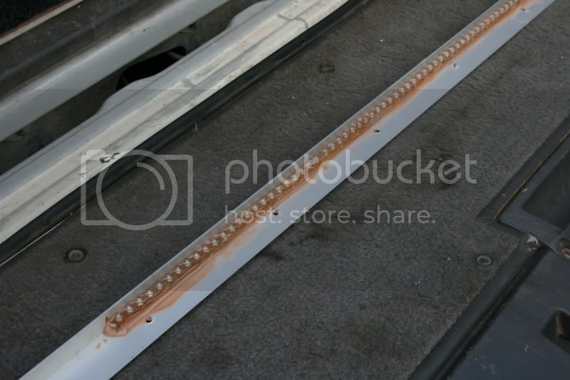

For the leading edge of the drawer top I’m of course using aluminium angle but gluing an led light strip underneath it for tail gate lighting:
Mounting to the drawer top:
Mounted:
You can see the water tank gauge next to the tap on the left, works on batteries and beats guessing how much water you have:

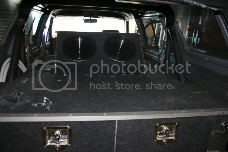

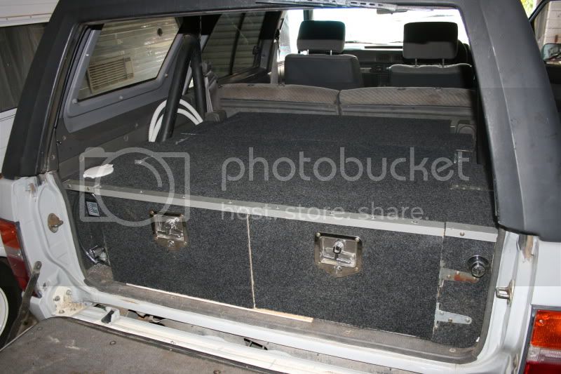

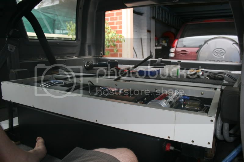

Packed the drawers:
Put a top on the amplifier box and part 1 of the drawer install is done:

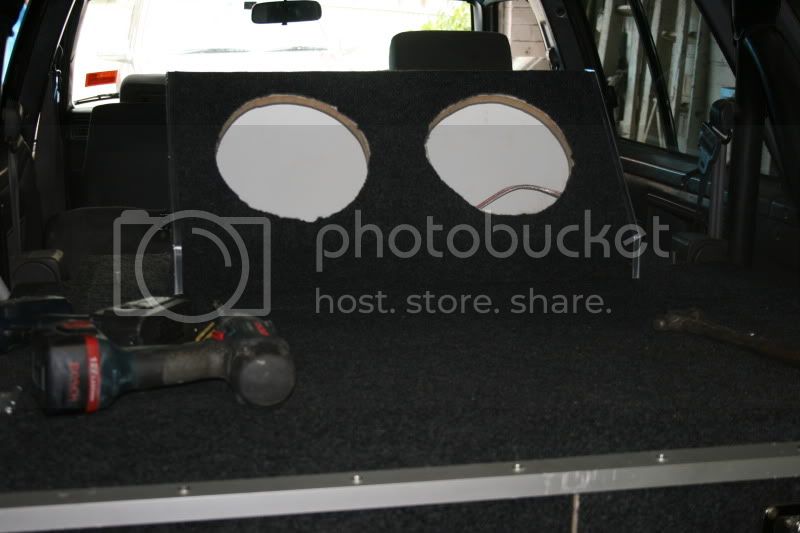

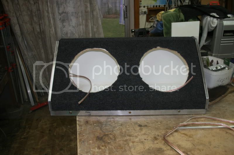

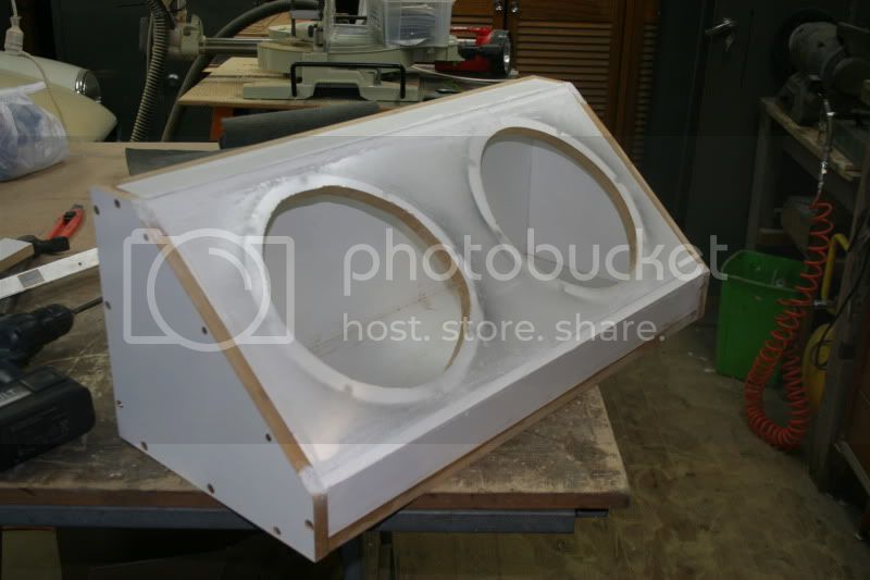

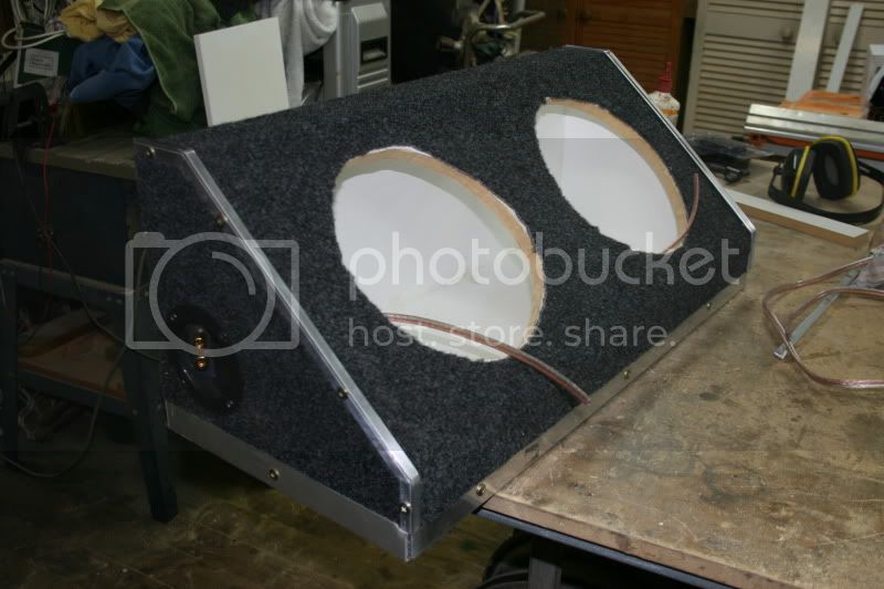

First I made the subwoofer box, I used the laminated ply again as it’s in good surplus.
Then carpeted it with marine grade carpet left over from the drawers, a good mix of aluminium angle as is becoming customary
Used a $7 wire terminal box to tidy it up
Then mounted it on top of the amplifier box

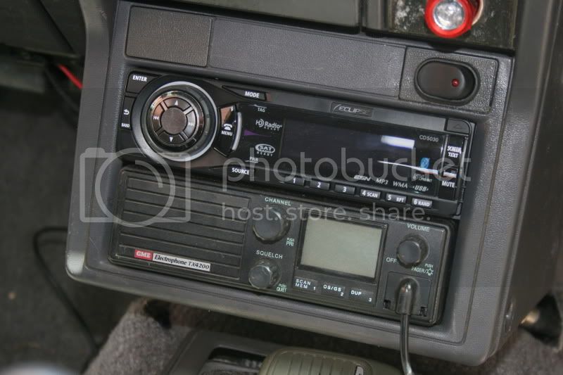

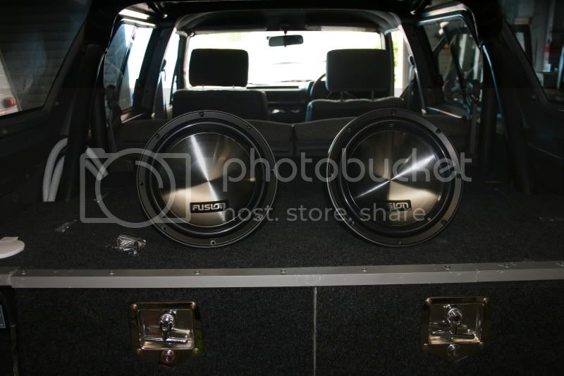

Here are the subs and head unit to be used, the head unit is an Eclipse CD5030 have had it in the car for a few weeks now and it’s an excellent simple to use package with all the bits and pieces.
These are the subs Fusion 10 inch 1000 watts each run in parallel
Here they are installed in the sub box, they will be run through a cadence mono block amplifier
Next the speakers, they are a clarion Kevlar 6 speaker component system. They will be run through a bridged 4 channel cadence amplifier

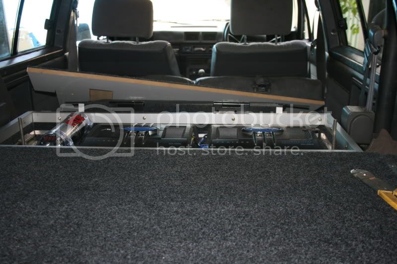

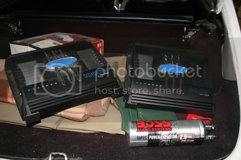

Here is the two amplifiers with a boss audio 2 farad stiffening capacitor
Starting the install
Half way through the wiring
Here they are installed in the amplifier box underneath the subs but above the water tank!

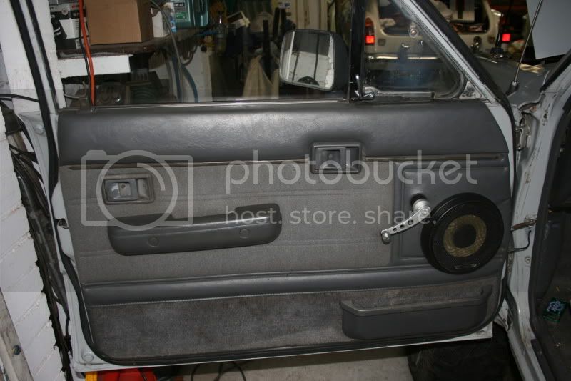

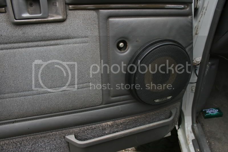

Installed the 6” mid range speaker in the door panel

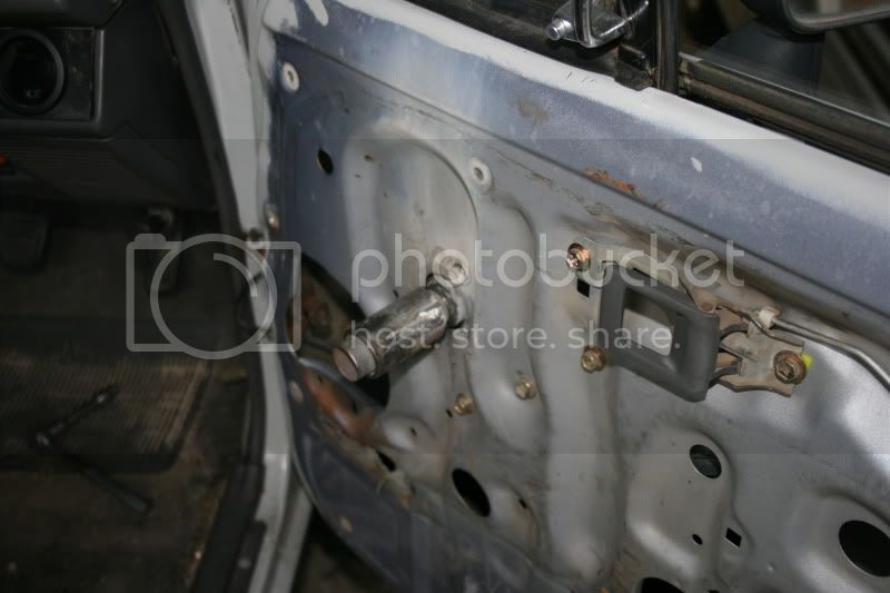

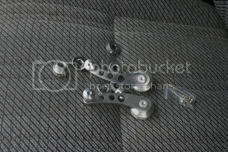

Had to extend the window arm so I could mount the 6” speaker up high as possible
Got some aluminium window winders
All installed and working great

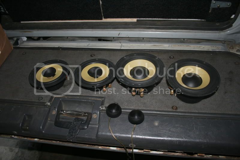

The tweeters installed on the a pillar cover and the 6.5” low ranges were put in the rear where the factory ones sit but I can’t find a picture of that atm
Here’s the head unit installed with my trusty GME TX4200, this UHF has been in every 4wd I have owned and hasn’t missed a beat.

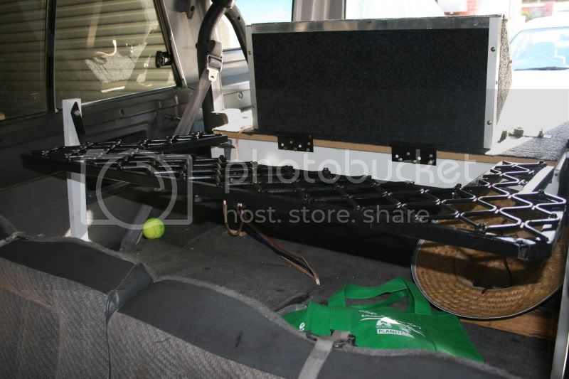

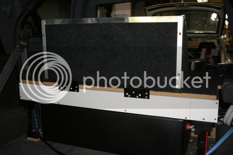

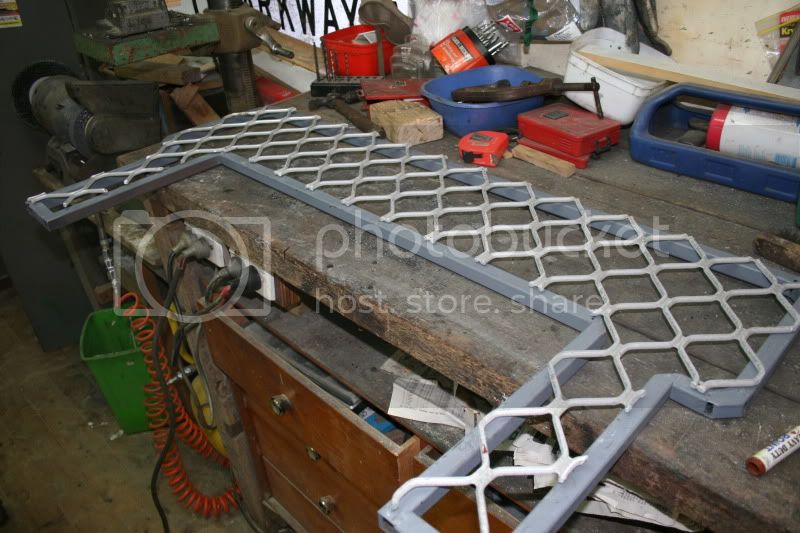

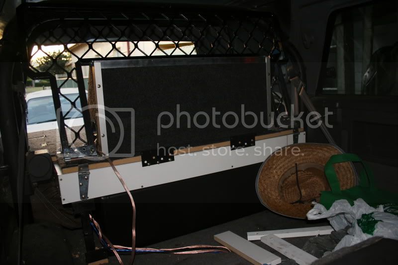

So with the audio side of things in and working well it was time to make the cargo barrier, it all started with some old box and an idea to make two supports that would hug the subwoofer box and be able to rotate from leaning towards the rear of the car to completely folded back the other direction.
Joined the two sides together and a rough shape was becoming apparent
Gave it a clean up, trimmed the rough edges and a coat of primer

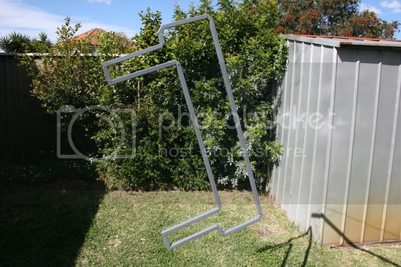

The screen was aluminium door screen I found in my mates backyard that has done the job great

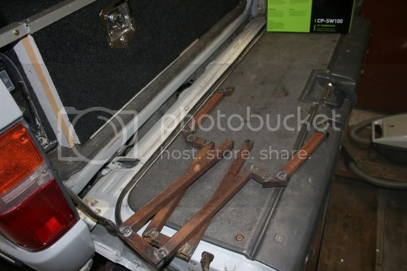

Here it is riveted up and painted in some killrust black, you can the two arms that attach to the roll bar via a long bolt/wingnut

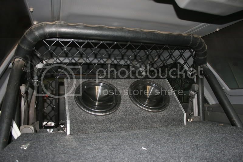

Here it is installed back in the car
And from the back showing all the hinges
Here it is with the cargo barrier folded forward

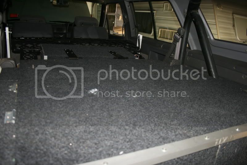

And another one with the subwoofer box swung over to give a (relatively) flat surface to put a mattress on, two lengths of mdf with the bolts that secure them to the roll bar prop it up at the appropriate height. I have temporarily lost the bolts but you get the idea

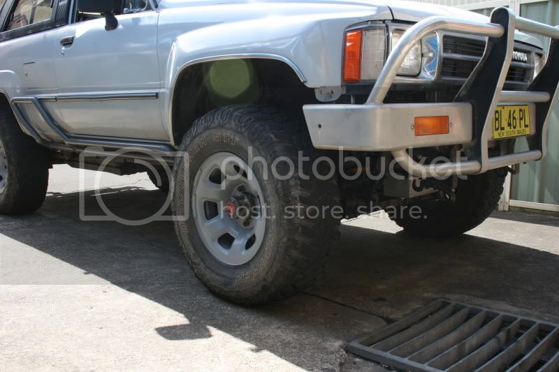

Gday time for another update have been pretty quiet on the 4runner with Christmas and work but have made a bit of progress. I rebuilt to power steering pump as I felt the alternator had received enough ATF to lubricate it into the next millennium!
I also bought some second hand cooper STT’s to see me through until I can afford to bet some better rubber on it, the 265/75/16’s are fitted to Patrol GU factory 16x8 steelies. I painted them the same colour as the body.

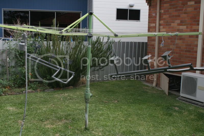

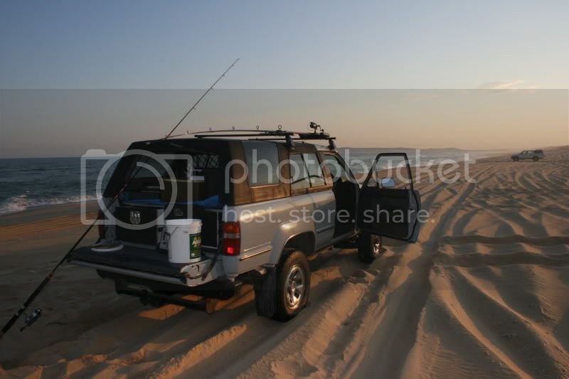

Then I made a set of rod holders for the roof racks as the local police don’t seem to like bulbar rod holders these days and these work great!

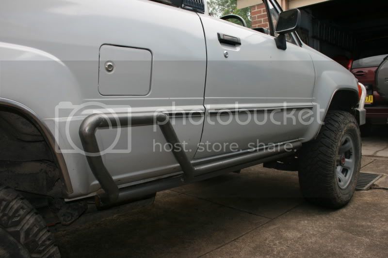

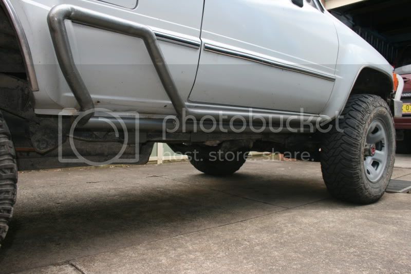

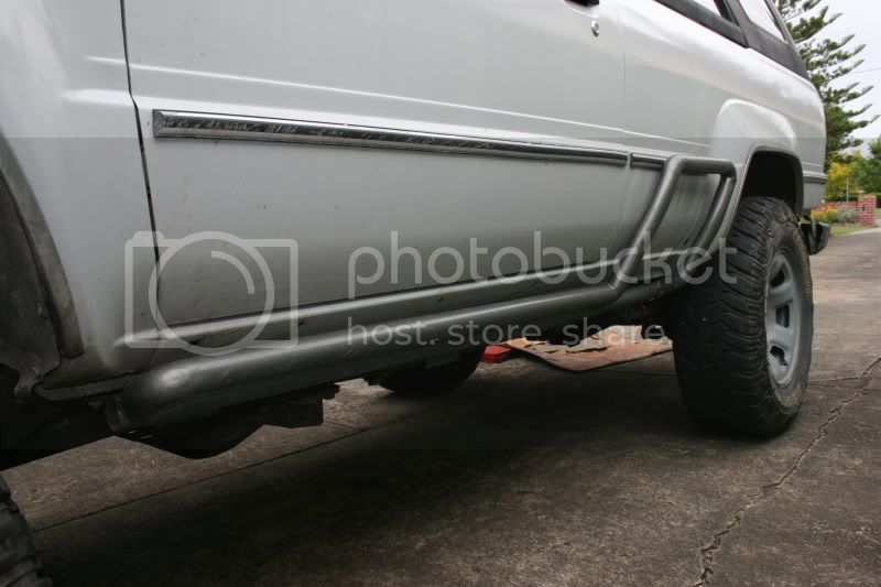

Finally I knocked up a set of rock sliders and painted them in charcoal hammertone to break up the grey with a darker grey!

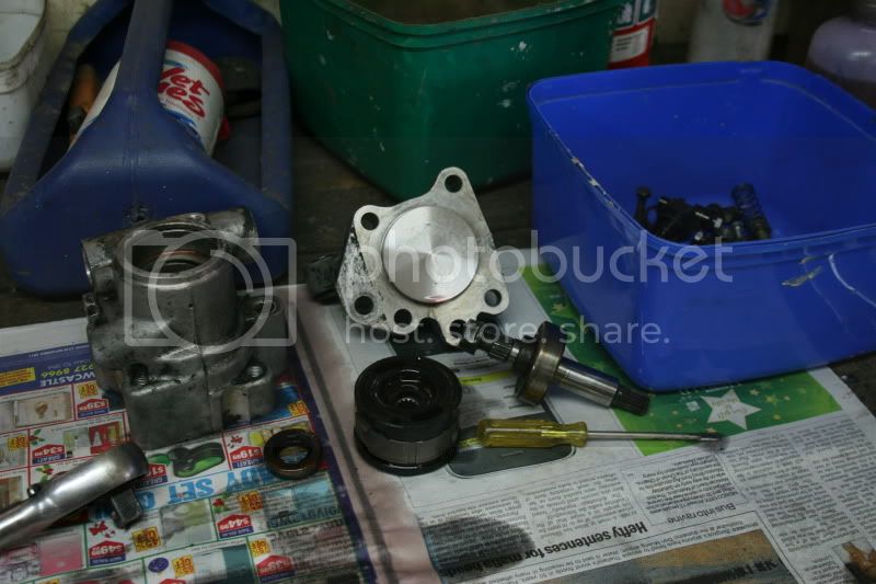

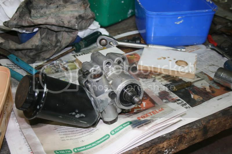

This is a LS400 1UZ power steering pump pulled down, piece of cake to change the seals hardest part was getting a seal kit!
All done and assembled ready to go back in

The rod holders and obligatory beach shot

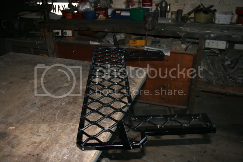

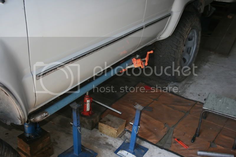

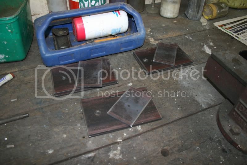

Now for the sliders I started with some flat
Welded it into U brackets for the chassis

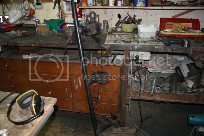

Attached the outriggers
Attached main bar to outriggers
Added to front part of the hoop first

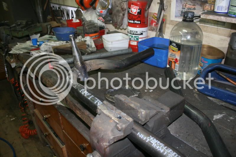

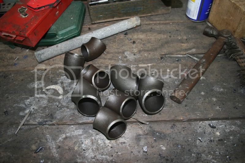

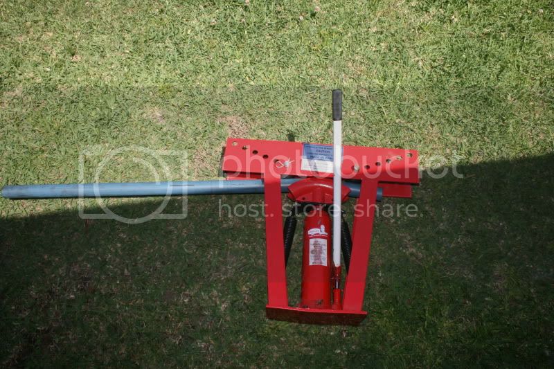

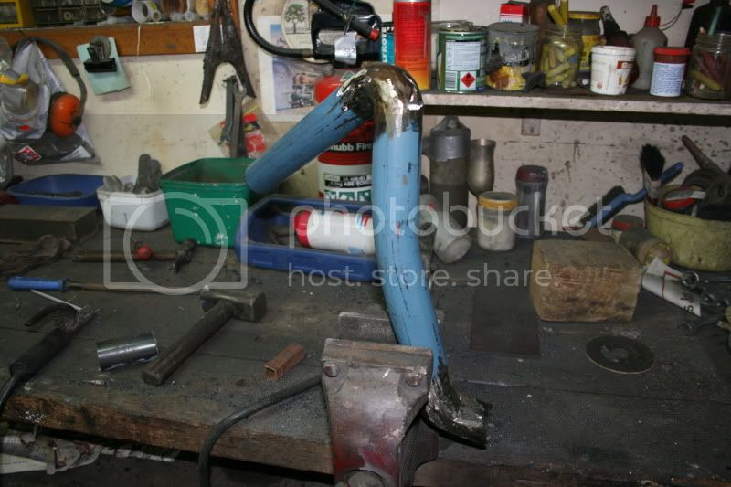

I’m using buttweld fittings for bends over 45 degrees, bow and arrow bender for less.

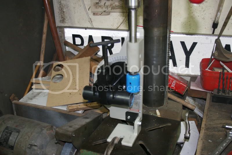

The ebay tube notcher, works alright for the $75 I paid for it. Perfect for a square notch, 45 deg was still fine just needed a little touch up with the grinder.
Part of the rear hoop of the sliders
Attached the front and rear hoops to the main bar
Clapped my hands twice and there was a second set for the other side, cleaned ready to be painted

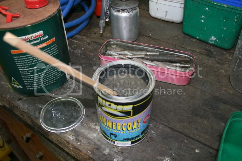

I’m using charcoal hammertone, 10% thinning sprays on alright.
Coated
And finally a few shots of the finished of the sliders attached to the car

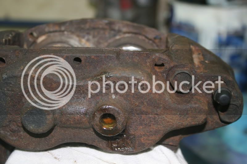

Gday once again it’s time for an update and a weak excuse as to why I haven’t been working as hard as I should on the truck to get it done sometime before 2022. Now here’s the excuse, a change of job and living situation has caused the 4runner to be put on ice a little although I am still spending a bit of time on it. I know I said this next update would be a rear bar and believe it or not I painted it’s first coat today, all that’s left is to fit it and put on its final coat of hammertone silver.
As for this update I went about and serviced the front hubs which included overhauling the locking hubs, new rotors, larger V6 4runner callipers with a rebuild and new wheel bearings. Once the swaybar bushes are done every bush and bearing in the front end suspension and steering will have been done or be less than 5000kms old. This work wasn’t really needed, apart from a leaky calliper, but I’m happy to do it all and know now that it’s done and I can rely on it for service for when I need it.
Any questions on the calliper rebuild don’t hesitate as the pictures here are not a complete guide on how to do them as it’s a critical job to not stuff up.
Ok time for the pictures:

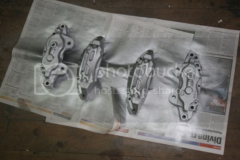

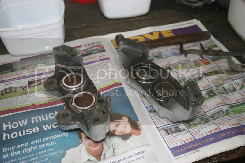

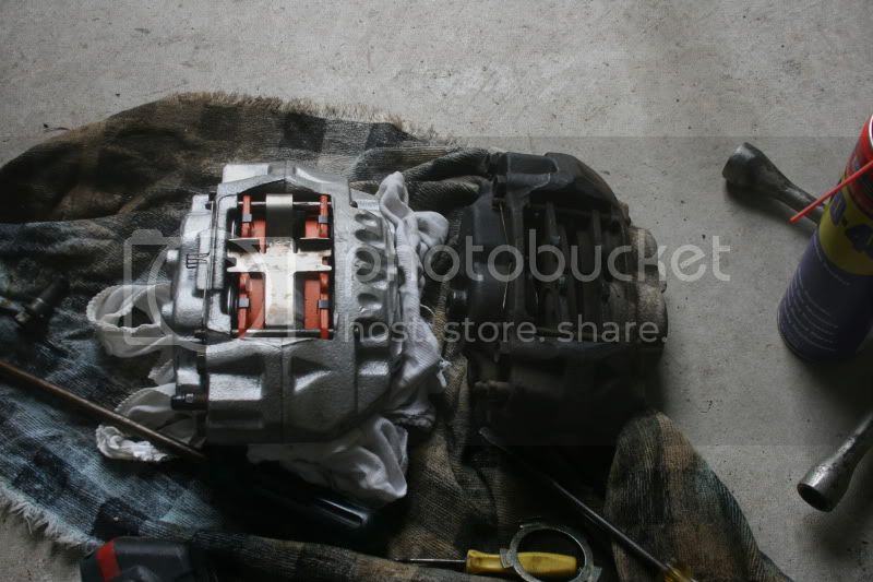

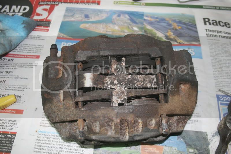

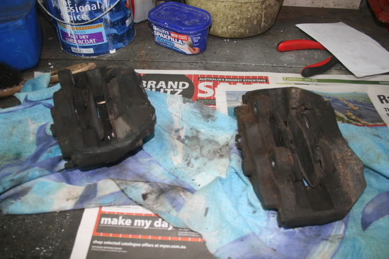

Here’s the V6 4runner callipers I purchased second hand for $80 for the pair:
As you can see they are worse for wear and could well use a rebuild:
Here’s the code “S13WB”, this is the code for the upgraded callipers, if upgrading look for this code in this place to be sure you have the right ones:

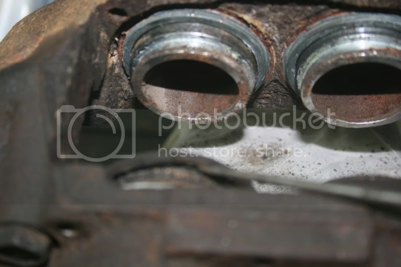

Pulled the dust seals to reveal the pistons:

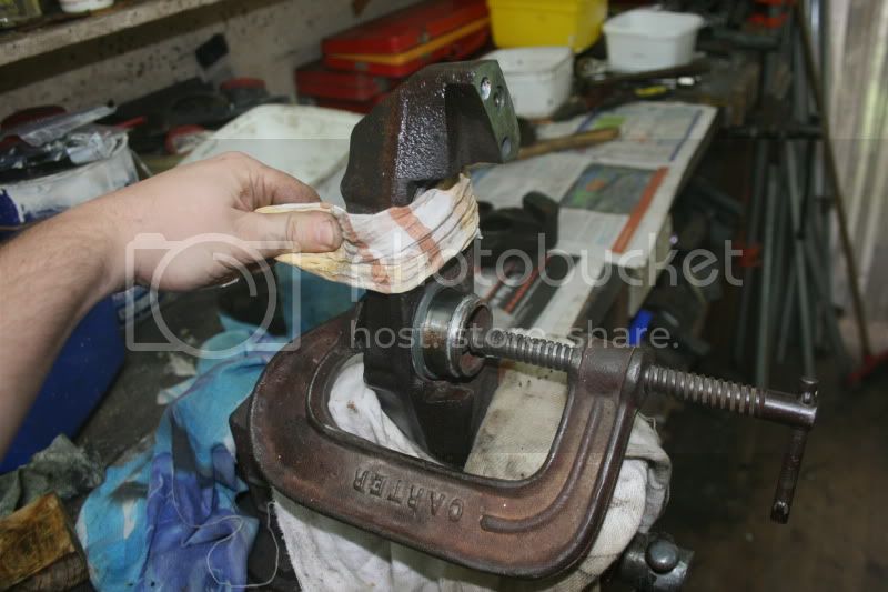

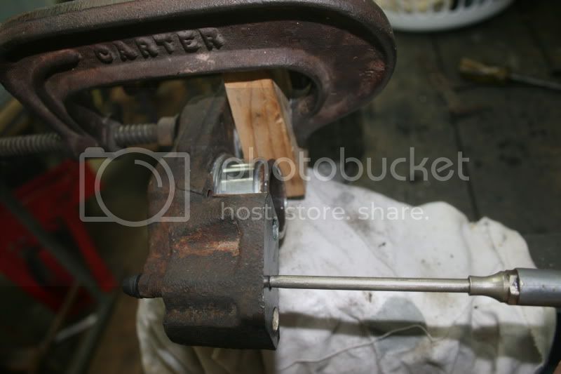

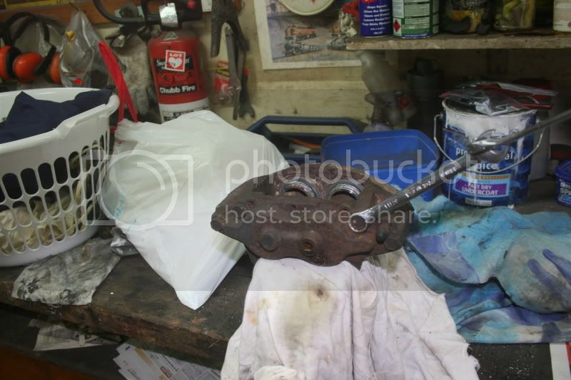

Starting to crack the caliper into its two halves:
I used a vice with a cloth to protect the calliper and to secure it when removing the pistons:
I used compressed air through the brake fluid port to push the pistons out of the housing:
Make sure you retain the piston you are removing with a cloth as when they let go they will fly across the room:

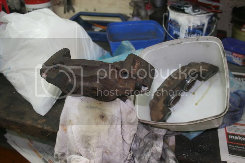

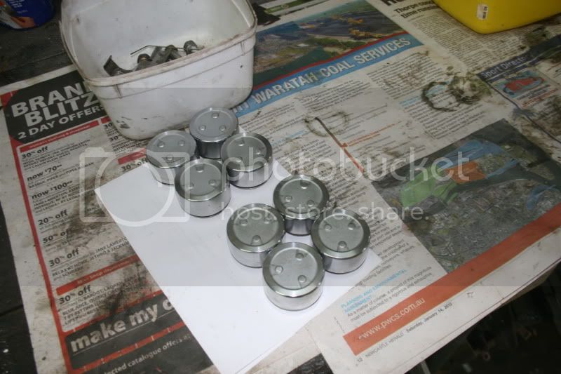

Here’s all eight pistons cleaned with a wire brush ready to reinstall, make sure you don’t scour the piston surface that contacts any seals when brushing:

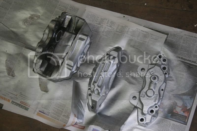

With the seals and pistons removed I gave the housings a good clean with the wire brush and thinners, then I coated them in some left of high temp paint:

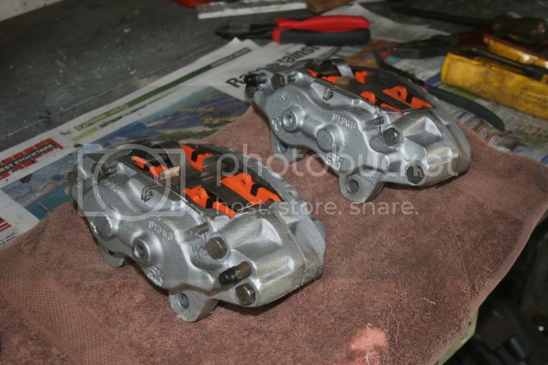

Beginning the reassembly with new seals:
One down, one to go:
All finished with a new set of brake pads ready to go on:

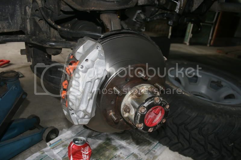

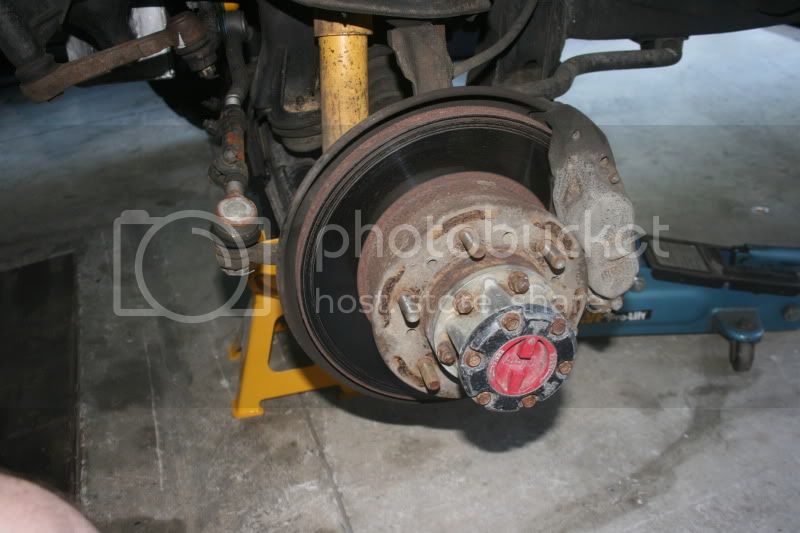

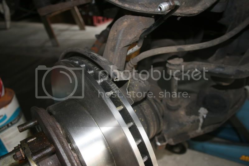

Here’s the old hub setup ready to be removed:
Here’s the two callipers side by side, the size difference is quite noticeable:

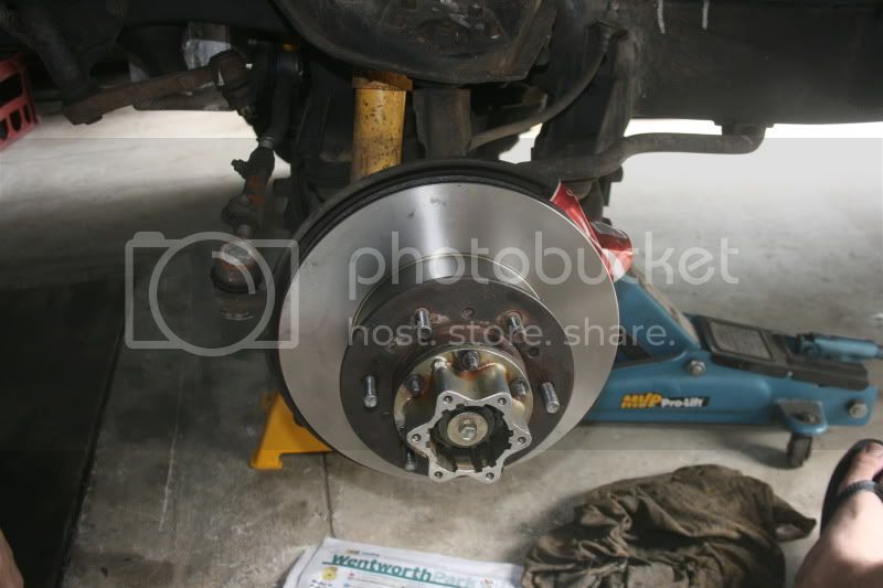

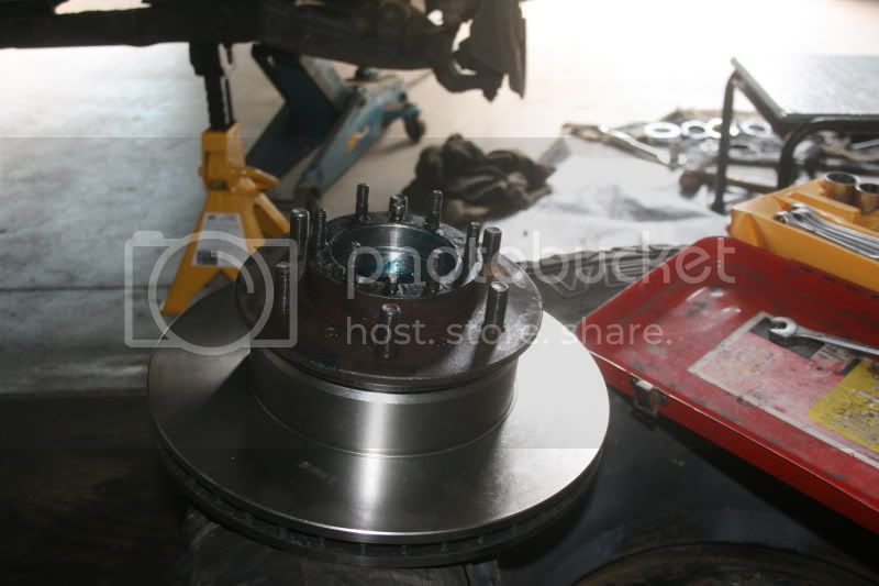

Here’s the hub with rotor attached and new bearings ready to put back on:
On and ready for the callipers and locking mechanism which copped a clean out and smear of grease:

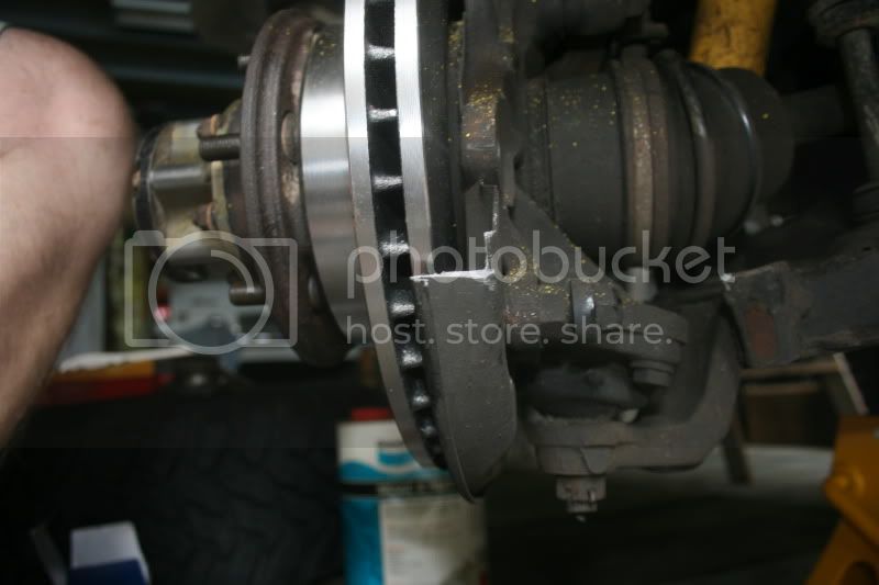

An important note for anyone doing this, If you are re-using the rotor backing plate it will need trimming away top and bottom in order for the larger calliper housing to fit. It is MUCH easier doing this on the bench but is possible to do with a rotor on and a hacksaw blade, just take care not to mark the rotor:
Bottom cut away:
Here is the finished product all installed ready to roll:
Over all, upon driving these for a few kms and observing the difference in my brakes I can say they were an excellent braking upgrade for my truck and would do them again in a heartbeat. The increased stopping power is more than noticeable and is a great, easy upgrade.

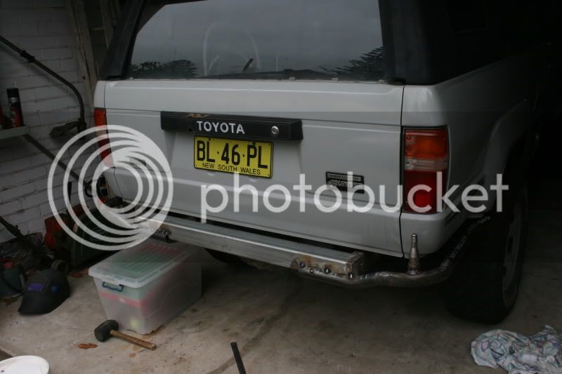

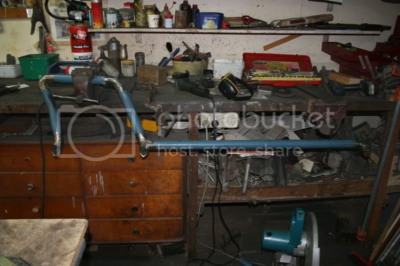

Time for a quick update on my rear bar, this is just the lower part of the bar the swing away wheel carrier will be knocked up in due time but for now the lower part will have to do. I didn't really anticipate spending this much time on knocking it up however I've come to realise anything "one off" or custom comes with much additional time in measuring, checking, re measuring, fitting, checking and redoing it all together.
The amount of times I had to put the bar on the car only to check a clearance then pull it off again was annoying. This became especially annoying towards the end of the project as continually adding metal to the bar made it pretty heavy (Duh!). In the end the bar came to around 40kg give or take. The cost of metal was around the $150 mark and the latch I added was $20 and the trailer stub axle and hub was around $50. Add another $30 in welding rods and grinding consumable I would have spent around $250 on a bar that suits my needs and tastes.
The second gen 4runner, as I might have mentioned previously, lends itself well to tube bar work, I decided to incorporate a couple of features such as some protection for the rear quarters and a towbar/recovery point. The rear quarter protection was done to line the rear bar up with the sliders which I think aesthetically, worked well.
Anyway enough boring text time for the photos:

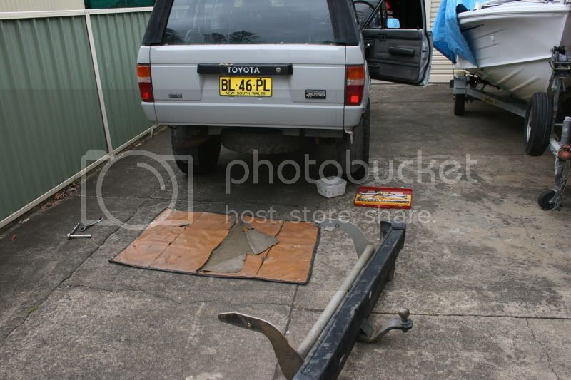

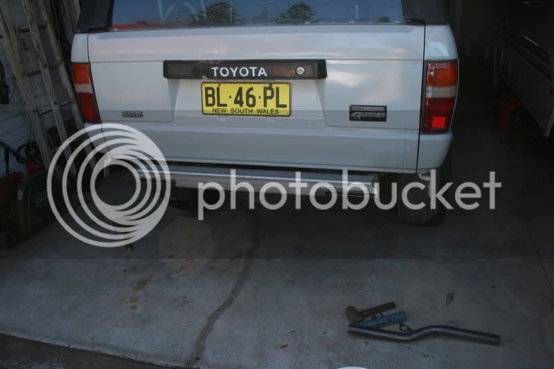

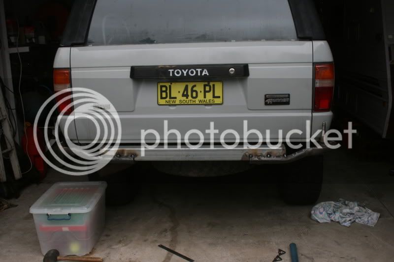

First up I removed the old factory bumper and tow bar

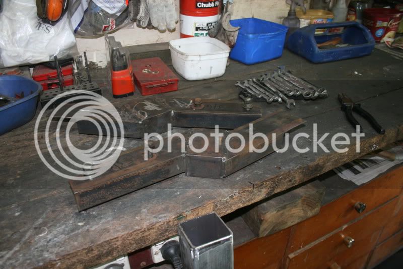

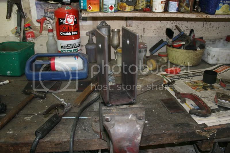

I started by making the mounts, they are made from C channel fish plated together for additional strength. I can't remember the dimensions but the channel slides into the chassis rail very tightly.

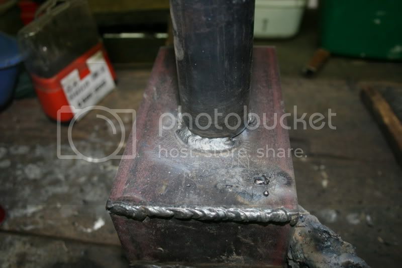

I then bolted the two mounts in, measured the length between them and welded in some 75mm box in about the 6mm thickness:

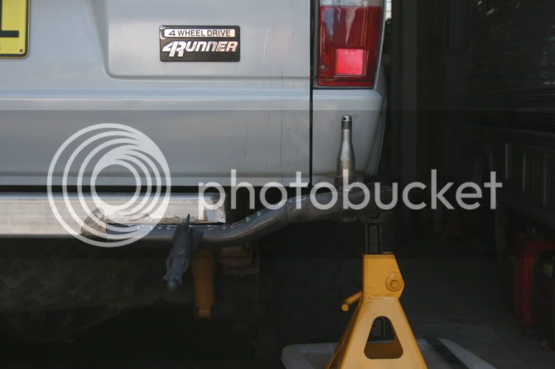

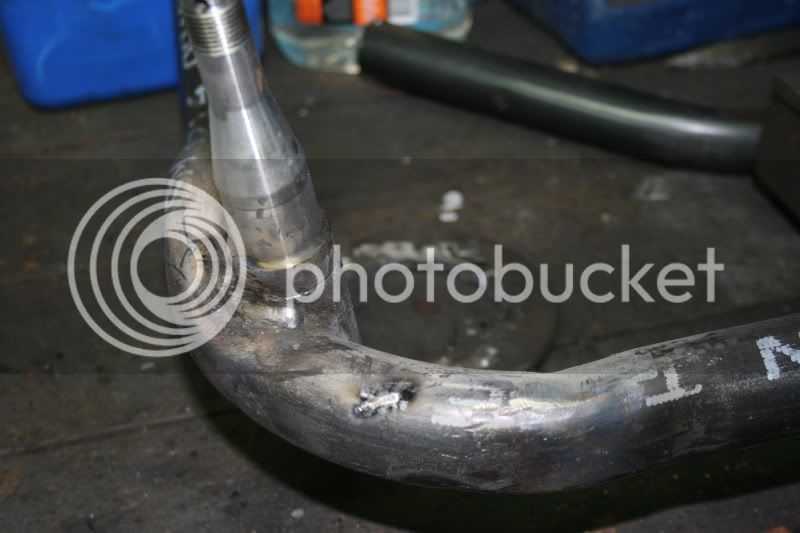

I then notched both lower sides of the bar ready for the side bars to be installed:

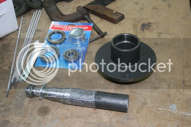

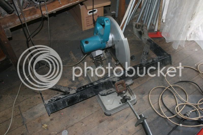

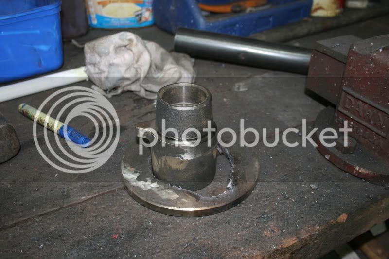

Here's the trailer stub axle and hub I am using, I tried to get a flangeless hub but when ordering the bloke thought a studless hub was one in the same so that's what I settled with (smacks forehead)
Put the plasma cutter to work and left a small part protruding, this will be used as a stop for the swing away wheel carrier:

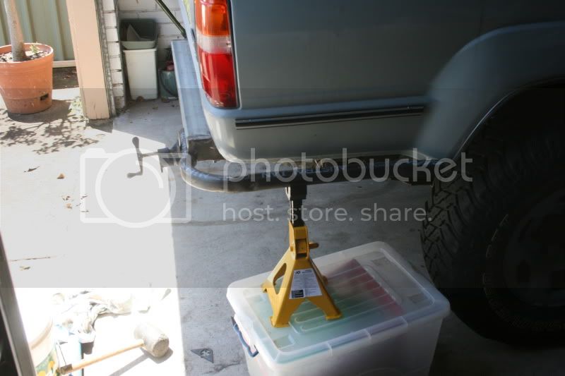

I'm using a single piece for the section of the lower tube, one to maximise strength and two to try and get practice rhythm with the bow and arrow tube bender:
Another shot to get a better idea of how it sits in the crossmember:
IMG]http://img.photobucket.com/albums/v600/trunx182/IMG_7550.jpg[/IMG]
I cut the trailer stub axle down and notched a piece out of the tube for additional strength, here it is welded into the tube:
Closer shot, you'll see later I welded in a tube support from the C channel mounts for additional strength:
Here it is fitted upto the crossmember:
Clap my hands twice and there is a lower tube section for the other side:
Different angle/tacking all in place:
