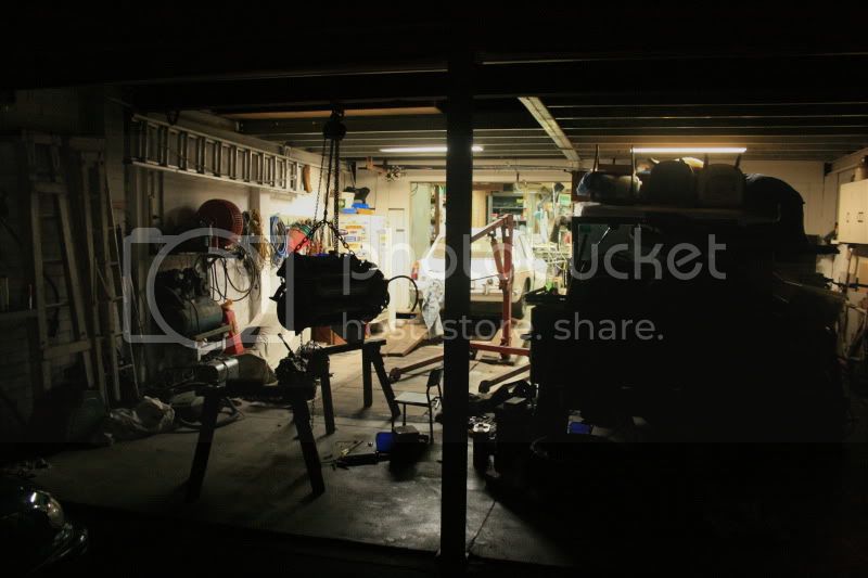

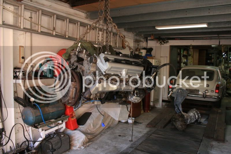

Here’s the two engines side by side, donor engine on the left, ready to strip down. Has been raining heavily here and was a great way to spend a raining day pulling bits off both engines. Clutch in the foreground in great condition so I’ll just put it back in.
Here’s the donor engine stripped about as far as she needs to be. I may still pull the water pump to have a look but with the timing all set and being told they were new belt and pump I may just leave it.

make sure that starter is good! you don't want a dodgy starter installed in one of these engines (one of the hardest to replace)!
is that a land rover parked over to the right?
oh yeah, make sure those ebay gaskets work! I saw a thread on another forum the other day where someone said some of the ebay gaskets are printed "backwards" and won't work right!
your house must be huge! I wish I had space for a workshop like yours!

*As for the gasket issue, yeah, that. IMHO for an engine that nice just stick w/ the factory gaskets.
~I keep flashing back to the safety video we had for wood shop when i was young and picture that poor MG with a piece of lumber sticking out the window..cover that thing already. :D

I'll let you know how the gaskets go, so far everything I have used fits great. I'm only using about half the kit the rest isn't worth disturbing.

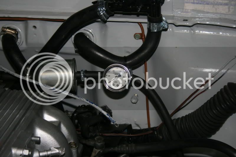

Fitted an inline fuel pressure gauge for that little extra bling

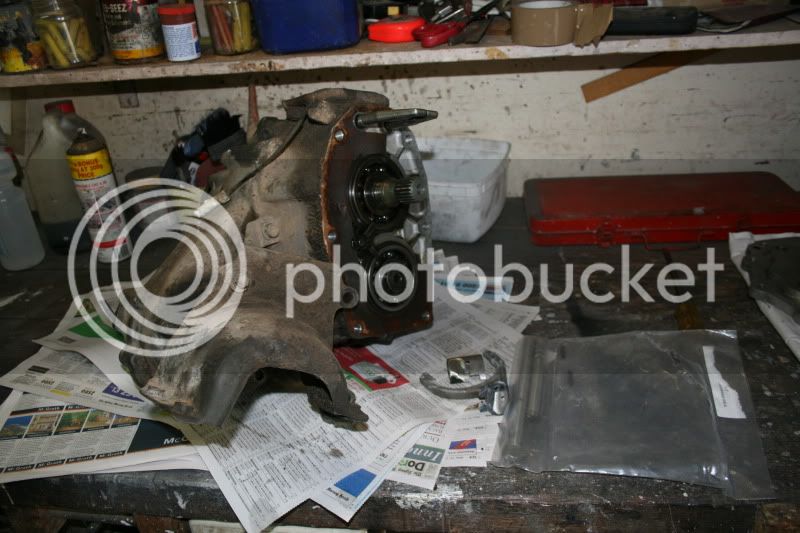

Forward shift gear drive transfer

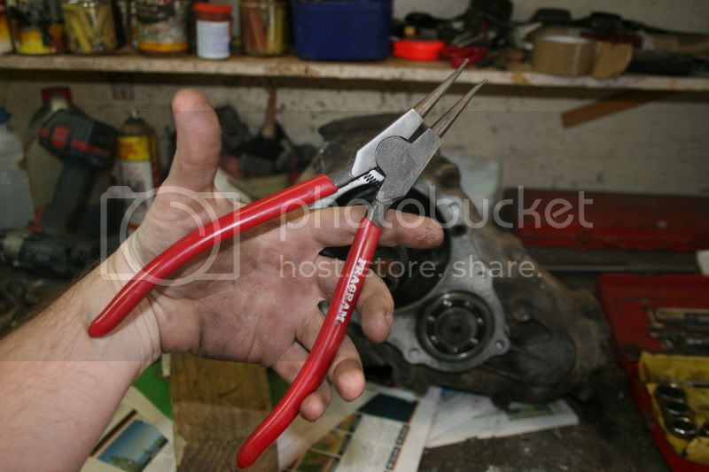

Good set of circlip pliers makes for 70% less swearing when pulling down the transfer
A call to locktup4x4 got me the top shift conversion rails within 48 hrs, was the first time I’ve used them and they were excellent to deal with.
Trying to remember how it all went together!
All buttoned up, one forward shift transfer case turned top shift transfer case

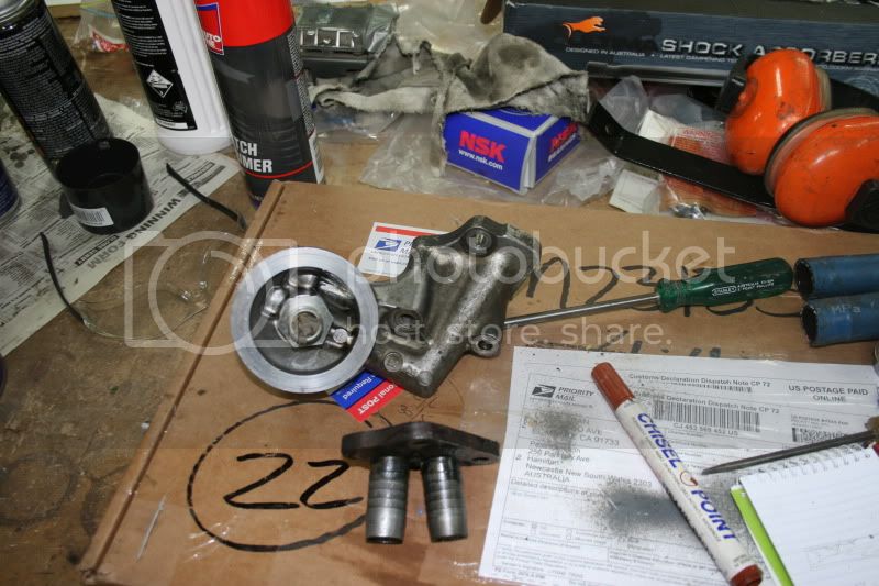

Here’s the old remote oil filter mount at the bottom and the SC400 one I squeezed in to replace it. Much more reliable system but took some careful heating and hammering on the alloy sump to get it to clear.

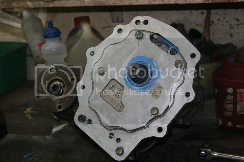

Chain to gear drive transfer adapter sitting on back of R150F gearbox
Chain to gear drive transfer adaptor sitting on front of the gear drive transfer.

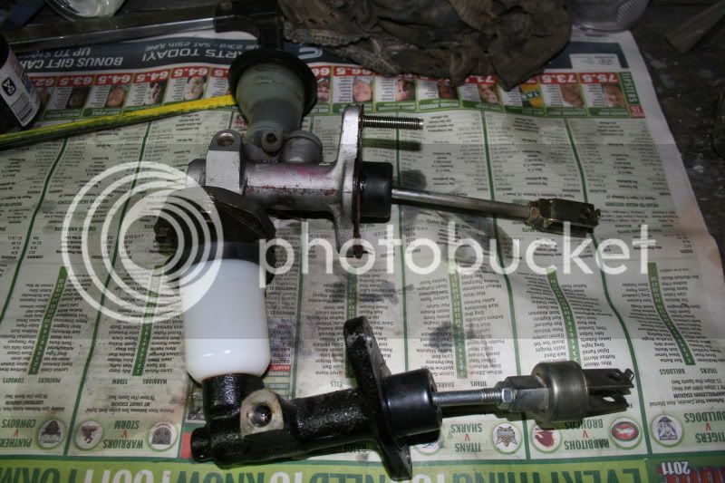

Also had a small problem with not enough travel in the clutch slave cylinder. Solution was to fit a 80 series land cruiser clutch master as with a larger bore a greater amount of fluid will be pushed to the slave giving it a longer travel. This was a non abs model which bolted straight up after filing out the cylinder hole in the firewall to suit the larger clutch master.

Any chance you have a part number for that 80 series clutch master? They weren't available in the US with a manual transmission.
