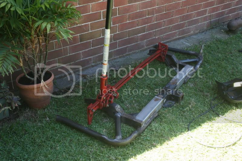

By a lucky chance of fate the towbar was made out of 75mm box in a 6mm wall, the exact same as my crossmember! Instead of mucking around notching the crossmember I decided then and there to cut the crossmember, sleeve the inside and weld in a section of the tow bar:

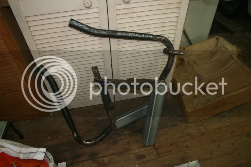

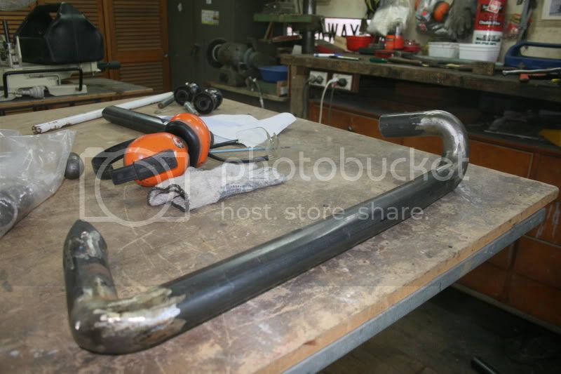

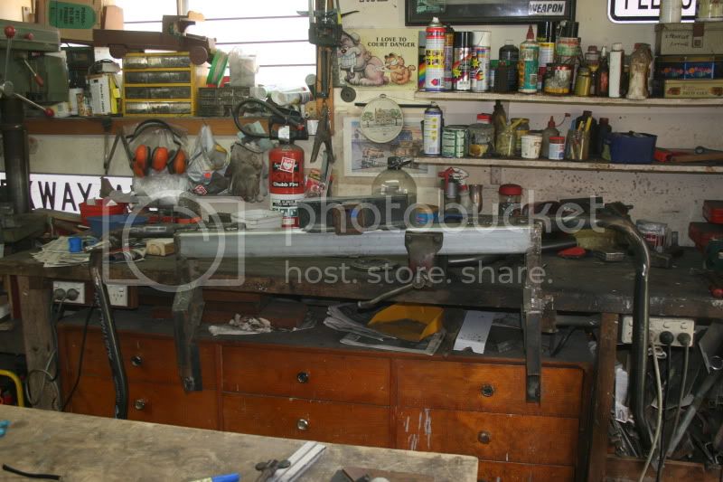

Here's the rear bar cut in half, seemed wrong cutting it in half after all the careful measurement that went into it:

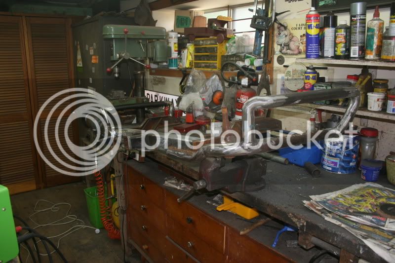

Here you can see the sleeve I used inside the crossmember, I definitely wasn't satisfied buttwelding these sections together so sleeved either side for a good 8 inches:

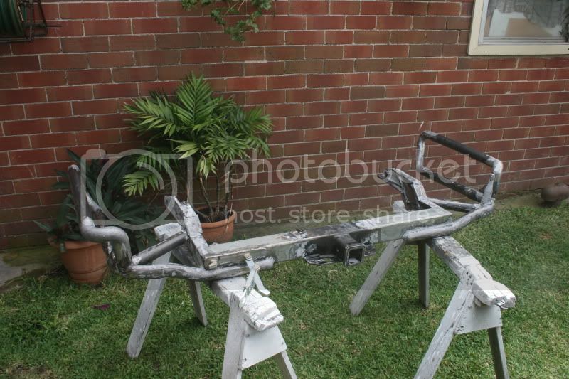

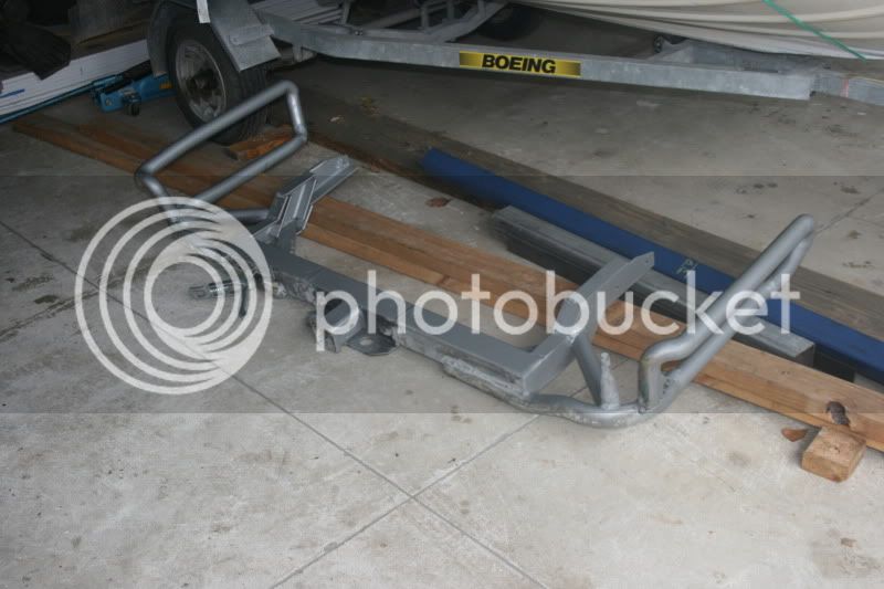

Welding the two sections together with the new towbar portion in the middle:

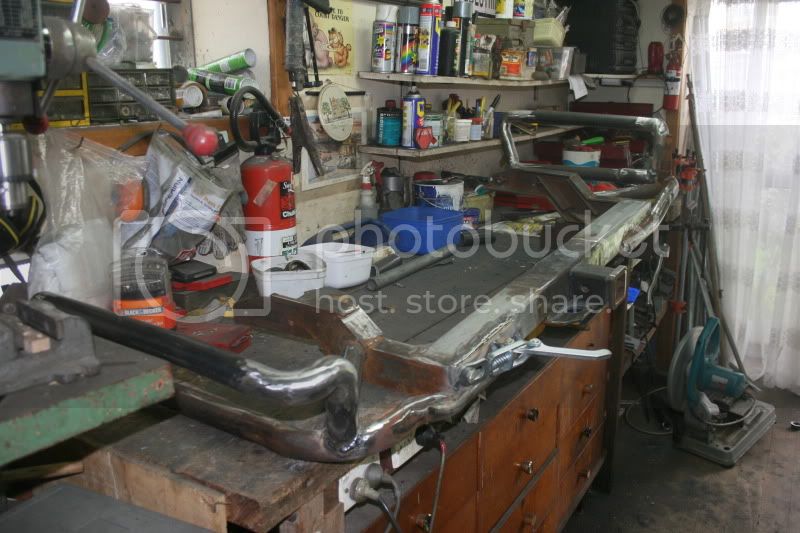

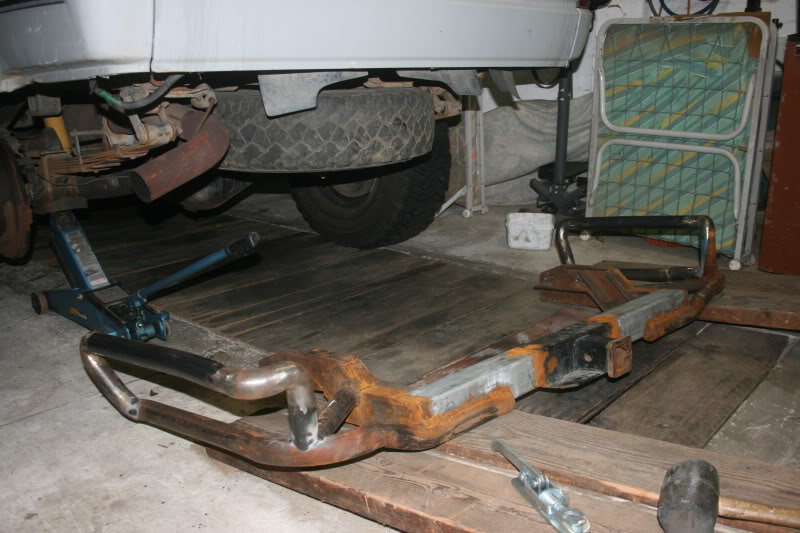

Welded in some tube going from the C channel mounts to the tube lower portions for additional strength, The high lift was there to maintain the correct dimensions during welding:

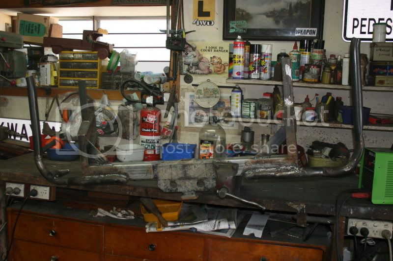

Now that was done it was time to knock up the upper sections to the rear bar, both sides will be the same height as the rock sliders:

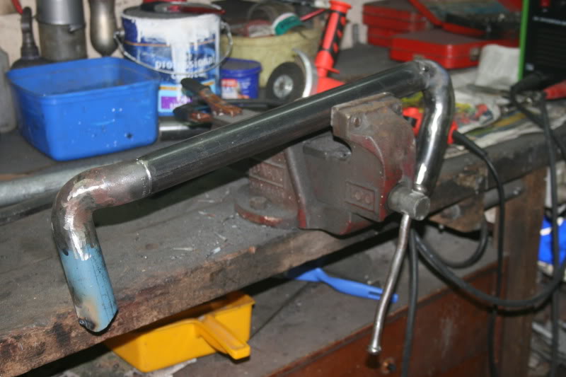

Here you can see it in progress, the fittings are just buttwelded to the tube then grinded smooth:

Here's the upper section tacked on to check position:

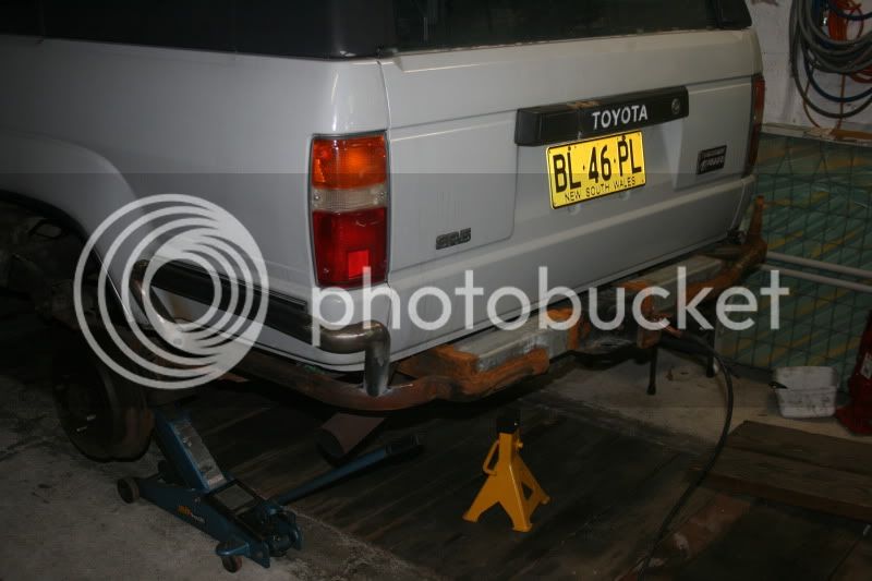

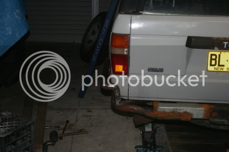

Another angle, the bar has a bit of surface rust as mr plod didn't warm to me driving around with no rear bumper to speak of so I put it back on half done:
Here's both sides tacked in place after final checking ready for welding out:

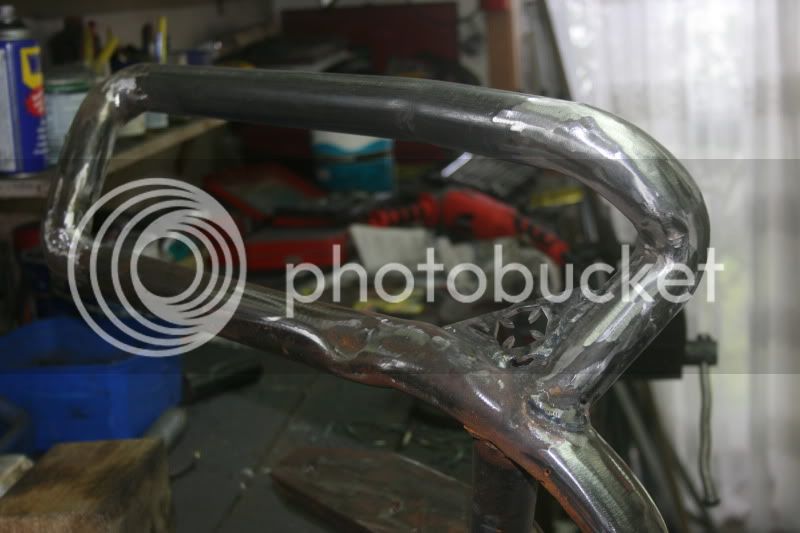

Had some laser cut gussets left over from a project a while ago so welded them in for a little extra strength, they have the maltese cross cut into them:
Here's the bar after I took to it with the flapper wheel:

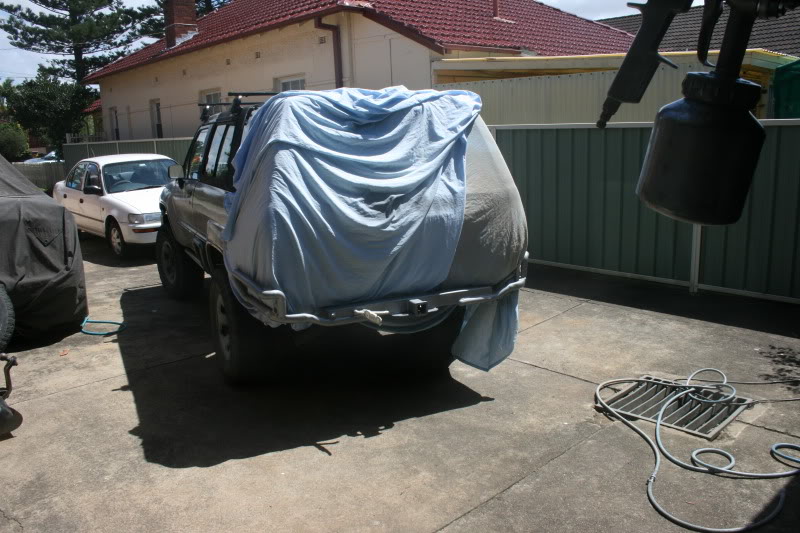

Here it is sitting outside covered in rust converter ready for a wipe off and a coat of paint:
Here it is after its first coat, mainly to get the rear sections that can't be accessed when it's on the car:

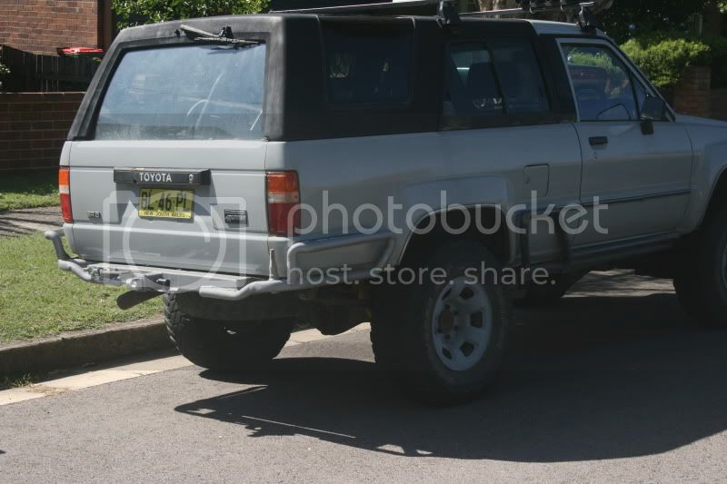

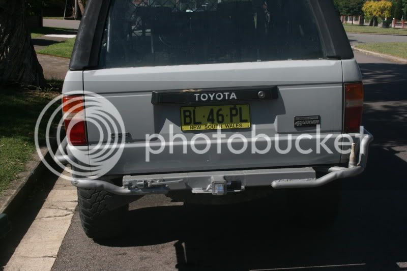

And finally here's the finished product with a recovery eye attached via a lockable receiver pin:
Another angle:
Final shot:

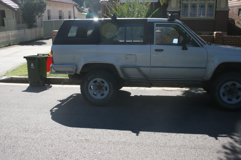

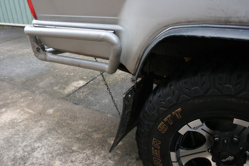

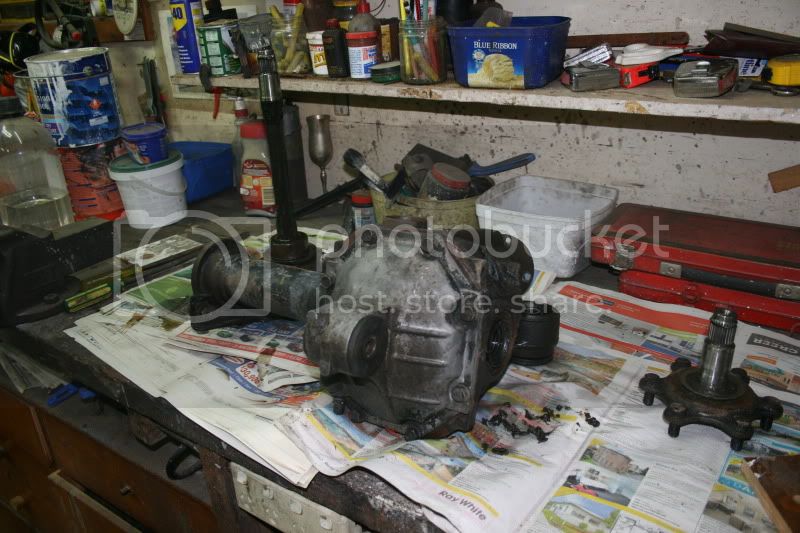

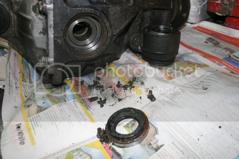

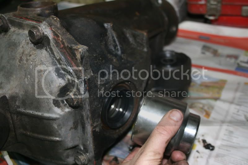

Hello again time for an update on the runner. There’s not heaps happening on it just trying to get it ready for a move to Sydney which meant taking care of a nasty oil leak coming from the side gears in the front diff. I also removed the chrome trim from the wheel arches and replaced it with rubber flexi flares. After that I knocked up a simple removable mud flap mount to properly cover the wheels.
The best part of the update happened after I came home late one night and logged on to 4wheelparts and started browsing. I woke up the next morning and found an invoice in my email telling me I bought some wheels. Online checkout systems are so easy to complete these days they are becoming hazardous. I went with some Dick Cepek FCII’s 16x8 in a -12offset.

Here’s the diff with the side gears pulled, they come out easy just a hammer and block of wood or a rubber mallet and they pop out
Old seal full of crap

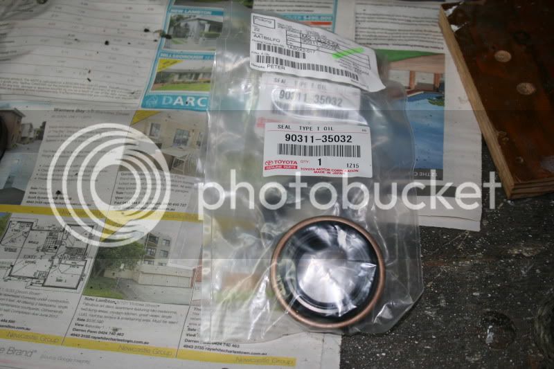

New seals with the yota part number
Getting the new seals in, this is the time you are happy you bought a large socket set if only to help drive in seals.
Nice new seal

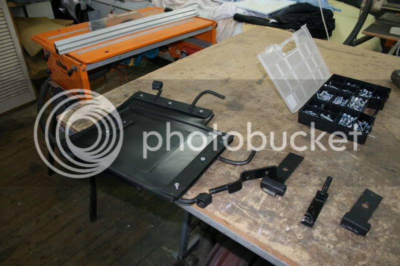

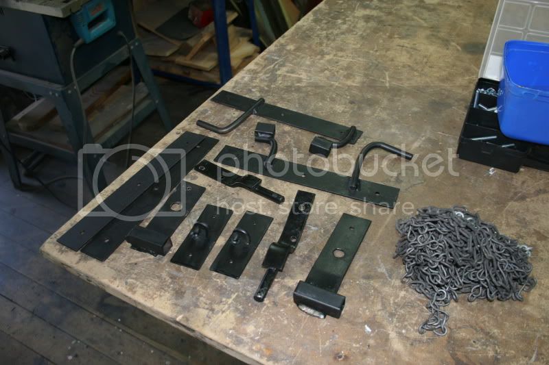

Mud flap parts ready for paint
Both sides ready for assembly
Both sides together, the remaining brackets bolt on inside the wheel arch
Side angle showing the mount points didn’t get a great photo but you get the idea

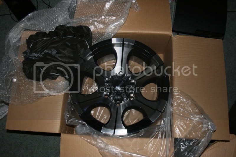

Came home from work one day and there was a large package for me

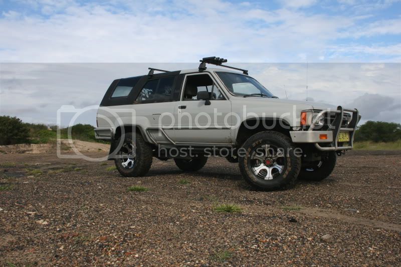

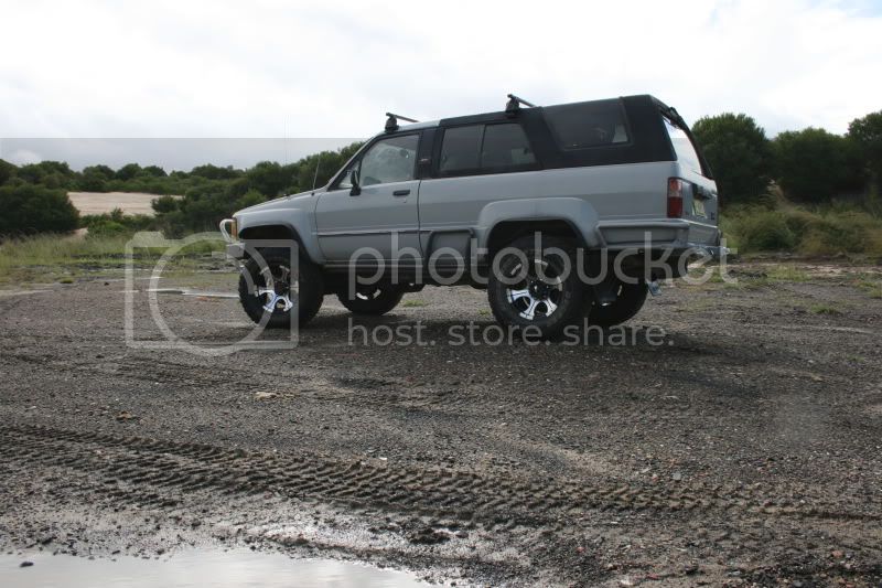

Here they are mounted to the Cooper STT’s, you can see the flexi flares as well
And one more
