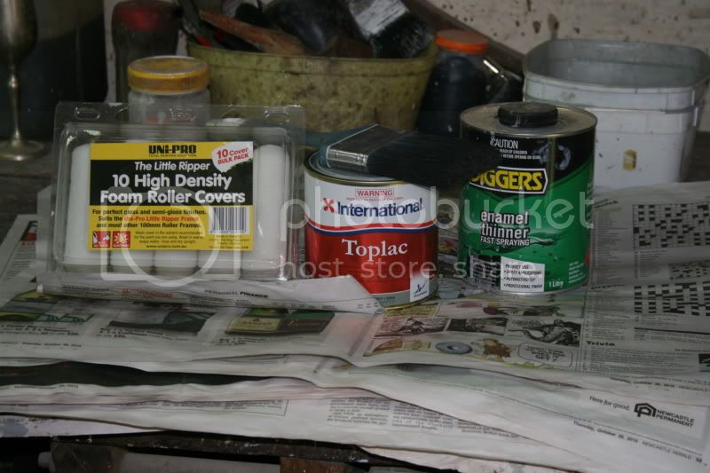

The materials:
I am using a foam roll on purchased from bunnings for around 20 dollars including 10 spare rollers. The idea with this paint is to roll it on the follow quickly with a brush to burst the bubbles, I purchased a good quality brush from bunnings as well (cost around 14 dollars), obviously not the most expensive but did not want to swearing at inanimate objects because a hair has come off and been trapped in my new paint job. I also bought a tin of enamel thinners. The paint is made by a company named International and the product name is “Toplac”.

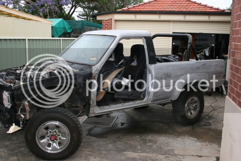

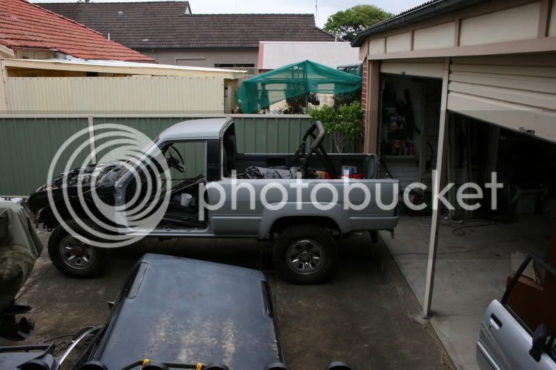

Spook with less pieces on her
Spook sanded waiting for a hand to lift canopy off
Another angle showing the engine cause it gives me a chubby just looking at it
Canopy off ready to roll.. literally!
Other side sanded and waiting

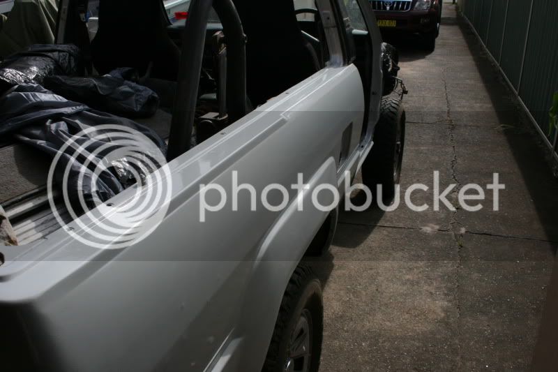

Better angle showing the gloss:
Another angle showing the paint:
Another angle showing the final paint:
