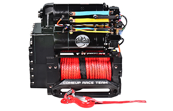

Taiwanese clone(ish) with three (!) 8HP motors:
