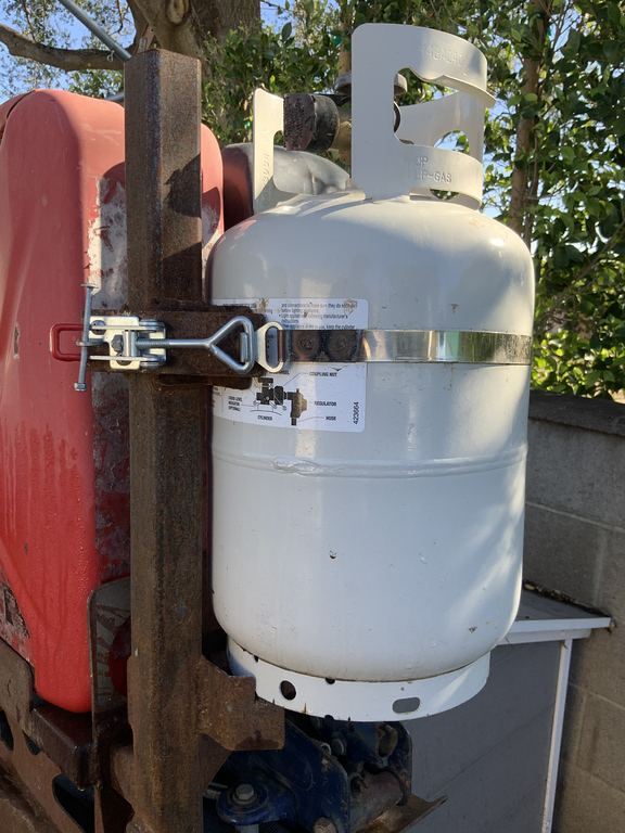

Thanks! Figuring out how to transport propane on the long dirt trips has definitely taken a few iterations. Realizing that we rarely used even 1/2 of a bbq tank and moving to the tall, skinny 2.5 gal tank has been a game changer.
