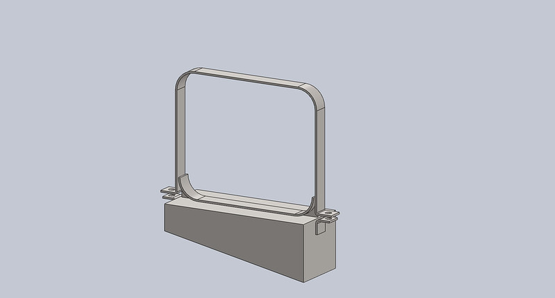

Perhaps the way to go is to put some saddles that the tank sits in on the mount, and then bring the top straps all of the way down to the mount - put the anchors for those bolts directly on the mount. One strap's worth:

I only showed one of either 2 or 4 straps as I expected that they'd all be the same. Mostly just to get across the design that I had for consideration. Looking at it now I think those little gussets under the existing lower straps would take a lot of the rocking out w/o needing to do a bunch of re-work. Maybe just weld the lower straps to the mount and extand the gussets down the front and rear sides of the mount?

Looking at it now I think those little gussets under the existing lower straps would take a lot of the rocking out w/o needing to do a bunch of re-work. Maybe just weld the lower straps to the mount and extand the gussets down the front and rear sides of the of the mount.
This would work well, creating a saddle out of the straps and hard mounting them at the same time.
Extending the gussets down the front and rear sides is what will make the difference.
