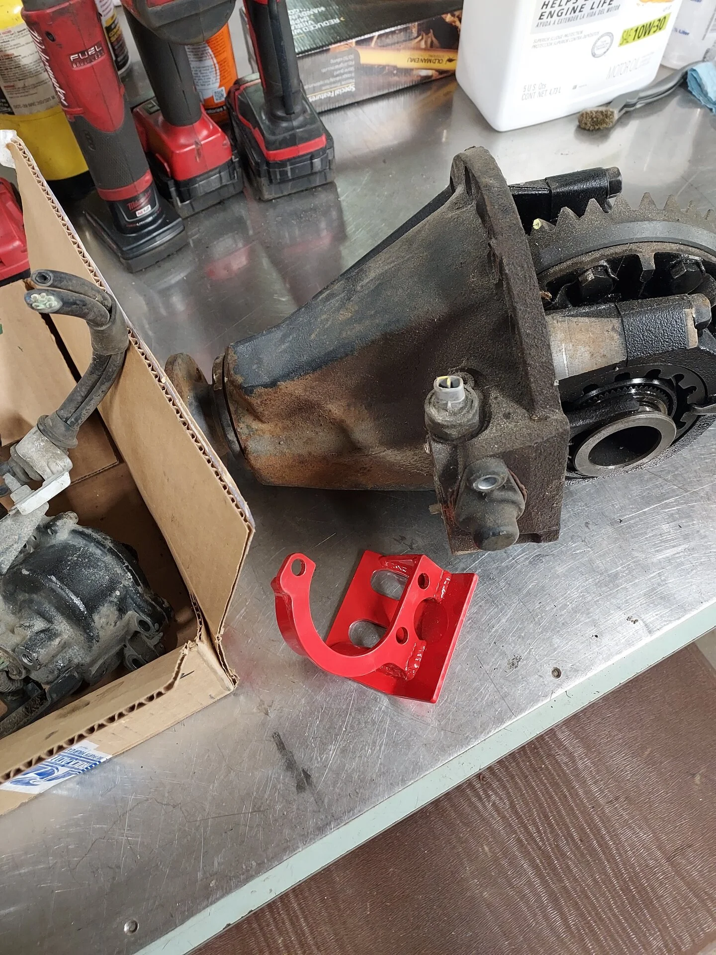

Here she is! It's been shuffling around my garage for years. Glad to finally put it to use. Paid $175 at junkyard.

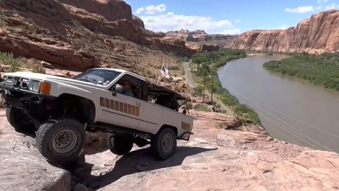

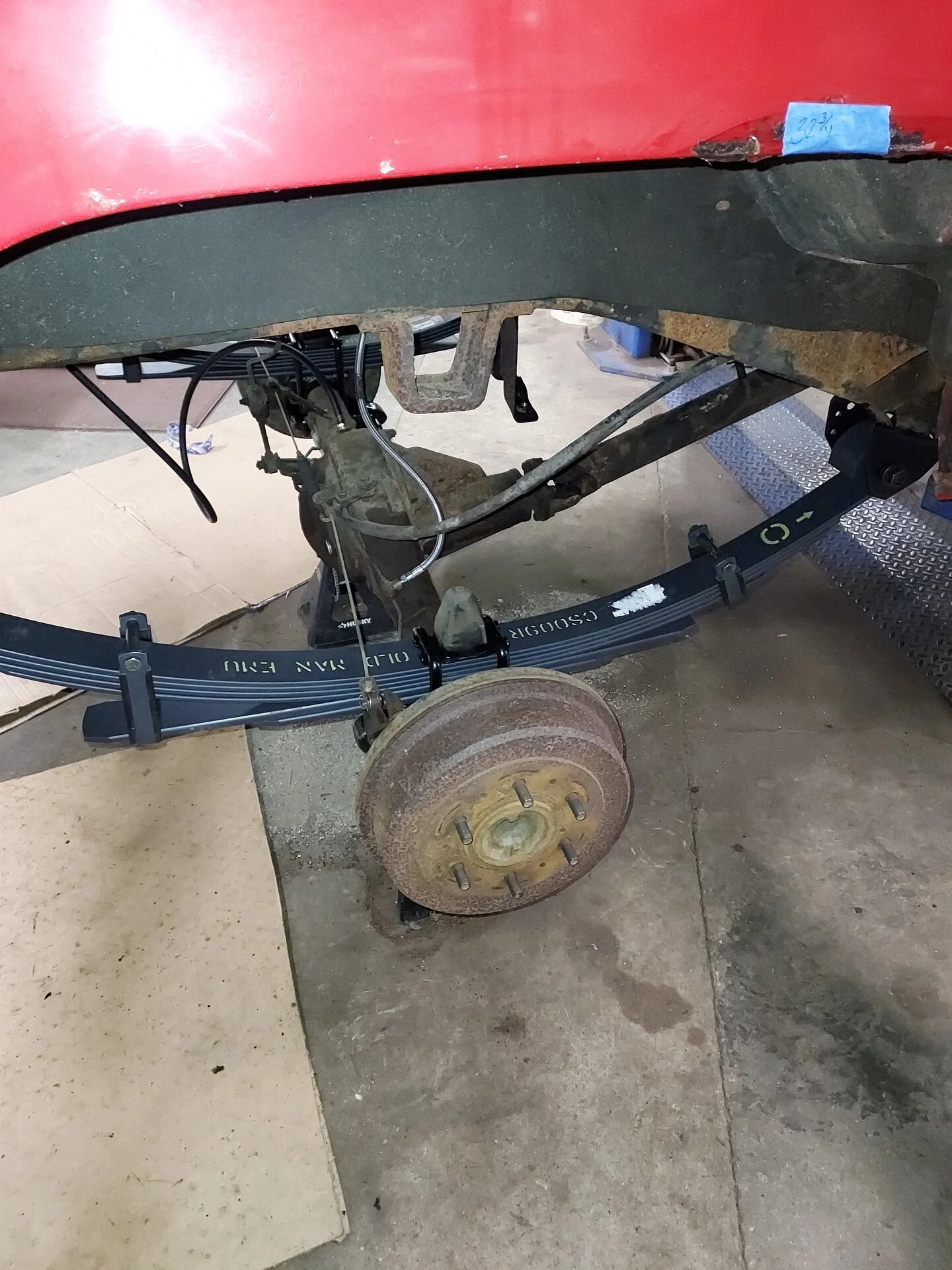

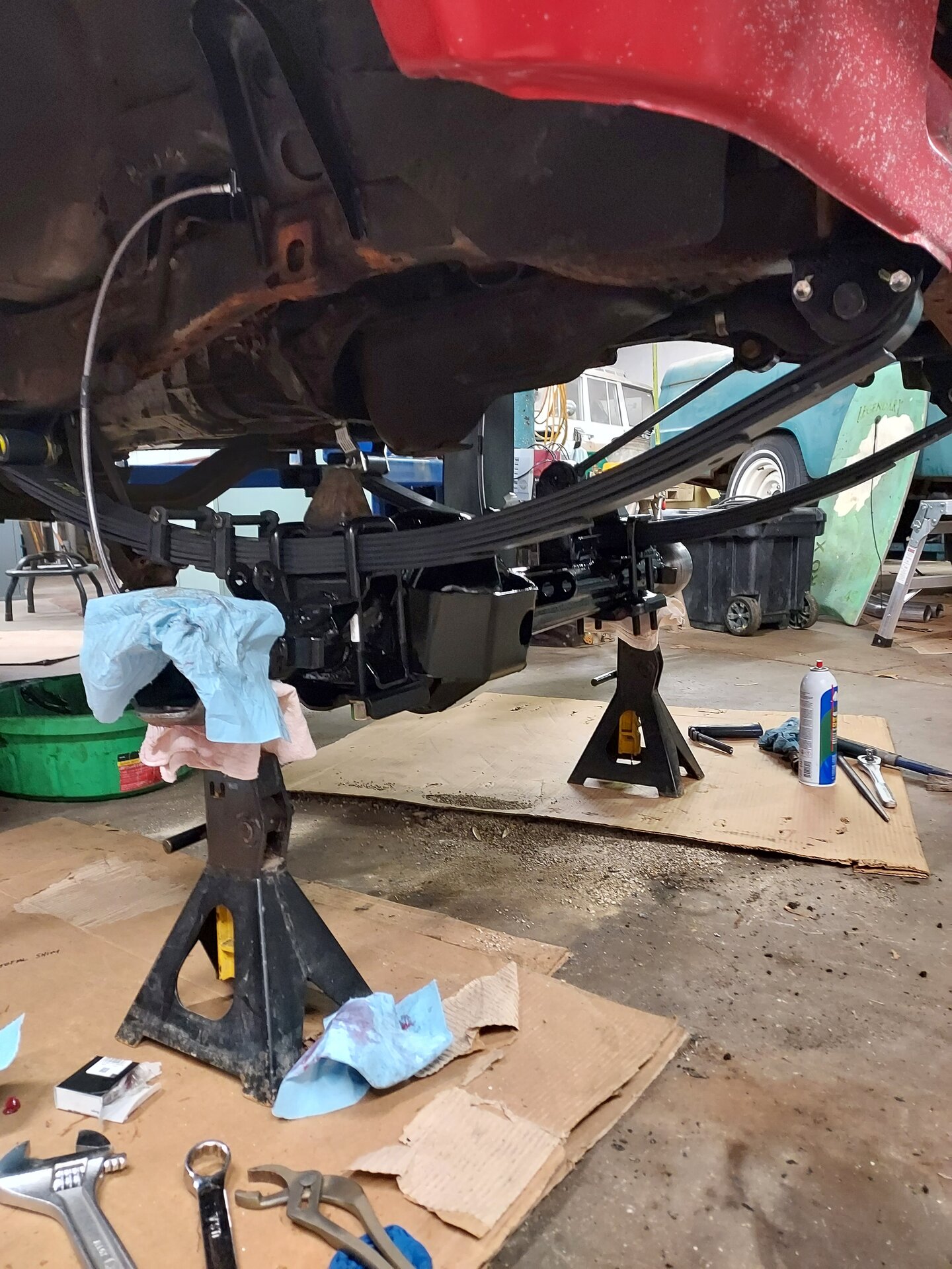

Per @84T4R's question, I have new OME springs, shocks and greaseable shackles. They've got maybe 400 miles on them. They're still stiff. I was thinking the truck would not flex at all off-road. I was kinda shocked (pun not intended) how well the springs worked on the trail. All four corners stuffed - even made contact. Now, I'm not in as much of a hurry to pull leaves from the pack.
How are you liking the OME set up? You said, you got the kit so i'm guessing you're using the upgraded greasable shackles? About to pull the trigger on new springs and going back and forth on stock shackles or upgraded greasable shackles
I like OME setup. I went greasable on mine. After seeing the condition of the old bushings, I figured a pump of grease every now and then is good preventative maintenance. They perform well offroad and are predictable on the road. (I deleted my sway bar) After some break in time and offloading the ride will improve too.
