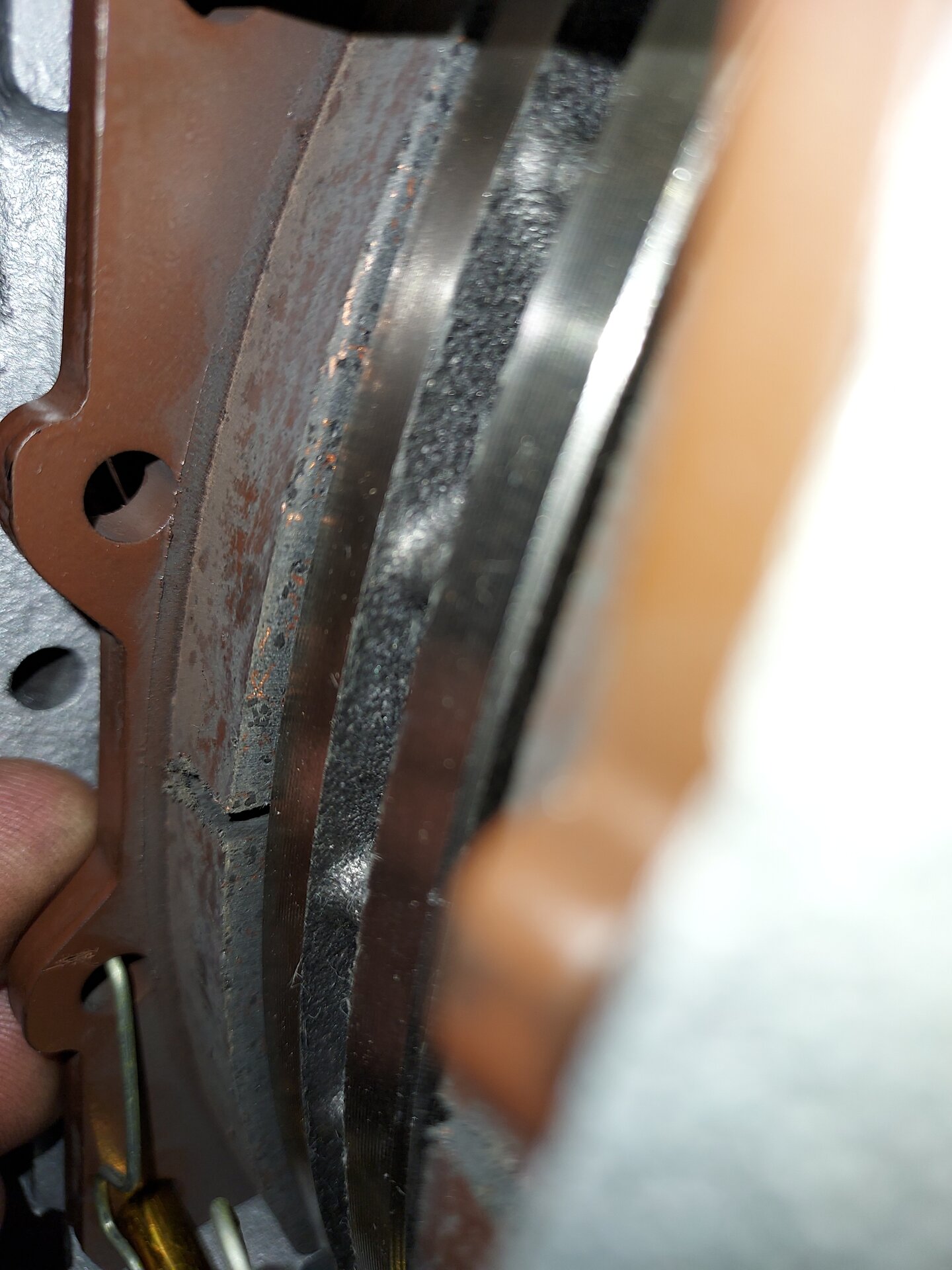

Finally got my calipers back but the pads don't line up with the rotor. I used FJ60 rotors and V6 calipers. Not sure what went wrong. Theres about an 1/8" overlap to the outside of the rotor. Any ideas?
Try reversing the pads. I seem to recall there is an inside and outside.
I'll try that but they're both equally sticking out.
Is there a difference in the V6 pads between say 88-94? I think I ordered 88 pads and the calipers are S13WB so 92-95?
Ok so looking at McGeorge Toyota online parts (30% off btw), there's multiple brake pads between 88-94.
From 03/1988 04465-35260 (what I have)
To 12/1993 04465-35140
T100 12/93 04465-35061 says this fits 94 4runner also.
I'm lost haha
I have S13WB castings. Not sure of year. And 35260 pads don't fit.
Might try the 35061 pads. Hopefully the contact patch is better

There IS a difference in V6 brake pads.
Left one is for an 88. Right is for a 94.
I noticed on 2 different 2nd gen 4runners I looked at, the pads had that ridge on the outside of the rotor. Wonder if the parts store sell a standard pad for all V6s?
No more overlap!

I'm glad you found and posted about the brake pads. I had the same S13WB calipers from a T100 on my truck and the last set of pads fit like that. I ran them with no problems. Must be what the parts stores sell like you said.
