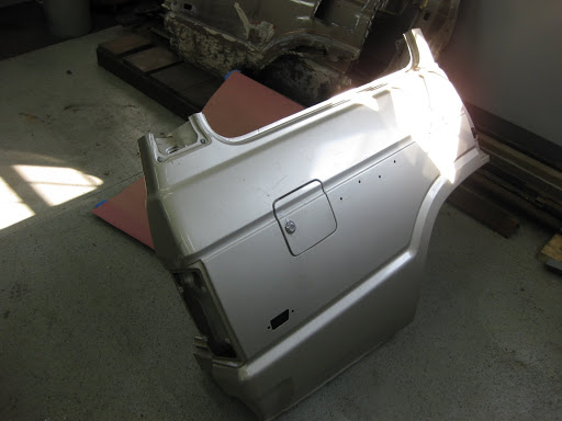

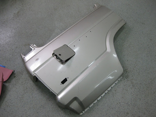

Alright Fellas! Time for a much overdue update. My right rear 1/4 finally arrived via Greyhound (after much prodding of my buddy in AZ). This thing is SWEET ;); no rust at all, not even surface rust. Beautiful!

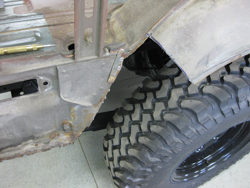

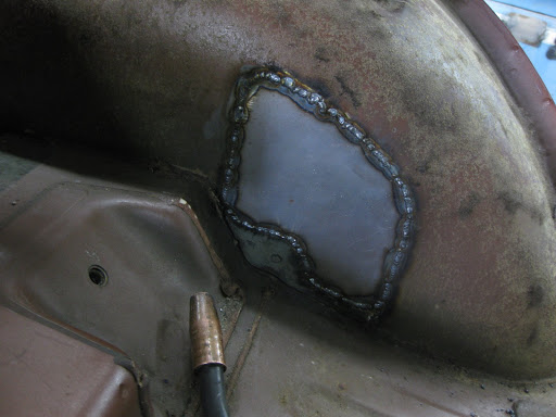

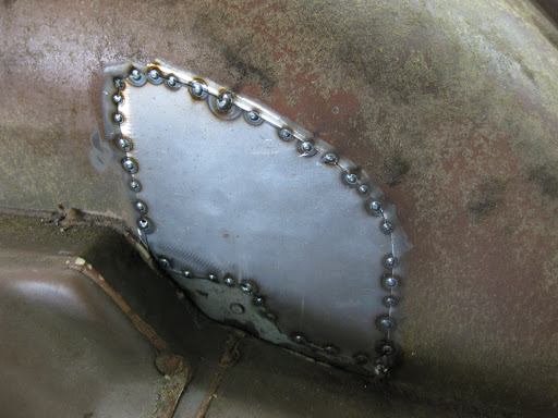

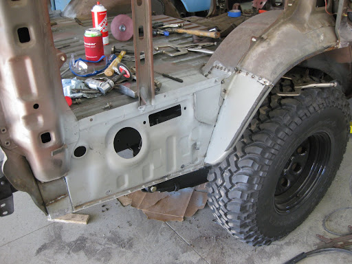

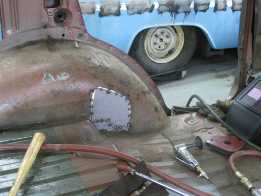

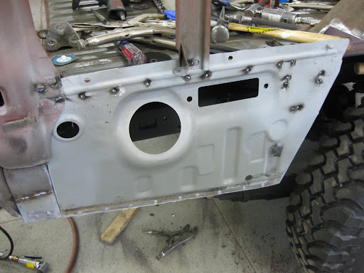

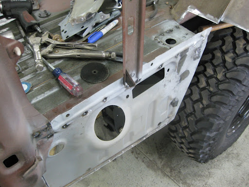

So, today I finished welding in my LR inner fender patch. After tacked in:
More tacks:
After stitch welding; I'll post more pics after I grind it down and flush it in:
Continued from above; post 2 of 3:

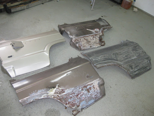

I also pulled the 1/4 skin of the replacement 1/4 today:
It's almost wrong how clean this thing is!:
Pic of the old and new 1/4's; just to jog everyone's memory:

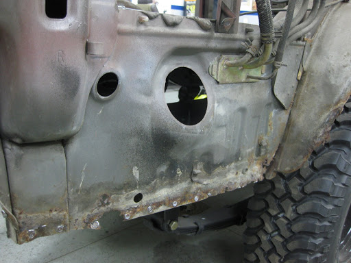

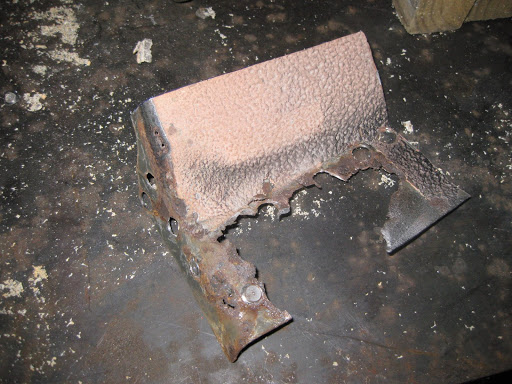

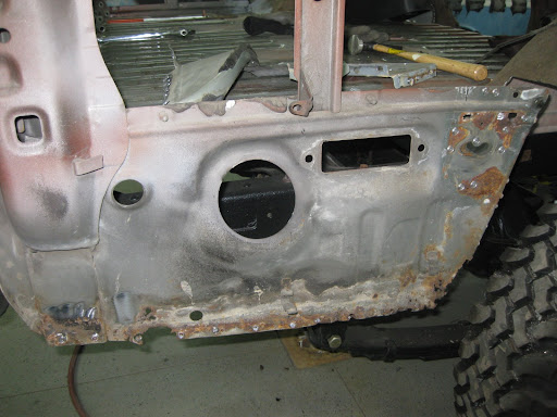

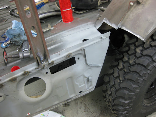

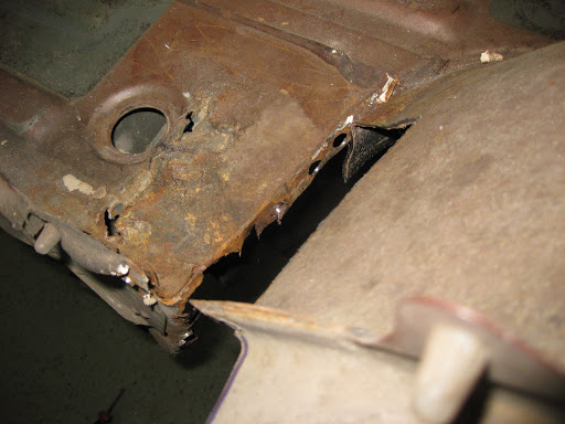

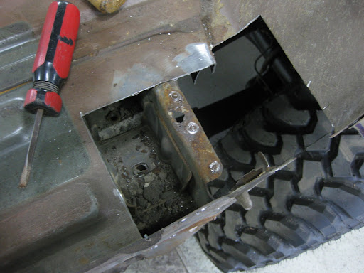

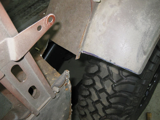

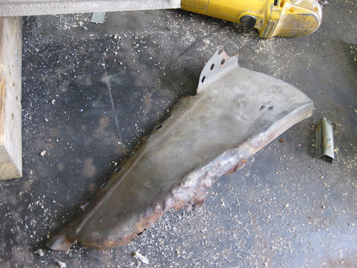

Next step was to start the "reconstructive surgery"; my old inner 1/4 and floor was so s***ty and full of rust. Here are some pics of my progress. Wheel well out:
Rusty inner wheel well cut out:
Continued from above; post 3 of 3:

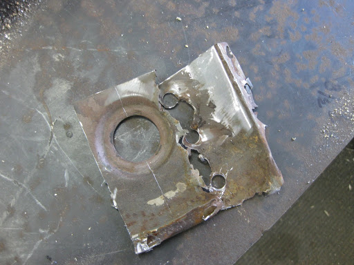

Pic of rusted out floor around body mount bolt access hole; can't explain how this rusted? The crossmember is rust free inside. . .

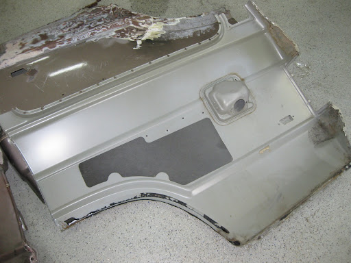

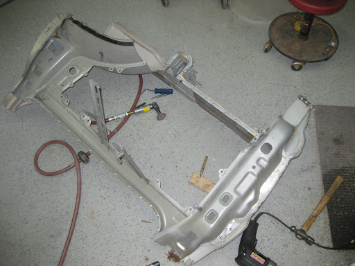

Check it!! Not much left of the donor 1/4!! :D

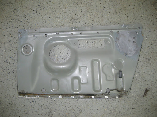

I decided to pull the entire inner panel as it was so clean and straight (and to minimize welding):
Compare to the current one:
Let me know what you guys think!:beer::beer:

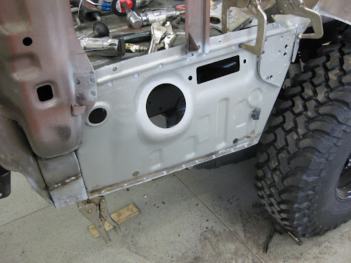

Kept plugging away at the 1/4 today. Here are a few pics of my progress:

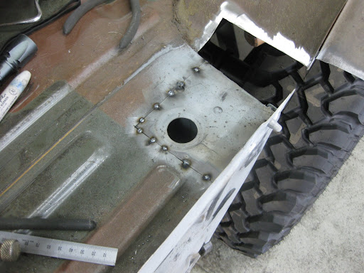

1. Test fitting, aligning to the marks I made prior to removing the old panel:
2. Tacking the panel in position; everything goes back together in the reverse order of how it was pulled off:

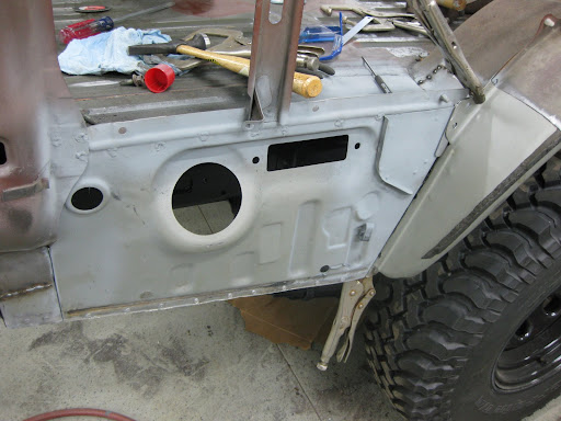

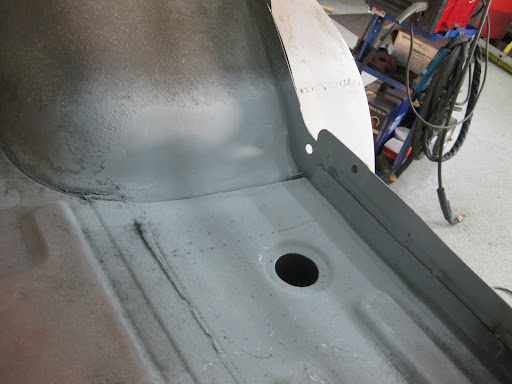

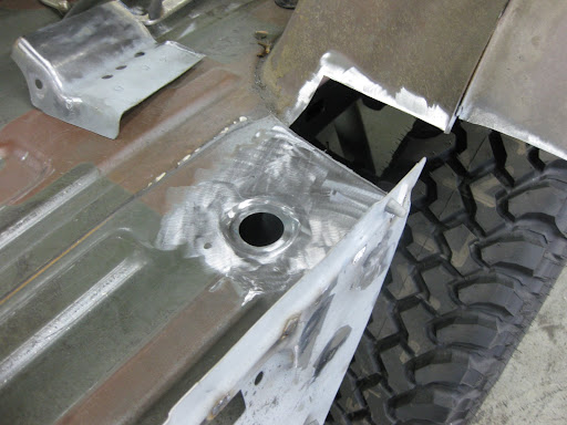

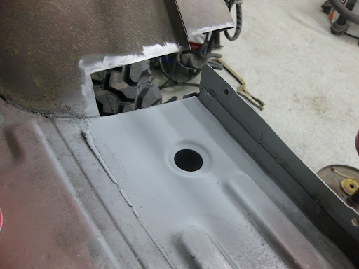

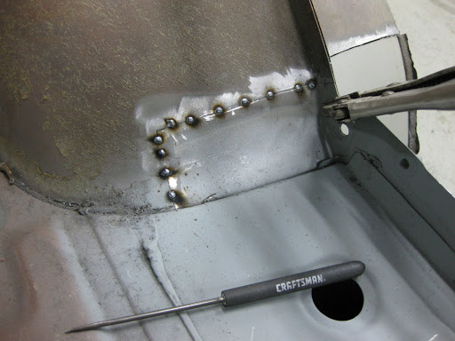

3. Tacking in the floor patch, after getting it flushed in and fitting just right:
4. Both panels welded in:
5. I was on a roll and forgot to take a pic of the floor after final welding it in. Here's a pic after smoothing the welds. All I can say is, WHAT PATCH?? ;)

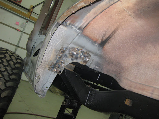

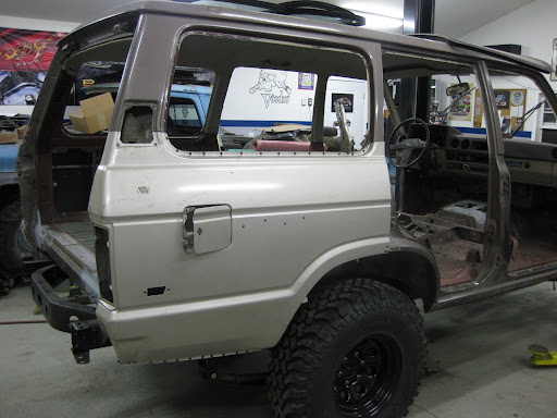

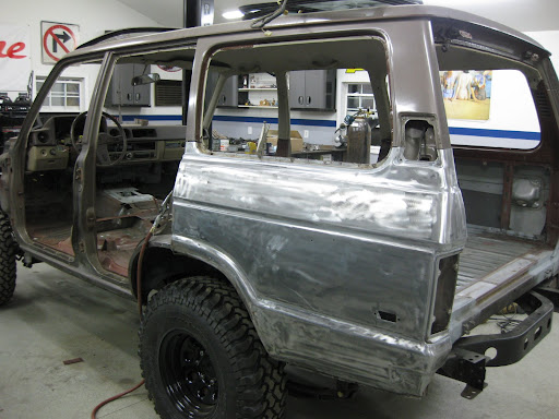

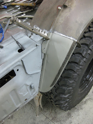

Stared working on the rest of the quarter. Got the outer brace welded in and flushed out:

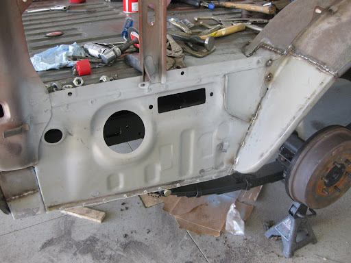

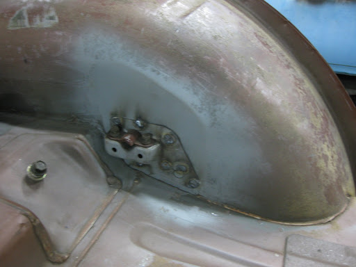

Started welding in the inner wheel well section; it's amazing how close the 2 stamping are; excellent manufacturing capability for an 80's vehicle:
Test fitting the inner wheel well:
It's coming along nicely, Friday it looked like this:
and today we're here, so good progress:

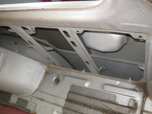

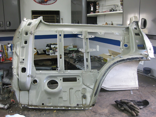

Finished flushing in the welds on the RR 1/4:
Finished flushing in the welds on the LR inner wheel well:

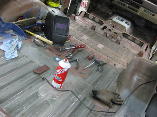

Hard to see in this photo, but I also got the entire floor sanded, ready for bedliner now:
And, a couple teaser pics:
I couldn't be happier with the fitment of the RR 1/4 skin. I still have some dent and flange repair to do on the LR 1/4 to make it perfect.
Let me know what you guys think! :beer:
