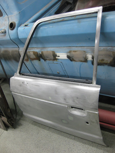

Hey guys, been a bit since I posted an update. Have no fear, I've still been working on the 60. . . it's just been a very busy time in my family's life. My wife and I just found out we are pregnant with our first child!! And, as if that wasn't good enough news, I have received a promotion at work (which sends me to Japan for the entire month of January; :frown:). . . it's been BUSY to say the least!!;p
Anyhow, on to the pics. I'm still focusing on the body work; I'd like to get the body in epoxy primer before leaving for Japan (to curtail any rust, etc.); it's a lofty goal!! Here is a pic of the driver door, it's ready for primer:

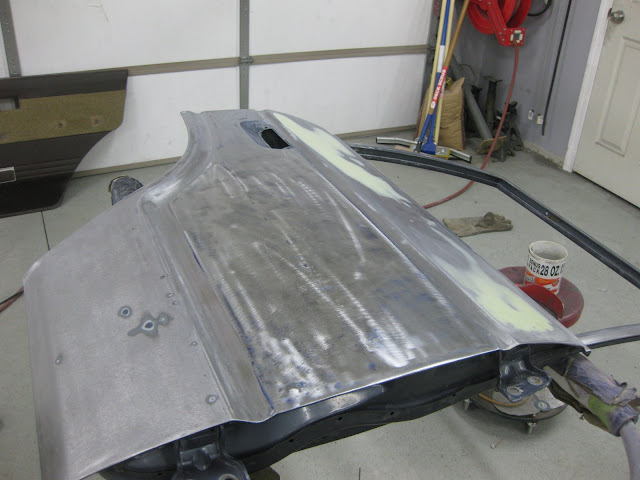

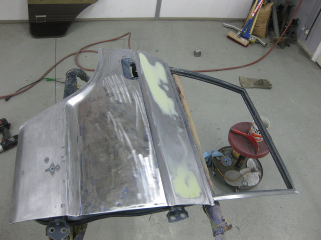

I've also been working on the pass rear door (worst, if you recall). I've made a ton of progress on the crease in the lower panel, and have skim coated body filler on the upper dent repair (roughly 1/32" to 1/16" skim coat):

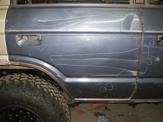

Pic of pass rear door (before) for reference:
