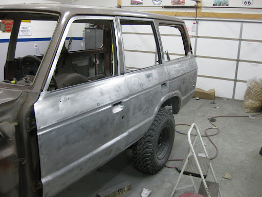

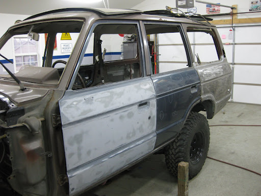

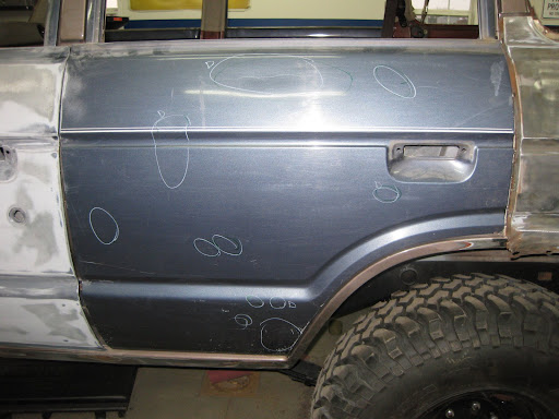

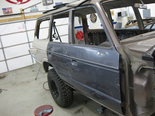

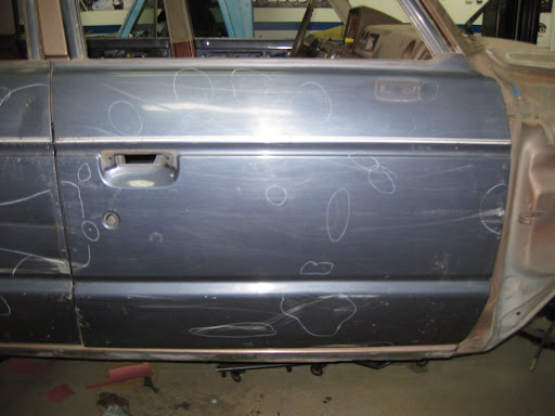

Just kidding, the drama continues. Hung the doors today. And while they are 100% rust free, they are no where near dent free:
Looks like I'll get plenty of practice with dent repair. . .
Right front (2nd worst):
Right rear (by far the worst):
Left rear:
Left front (the best, no dents):
Wish me luck. . . .:beer:

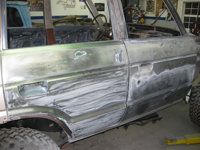

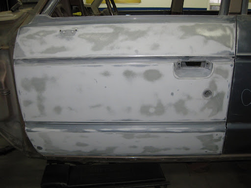

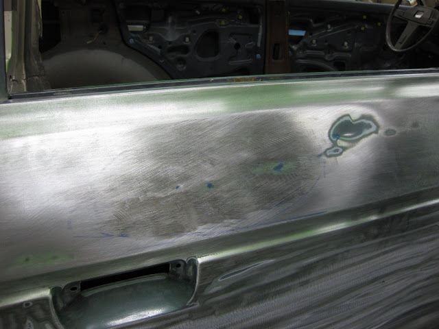

Got more done on the 60 this weekend. I got the drivers door sanded, there are only a few dings that will need attention (areas that still have blue paint):

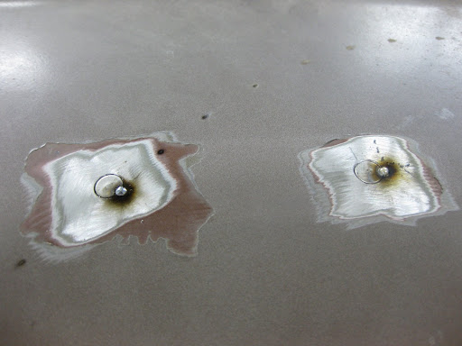

I got all of 20 the holes welded up in the roof (from the janky roof rack the PO installed):
Managed to melt the headliner in one place doing this :censor::censor: guess it gives me a reason to replace it. . . mine was pretty grimy anyhow (that's me trying to justify it to myself).

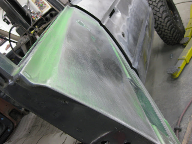

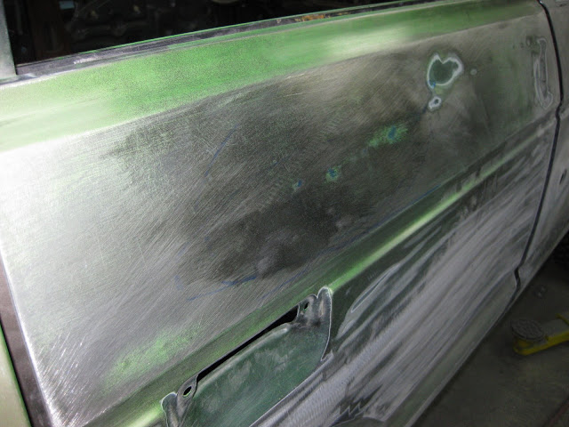

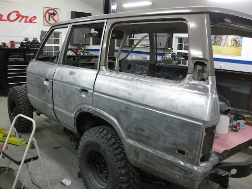

Continued sanding. . . this has got to be the worst part of the project. Drivers side is getting there:
I've changed my mind on how to approach welding in the 1/4 skins. I think I am going to work on getting the doors lined out and hung properly, then weld the 1/4's in. This should ensure that they line up properly. :cheers:

How are you sanding the doors? DA? hand? flap disc?
I'm using a DA with 80 grit. Admittedly, not the fastest. But by keeping the DA flat against the surface it allows me to easilty identify all my dents and dings for later repair. I don't have a well enough trained hand to find the smallest dings yet, so if I used a flapper I'd have to go back and spray a guide coat and then sand with a sanding block (which I may do for the 2 worst doors).

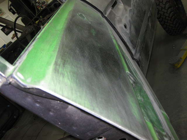

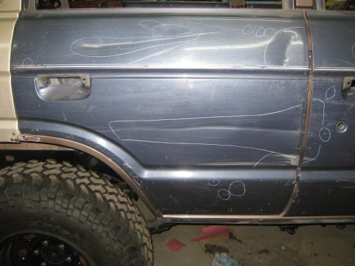

Kept working on sanding the doors down tonight. I got the majority of the passenger rear done, but had to try my hand at repairing one of the dents in the top of the door. Here is a before picture of the RR door; note the long creased dent in the top middle of the door:
After a little dolly work and a couple passes with the shrinking disc. This is my first go at doing any body work like this, but it's turned out really well & seems like it won't be too difficult (knock on wood):
One down, only 1,000 some odd more to go!!:cheers:
