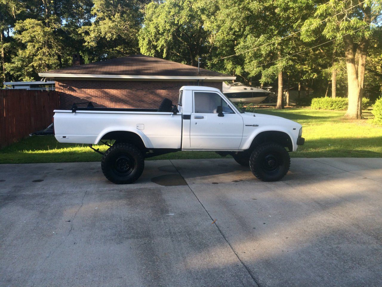

This is my currently setup. All bolt on. Caution... Smacking your face on your steering wheel can occur

I'm bored so
Debating on color of rims
Should I leave them white?
Black?
Or
Gray?
Allow me to be bored with you.
I am looking at replacing the alloys on my white 1st Gen 4Runner with the Tundra 18-hole steelies.
They come in black and I am thinking about keeping them that way initially. The black steelie looked great on my tan troopie, I would imagine a black wheel would look good on a white truck.
Plus, black will hide the rust stains when the wheels start to age;)
Looks good on a white 80:grinpimp:
I agree. White trucks look nice with black rims.
I might just do a quick black spray paint on the rims. If I don't like it I can easily change the color back to white or try out the landcruiser gray color.
