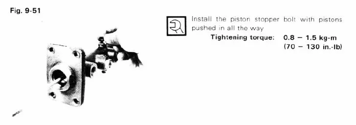

Update... I found an old thread here on mud that cleared up some of the issue. Don't take the bolt between the ports out thinking its a bleed point.... it locates the front piston. I put the master back on the bench, opened her up, fixed the front piston, bench bled with lines into the reservior, re-mounted and started to bleed the four corners. Went through two liters of fluid but still have air in there somewhere. Just a matter of more bleeding I think. I put out a call for help to the locals and should have a few guys over tonight to clear this up and hopefully get the locker in too.
Update... I found an old thread here on mud that cleared up some of the issue. Don't take the bolt between the ports out thinking its a bleed point.... it locates the front piston......
Yikes!
I'm surprise your front piston wasn't destroyed by the screw if you put it back in there and tightened it without first having the pistons pushed in all the way:
(Sorry for the poor quality of this image. It's supposed to show someone pushing the pistons right forward using a phillips-head screwdriver while inserting the locating/stop screw. Without the pistons pushed forward like that, the screw-hole would normally line up with the some part of the front piston!!!!)
It's good that you found the problem though.
:beer:

Brakes fixed. I f'ed up the front piston when I took out the retaining bolt. I took it totally apart and used the front piston from the old one and the seal off the new one. Just like the prophet lostmarbles suggested.
