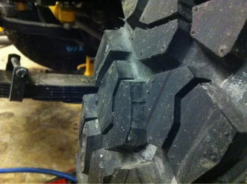

You cant adjust camber/castor unless you shim the springs. If you want to lift the tires and put the axle on jacks the you can rotate them and run a chalk line then measure to centers. I find it difficult to get a straight chalk line, and the chalk line is a bit wide.
Its a bit difficult to see clearly the exact measurement with a tape measure on the lip of the metal rim, but after messing with it to compare front to back a couple times while you spin the tie rod you'll get the hang of it.
I did Ian's on saturday this way, maybe he's got some feedback?

I read about using a nail into the tread to adjust toe. I take a small finishing nail and push it a little ways into the tread to hold it is all. The front end would be on jack stands at this point. Then spinj tires so the nail is at the front.... and rotate back then measure teh distance at the back and adjust accordingly.

Did some more work last night. Toe in was actually toe out about 1/8". Changed it to toe in 1/8". Made a noticeable change in the randomness of bumpsteer. Used my sharpie-on-a-stick method to mark the tire.
