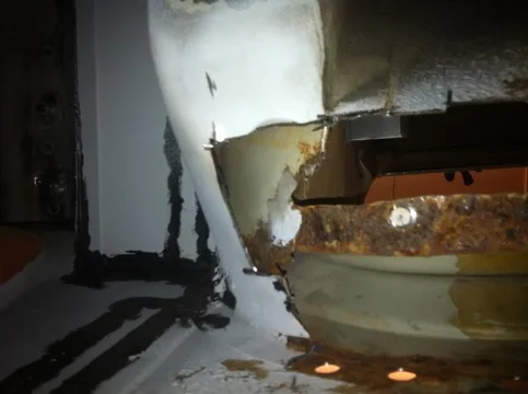

You can see where I cut out the inner rocker

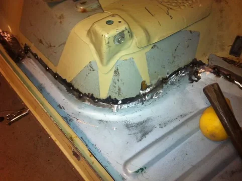

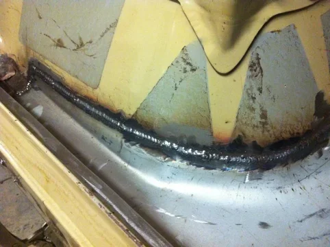

I think I will just take the spatter and the high spots of weld off and leave the rest of this weld rather than grind smooth. It is all covered under the mats and I would like to keep the strength.

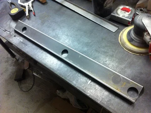

Here is the inner rocker patch I made. I just re-used the holes from the original... they weren't rusty at all.

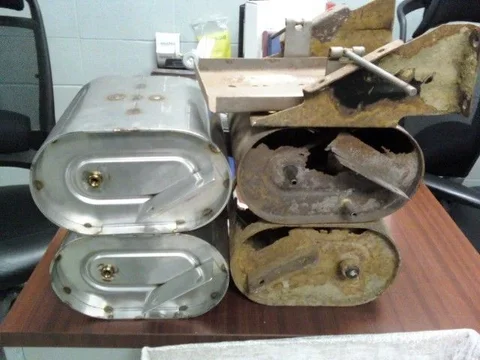

because I had to take it off for floor access I took the vacuum tank off the bracket and found a possible reason for the high/hard brake pedal. It had enough rust caked on it to likely seal it but the hole certainly wasn't helping matters :lol:
Been there, done that. I don't have any of my reservoirs in stock and don't feel like starting a batch from scratch. This tank is in the best shape I've ever seen for an original so I already blasted and patched the hole. It's at the powder coaters now. Here are a few shots of the stainless ones I've made before.
If you need to make it worth your while to produce one for yourself as a backup, I will need one or two eventually. I don't think mine is in the best condition.
I'll make some maybe in the spring. Right now I need to licence this rig and build tailgates and a couple beds. In fact I'm working on tailgates today but here are a coupla pics any way.

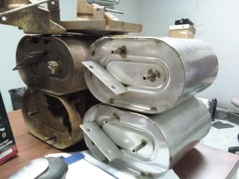

Summore
And more
And the tank
Blasted, patched and final bead blast before powder.
No rush... My truck(s) is still in pieces.. Great looking work!
