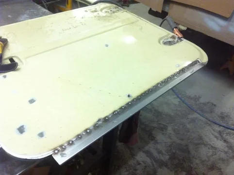

Applying lessons learned I started on the passenger door.
I started by cutting away all of the rust on both sides. Then I tacked in the outer skin patch.
Having already botched the other door repair I went to the extreme to keep this weld flat, straight and not oil-canning the door. I did: one set of tacks from end to end. Then hammer each tack to flatten it a bit and stretch it a bit. Then grind of the excess metal down to the surface. Then repeat. Repeat until the seam is welded solid.
And that's where I am now. I have the inner patch on and just have to close the corners up to finish this door. The second time was the charm and the skin is flat and true. I will still skim it with bondo but only to make the paint smooth, not to flatten the door. If that makes sense.

When yer hitting it there is no real way to tell. But once you're done the end result is noticeably better. You want to make sure you support the backside with a solid chunk of steel and get that nice "ting" when the hammer hits. otherwise yer just denting the panel.
I usually finish all the tacks to form a full weld before getting out the hammer. But on this second side door I was paranoid and did about ten tacks evenly spaced, hammered them and then ground them flush before doing another set of tacks.
As far as inspecting as you go, on this panel I could see my garage lights reflecting in the paint. As long as my fluorescent bulbs looked straight I was golden. I also used a straight edge but most importantly I made sure it wasn't "popping" in and out (aka "oilcanning")
Gauging the stretching. I have never stretched it too much no matter how much hammering I've done. Its more like "minimizing the shrinking"
The door still had shrinkage but it was kept to a zone within an inch or so of the weld. It didn't translate into the main skin. It will still get filled and sanded but the fill will be like 0.02" rather than 0.25".

So whats wrong you ask? You can't see it well here and I stopped taking pictures cuz I was dealing with the issue. You can see a bit of it in the third pic here. The weld along the bottom of the outer skin shrank. That put a hugh oilcan effect into the door skin. It bulged up and down and up again. It was horrible.
For those that don't weld I'll attempt to explain. Welding is melting metal. Molten metal is hot. Hot things expand. The $Hitty part comes when hot things cool. They shrink when they cool. They don't shrink much but when you weld a line, even tack,tack,tack a little at a time it will shrink enough to notice. Normally I would deal with it by hitting it with a body hammer and dolly. The impact of the hammer mushrooms the weld bead and effectively stretches it back.
But I can't put a dolly behind this weld because_I_already_welded_the_inner_panel_in_place. :bang:
