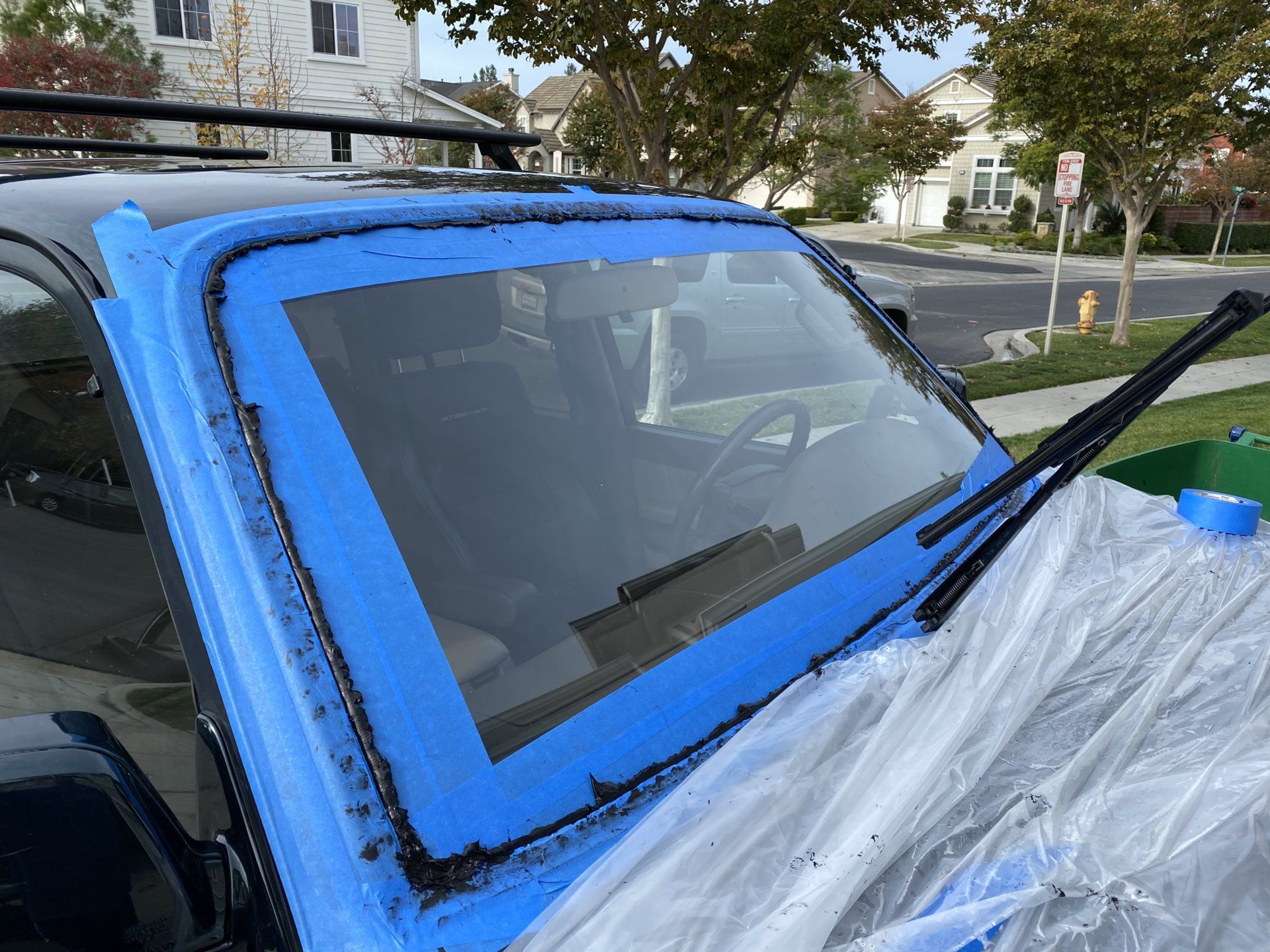

Used the method outlined by FireTruck41 over the weekend with SikaFlex P2G.
The SikaFlex was super viscous and extremely sticky, but appears to have worked - at least for 1 day of rain...
Any update on the longevity of the repair?
