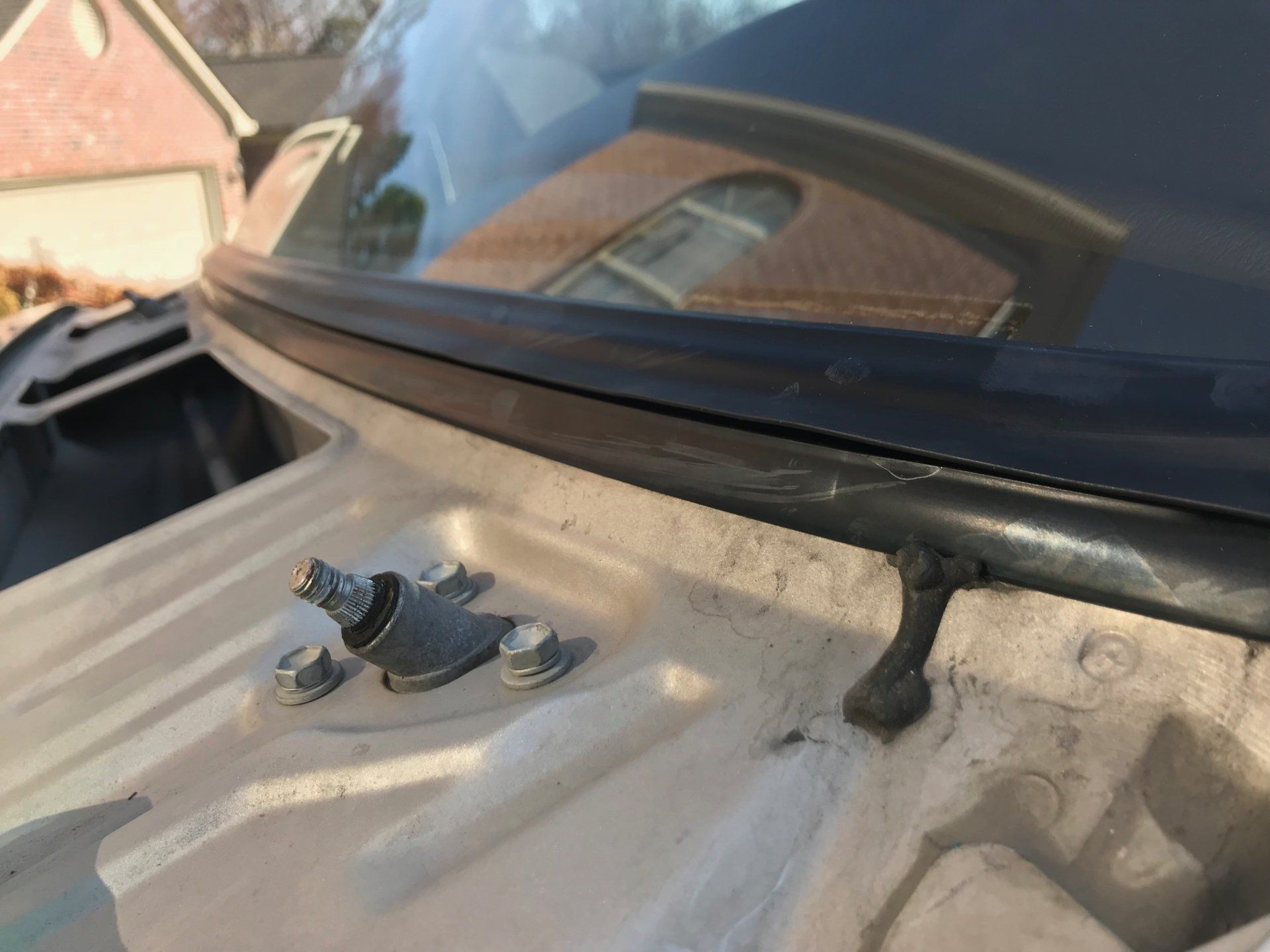

It had probably been leaking for some time but with living in Arizona and covered parking, it never really presented itself. lately however, it was very apperent - soaking wet carpet in either the driver's side foot well or the passenger side, depending on the lean of the truck. I read up on all the other posts and ordered the new gasket.

I did some research on glass shops in the area to find some place with good reviews. wanted to stay with a smaller local place because i figured they would be more apt to listen to the FSM instructions etc. Unfortunately, none could get replacement glass or if they could, it would have to be ordered and shipped in which made the cost crazy high. The only other place was safelite. i've used them in the past with good luck and really didn't have any other choices. The day before i pulled all the pieces to get it ready and printed out the instructions. Could not believe the old gasket! Never seen such a cob job window install - can't believe it didn't leak earlier

when i went in to the glass shop i was ready for a fight with a know-it-all manager etc but they were all super. very appreciative that i brought in the instructions and willing to listen. they knew these were tricky to install so they had their best guy on the job with a few others to help and learn. came out beautiful - very happy with the results! In the end, should've had it done in Arizona because i had glass coverage with my insurance - none in Tennessee so final tally was $320 for the windshield and $54 for the gasket

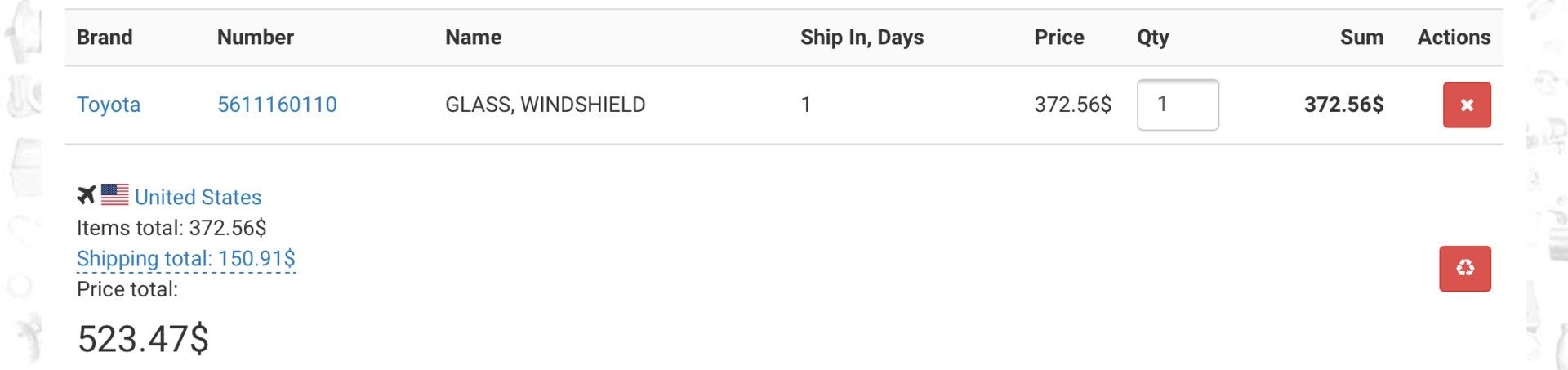

I am fairly certain the bronze windshields are gone in the US. I was told I received the last 2 in the US back in 2014/2015. They were close to $1100 retail at the time.
