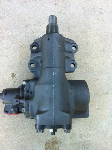

Rebuilt PS gearbox from scotia.
Rebuilt with 105 shaft and a warranty, I believe.
Swapped the box from acertyrx and the 105 shaft from Beno for one scotia had on the shelf.
Textbook transaction. Thanks, Patrick.
TimKorn and StainlessDoc were sent the unused PS box rebuild kit as the down on the OBA brackets. Looking forward to, as well.

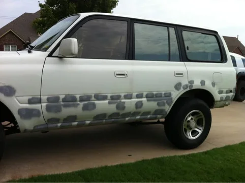

1. Cut and roll outer front and rear outer fenders ~$540
2. Weld 162 holes and fill, primer ready $780
3. Sunroof delete ~$1k
4. Raising headliner with new, molded ~priceless.
Modifying the existing to disguise the sunroof ~$700 (with a little for a custom console)
All above based on the interior being stripped and they work on in between other jobs.
Won't touch it otherwise, but I have the option to pull what I can and bring in, so I can continue making progress on all else.
I've asked the TLC deity to grant me the serenity to accept the work I cannot do (within a reasonable time frame) the courage/skills to do the work I can, and the wisdom to know the difference, with money to fund.
All points to me NOT doing this.
Why the trouble to weld?
Because I'm going to paint OE white, and don't want it to look like any of the work was ever done.
Agreed. Have a couple of options to cut down on time. Hoping they come through.
May keep the sunroof, mickeyt. Not what I want to do, but can't find a uncut liner, and I don't think it's worth the effort/money by doing it right and swapping roof skin, custom molded liner.
Scraps the overhead console, which sucks, but looking at reworking the center console for more functionality.
Hour of free time, so stripped what I could in preparation to weld the 162 holes Thursday.

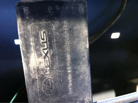

And trying to figure out how to, or of it needs to/would be a potential future issue not to remove the OE trailer light harness.
Can unplug the pinned lead, easy enough, but should it be removed?
Looks like a mess.

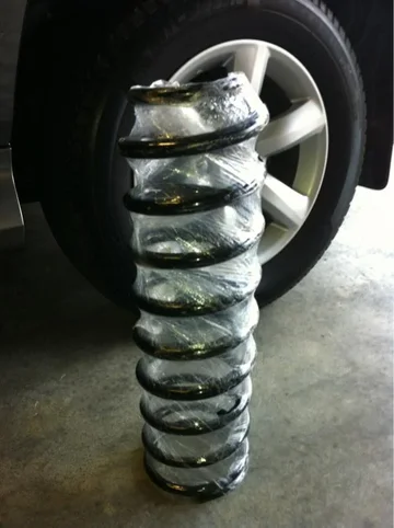

Here's where I'm at on shocks:
Front shock dimensions base of pin to base of pin
4" Front coil free length 24.4094" (620mm)
Suggested shock travel
29.9212" extended (760mm)
18.1102" compressed (460mm)
Rear shock dimensions from base of pin to center of eye
4" Rear Coil Free length 23.0314" (585mm)
29.1338" extended (740mm)
17.3238" compressed (440mm)
Planning on Radflo's. In discussions with Glenn, the shock travel numbers above are more than specified for a TJM 7" lift, so its been advised to get all bolted up, mount tires, then cycle.

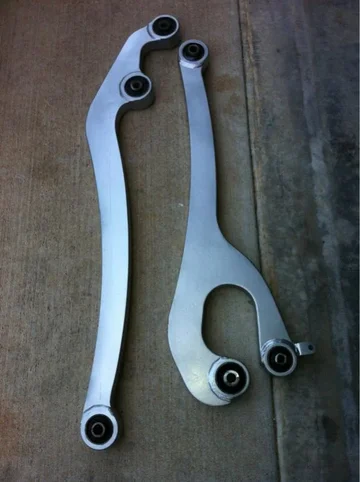

Ok. Rear. With 36's. Your wheels are going to be the restricting factor, but not by too much. Forget about open lengths, the compression length is what governs your open length. Rear shocks, You want from middle of pin to middle of eye is 490mm. You will need to extend bumstops by 5.5". Some modifying of mudflap area behind wheel is required. Unless you shorten control arm lengths.
Your front doesnt really matter much. You wont have the travel to even max out 10" shocks NORMALLY. But you have superflex arms now. Shock compression (pin to pin) for the front will be 535mm. All the pin ends can have rubber stop cut down or extended to fine tune. But those measurements will be extremely close. Extend bumstops in front if going to jump it. Otherwise dont worry about it, it will restrict your amount of wheel travel (compression) as shocks are further in than coils/bumpstops.
