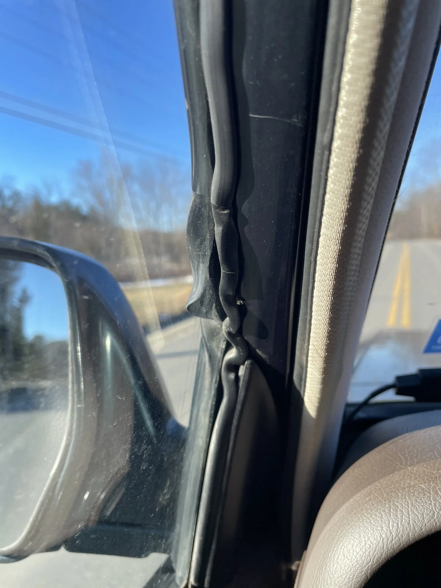

So I have searched around I'm not sure if these are still available from Toyota or if there are aftermarket options but I'm really having a hard time trying to find gaskets for my windows. Here is a picture of what I mean. Any help would be greatly appreciated. Thank you in advance!

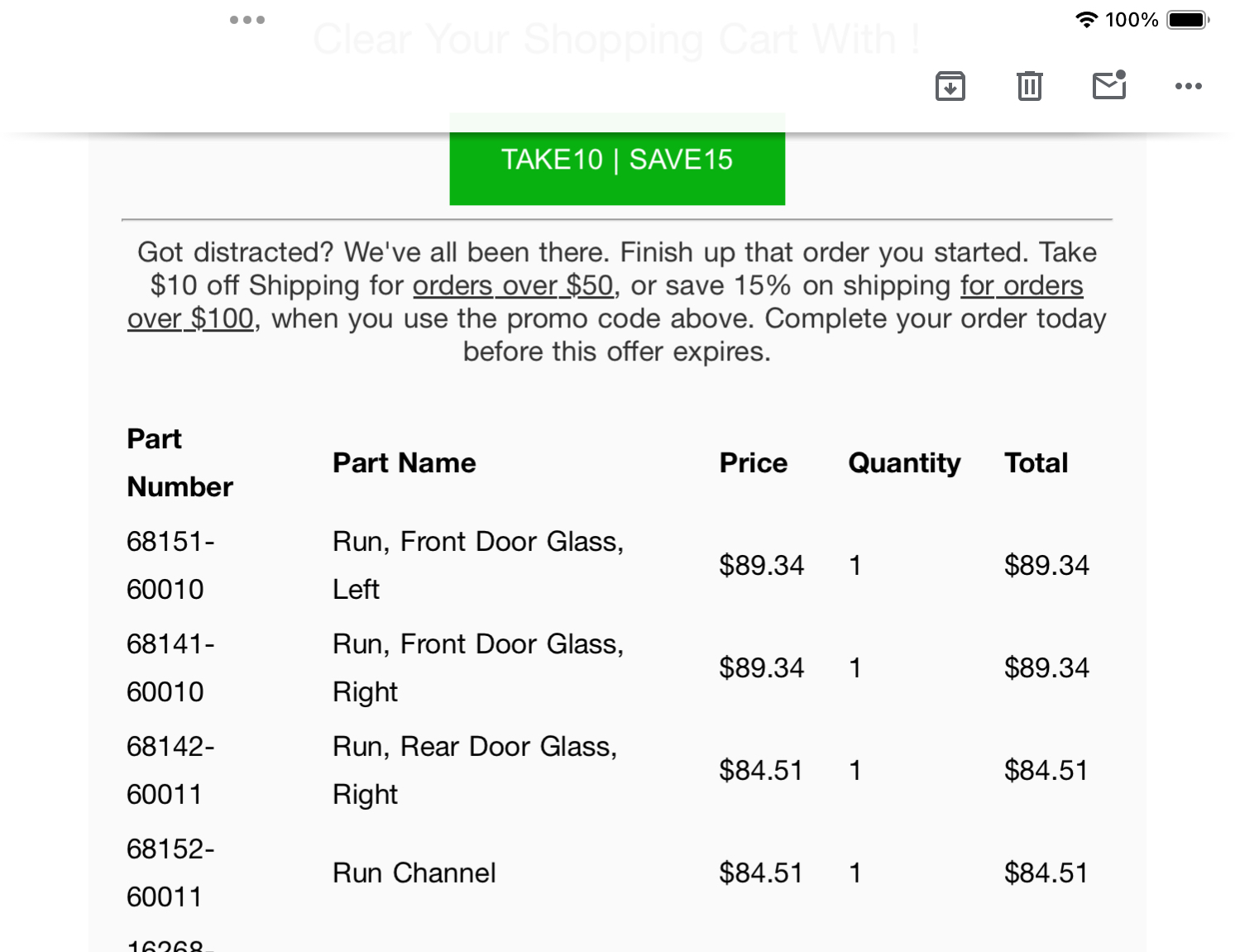

Are new folks on MUD just lazy? Do you not know how to search for parts or make calls to dealerships or use a search engine for the things you need?
This topic has come up several times over the last several month on this forum and I have posted this image several times!

Like I said I did search, I'm new here but I'm not new to forums. I guess the term "door run" would have netted better result if I knew to use that phrase opposed to "gaskets" and "seals" 🤷🏻‍♂️

For SEO & future-proofing, here are the part numbers (as above is in an image):
Toyota FZJ80 / FJ80 window gasket part numbers:
Front Door Glass Gasket/Run - Left (1991-1997 Toyota Land Cruiser)
68151-60010
Front Door Glass Gasket/Run - Right (1991-1997 Toyota Land Cruiser)
68141-60010
Rear Door Glass Gasket/Run - Left (1991-1997 Toyota Land Cruiser)
68152-60011
Rear Door Glass Gasket/Run - Right (1991-1997 Toyota Land Cruiser)
68142-60011
